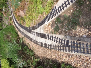

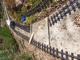

Hello Mike,
The jury is still out if I'm honest. Despite the recent hot weather nothing seems to have moved, my problems seem to have been in cold weather. Despite the laws of physics I seemed to get buckles in the track during Winter last year! I can't honestly say it was the Filcris structure that moved, some of the pins holding the track to it tore out in the worst locations so the track seems to have moved rather than the Filcris. All my Filcris is buried, even on the embankment sections and there is a layer of geotextile on top, help down on either side by pea gravel edges to form drainage. The track is pinned to the Filcris through this geotextile. There is no doubt that the Filcris has settled, both vertically and horizontally, in places. The amounts are small and it's entirely down to the ground it is set it. I used 1'-6" Filcris uprights to carry the two lonigtudinal runners (one either side of the uprights), I ought to have gone for 2'-0" ones really, so much of the garden was reprofiled before the railways construiction began. Some of the stakes are probably sitting completely in fill material that has subsequently settled. I thought I had avoided this but the up heaval was piecemeal and levels were revised as work proceeded to avoid having too much or too little soil in the garden. I got a bit lost!! All in all I remain very satisfied with the Filcris.
Construction of the line has been on pause for rather longer than I would have liked, for a number of reasons. Things are starting to move again now and a couple more turnouts are under construction, these are required to allow the next steps to take place. Before I can start outside again though I'm going to have to recover the railway from beneath the undergrowth. Creeping thymes are ideal plants for 16mm scale but they don't half live up to their names! There has also been a takeover bid by the lavendar but it's such a haven for bees and butterflies that I can't bring myself to hack it back until it's completely finished flowering. I must find a way to hold it back next year!
bikermike
Re: The Charnwood Forest Light Railway
Thanks.
I shall do some more headscratching. Good luck with the works!
- GTB
- Posts: 1712
- Location: Australia
It's all relative, but I guess you don't want a lecture on frames of reference.......Soar Valley Light wrote: Wed Aug 07, 2019 7:30 pm Despite the laws of physics I seemed to get buckles in the track during Winter last year! I can't honestly say it was the Filcris structure that moved, some of the pins holding the track to it tore out in the worst locations so the track seems to have moved rather than the Filcris.
The high co-efficient of thermal expansion of Filcris works in both directions. Assuming you laid the track in warm weather, when the weather turned cold the Filcris contracted more than the metal rail did.
The result for all practical purposes is the same as we expect to see in hot weather with rails expanding more than a concrete or wood base.
Either way, the rail ends up longer than the track support structure and has to go somewhere.

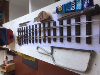

I wasn't surprised that it's nine months since my last post. Progress slowed to a complete standstill at the back end of last year. I needed to get a coupe of turnouts built to move forwards. The idea was to crack on with them on a day when the weather was too bad to do anything else. The day never seemed to come though - which is odd, because I was blaming the state of the allotment at the start of spring on the fact that it had been too wet to do anything!
Any road up (as we say in my native Mansfield), a wet Sunday a couple of weeks ago saw me make a start on the second turnout I needed. Progress slowed when the weather picked up but over the last two weekends I've had chance to move the construction on and I completed it this morning. I was spurred on by having a steam up on Friday afternoon after work, something I don't think I've done for nearly two years! It was reading some of the topics on here that really gave me the encouragement I think - that and the gorgeous weather! This was just before completion. Once I'd got the check rails fitted and a tie bar soldered on I was outside to see how the geometry was going to look. This section of the work was to complete the continuous run capability of the railway. Not something I intend to use in normal operations but handy for someone like me who has little experience of live steam and wants to 'get the feel' for running locos. It was blooming hot out there today but I sweated my way up to lunch by getting a suitable alignment for the turnouts. I got it pinned down before sausage rolls intervened. This piece of track runs from the crossing loop at the intermediate station of Woodhouse Eaves and the end of the run round loop at the terminal station of Shepshed. It also includes the loco release turnout turnout at Shepshed. The loop points at the other end have been there for some time but were only run on for the first time last Friday and have served no function so far. Just a short length of plain line in the platform road had been layed with the points but today I was able to close up the gap between the loco release points and this 'head of steel' in the platform line.
I stood back to admire the work and was pleased with what I saw. The back garden blackbird (we have a front garden one as well!) seemed impressed too judging by the time he spent watching me from the fence above my head, next doors apple tree and our copper chimney - maybe he was just bemused. I was going to leave it at that and get off down the allotment but the short gap in the loop at Woodhouse Eaves was just begging to be closed up. Like shepshed, there had been a (longer) length of plain line in the loop here for over two years, serving no purpose up until now. The first turnout layed today turns you off the loop there towards the end of the run-round at Shepshed. Going straight ahead leads along the loop at Woodhouse Eaves to the other loop points, which were the first points I layed. That must be well over three years ago now! I couldn't resist and a frenzy of rail cutting and sleeper sliding commenced. About an hour later - job done. I wasn't convinced I hadn't made a dogs dinner out of the alignment in this last bit but I've walked past it several times since and it's growing on me. The blackbird raised no objections at any rate! See what you think.... On the opposite side of Charnwood is one of my favourite bits of the railway's surroundings and when in flower at this time of year it's at it's best. The alpines are a lovely red and the violets have poked through amongst them this year. A little further along the line I'm still having problems with the Jackdaws, who seem to have the strength of Samson. I mentioned before that I've used some standard gauge ballast as retaining stones for the pea gravel. This gravel cess runs alongside the railway throughout it's length but on the higher and narrower embankments in this location the retention is necessary to prevent the pea gravel running away. These are at the larger end of standard gauge ballast dimensions and are not light. However, the Jackdaws seem to have no problem in hurling them down the embankment. You can just make some of them out at the toe, next to the blue bricks. I'm going to have to resort to some cement I think - although they are clever birds and I expect they will turn up with jigger picks to move them again!
The problems previously described with track alignment haven't gone away, although they have reduced in magnitude, unfortunately there are one or two new sites now though. I've increased the track fixity in places by replacing 1/2" pins with 3/8" screws of thicker diameter, we'll see how that holds through the summer. A lot of the ground on which the railway stands was built up. The Filcriss legs were mainly in solid ground but the track bed was in the air for a lot of the length of the railway and the ground was built up around it. There is no doubt that this fill material has settled over the last twenty four months, by over an inch in places. This probably means that the lateral restraint hasn't been as stiff as I'd expected and may explain some of the movement I've experienced. Friday proved that it's not been detrimental to running though. What did catch me out was the vegetation. Having not run for over 18 months meant that I needed to do a bit of trimming before I started running. I've been trying to keep on top of it and I've had to reclaim the track from under the creeping Thymes about every six months. What I had forgotten was how wide in the beam a 16mm NG loco is! I had three derailments on the first run due to the buffer bean fouling vegetation that hurled the leading wheelset into the ballast! As I said earlier, I am still learning!
Progress is now paused again by the need for turnout construction, this time one leading from the loco release road at Shepshed into the quarry sidings. That's not quite true, because one day last week I loose layed the loop points for the Leicester terminus and dropped a couple of lengths of plain line in off the back, but this is all flapping about loose pending the clearance of wild violets from the track bed, which I don't want to do until they've finished flowering. This will enable me to fasten all this down and drop a couple more lengths on to take me onto the area designated for the steaming bay, but yet more turnouts are required to progress beyond this. However, I've got the bug again at the moment and a new supply of material arrived from Cliff Barker last week so maybe I can move things on a bit this summer. Hopefully it won't be another nine months before my next post - but don't hold you breath!

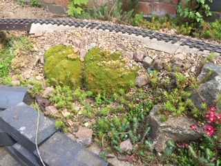

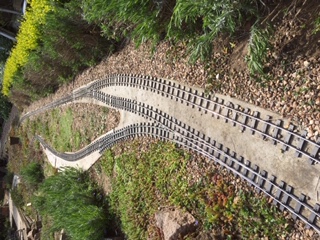

Thanks for the encouragement Grant. It had good effect as I managed to produce another turnout over the weekend, and not just a straightforward one either, it was similar flexure curve out of curve, so needed a bit of thinking about.
It took until yesterday to find the opportunity to light an engine up to test the new trackwork (making 200% more steamings than last year!). The loco got round OK but I found the check blocks on one of the new crossing noses were a little high causing the flanges to bump over them. I need to get back out there with a needle file to take them down a touch.
I was amazed how much the vegetation had grown in the week since the last run - that did fetch the loco off, on more than one occasion! I also need to get out there and do some really serious cutting back - and then keep on top of it. The loco I'm using is a Ragleth with a body kit that includes a tender. The loco lumps it's way over most things, it's usually the tender that gets 'legged up' and lands on 'Olde England'. However, on the first run yesterday the loco itself came to grief in a spot where I new the vegetation was close but definitely clear. On investigating I discovered two things. First the buffer beam had got warm - to the point of being finger burning hot! secondly, it was a dirty great round pebble, tucked under the vegetation, that the loco buffer beam had rolled round into the motion, with inevitable results. I know exactly who to blame for that, it's those super strength Jackdaws again!!!
