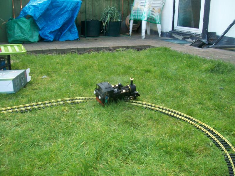

A cautionary note to the boy racers out there! She was not happy to be sped off the rails...

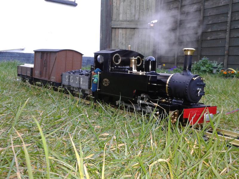

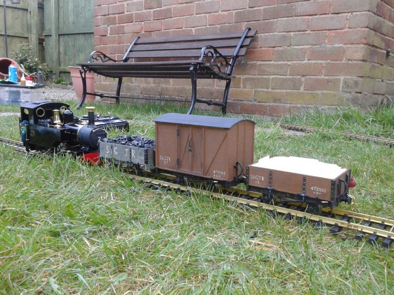

Anyway, she's still plodding along the grumpy little dear she is and here she is with some of my newly built wagons.
It's getting there!
