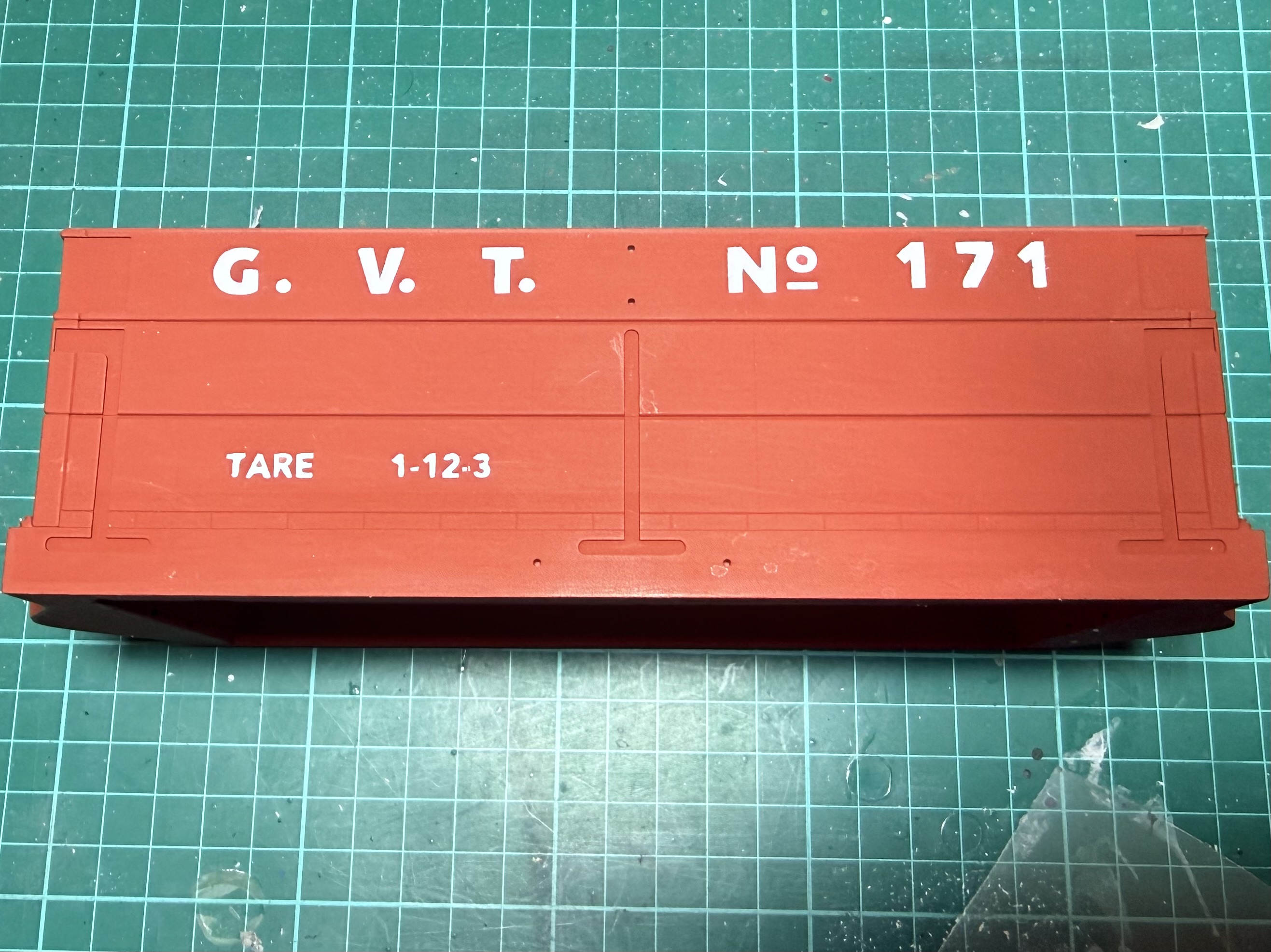

Here’s a photo of my current project, a GVT 4 ton granite wagon in 1/16th scale. The lettering has been painted using a Cricut cut mask in Washi sheet and sprayed white. I wasn’t sure how the tare would come out but it perfectly acceptable. I couldn’t get the centres of the o’s a’s and r’s to stick, so they are painted back in with a brush.
The tare being on the left rather than the right is my mistake. I copied the drawing rather than checking photo references 🙄
As Lonsdaler says, low tack masking tape is another option, the advantage of the Washi sheets is they come in A4 size, so the whole side of the wagon is done in a single mask, and the sheet is on a backing that can then be stuck down to a Cricut mat for use in the Maker cutter.

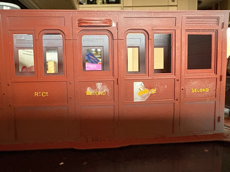

I've been doing some experimenting to find the best way of lettering my F&B coaches. To cut a long story, I've unfortunately given up on adding dropped shadows to letters that are only 3.5mm high, or less, and they will have to be plain yellow.
I've tried several ways of producing the plain yellow letters: Using the Cricut Joy to cut the individual letters from vinyl, weeding out the letters and using the vinyl as a template for hand painting, and using the Washi sheet to produce templates for hand painting like Durley does with his vehicles.
So far, cutting the individual vinyl letters and applying with transfer tape is giving me the best results, because, from the RHS in this picture:
1) Using vinyl for the mask, the vinyl leaves a very sticky residue on the panel when it's peeled off.
2) & 3) Using Washi as a mask, works Ok, but sticks to the surface too fiercely and leaves horrible shredded backing paper stuck on.
4) (LHS) Individual letters, cut from vinyl and transferred with transfer tape.
For reference, the R and C are 4.5mm high and the underlines are 0.35mm deep.
...and in case anyone wondered, this was a failed coach body print, quickly sprayed up to experiment on!
Re: Using a Cricut Joy m/c to produce custom vinyl lining.
Posted: Sat Feb 28, 2026 11:02 am
by Lonsdaler
The final result looks good, and maybe it's the lighting, but that looks like a dropped shadow effect.🤷‍♂️
