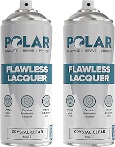

Woodleigh do stress in their instructions that if used outdoors they must be painted with a clear lacquer. I've sprayed mine with this https://www.amazon.co.uk/gp/aw/d/B08XZN ... asin_title
which is advertised as non yellowing and UV resistant. So far, so good, BUT they haven't been stood in full sunlight for any length of time
