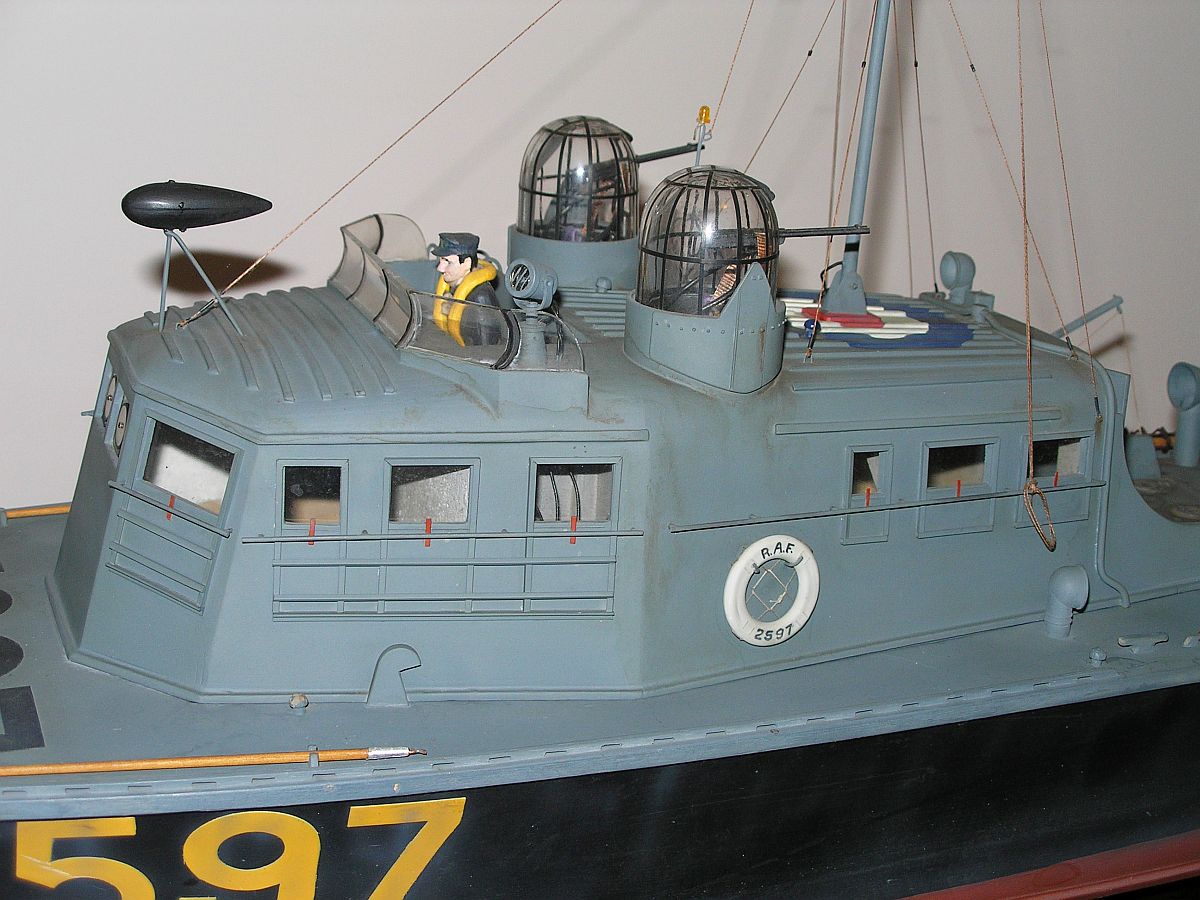

Thanks Aaron.
There's actually a pair of these turrets either side of the bridge.
Hants & Dorset 7.JPG (172.15 KiB) Viewed 53836 times
I had to make a male plug pattern then a female one to be able heat acrylic sheet(Perspex) and press it into shape. I may have done it in two halves (can't remember). Then put the frame on with thin strips of black tape and twin 303's with magazine belts of copper corrugated foil. The model even made the same rooster tail wake as the prototype only having two shafts (real ones had three Napier Sea-Lions)

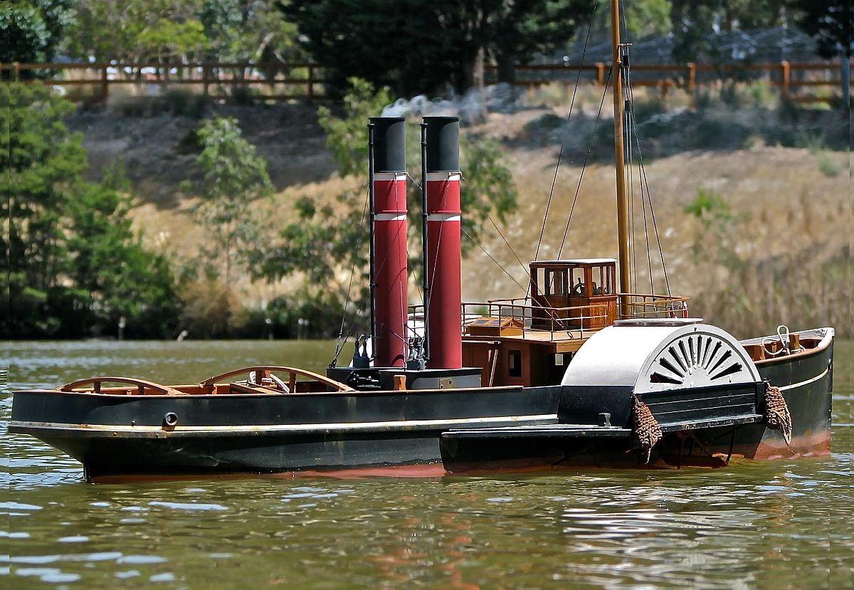

A paddle Tug based on one built for Dover the Lady Vita, and later went to the Tyne and became Lingdale. Although I never finished the deckhouses that should be on the sponsons.

A paddle steamer was on my 'to do' list until life got in the way and modelling of any kind dropped off my radar. That looks beautifully detailed, even if missing some superstructure. And your torpedo boat is also a brilliant piece of work. Lacking your skills, with the machine gun turrets I would have resorted to finding something clear that was 'near enough'; probably a clear plastic lid off a deodorant tin or similar😅
