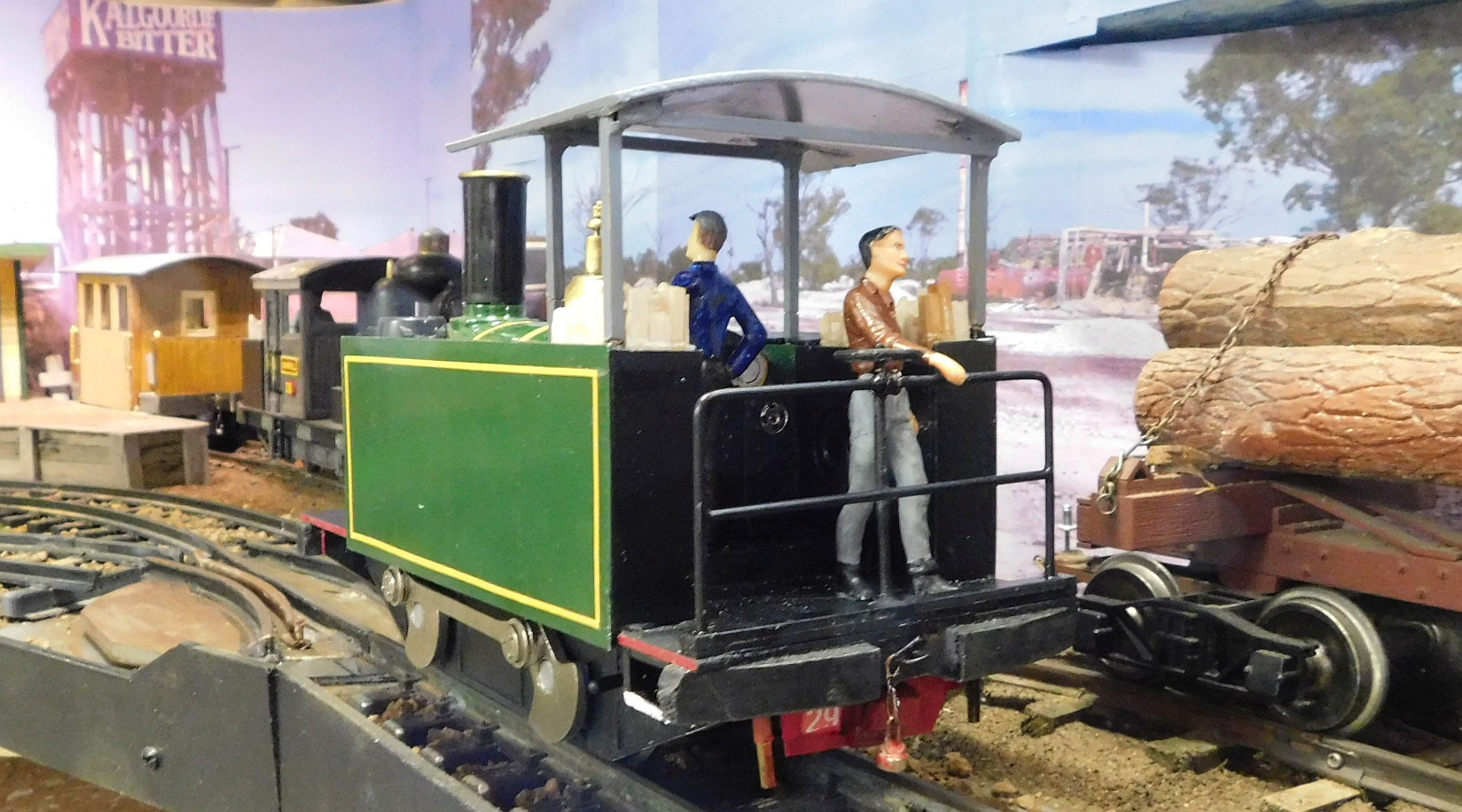

This loco is truly CURSED. After all the problems with getting everything cut, I finally have it almost complete. It just needs some numbers.
BUT as I took it for its first run outside, it stopped after 15 minutes. I finally have tracked it down to an intermittent fault in the Hobbyking transmitter. And there are none available in the store!
So I have temporarily bound it to another Tx.
It can now takes it’s place as number 29 on the Sandstone and Termite roster, as the 25th scratchbuilt loco.
So here’s a few pics on the indoor line
First a comparison of the prototype I used as a 'model' and my attempt.
real and model.jpg (305.24 KiB) Viewed 82816 times
No29 finished (1).JPG (413.16 KiB) Viewed 82816 times
No29 finished (2).JPG (395.31 KiB) Viewed 82816 times
No29 finished (3).JPG (382.82 KiB) Viewed 82816 times
No29 finished (4).JPG (400.01 KiB) Viewed 82816 times
and the video indoors and outdoors …

I think you've perfectly captured the prototype's character. :thumbleft:
Re: Building an 0-4-0 outside frame tank loco
Posted: Fri Mar 15, 2024 7:52 am
The lining certainly helps relieve the slablike nature of the side tanks. Not a modelling issue, just a feature of the prototype.
