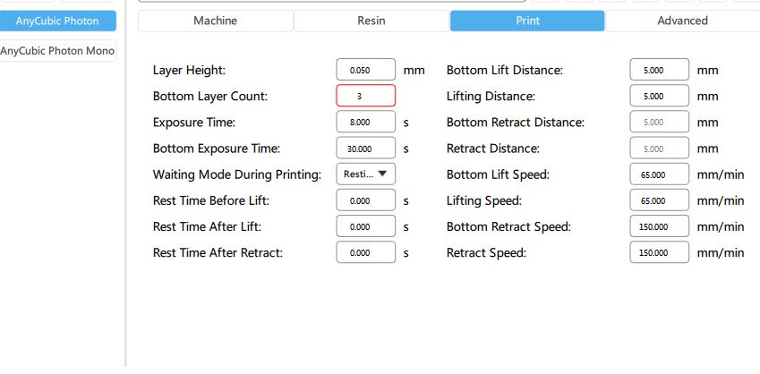

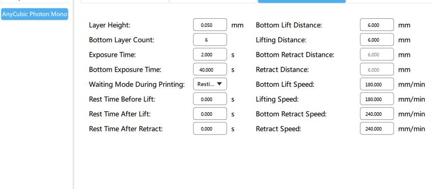

I had a look at my settings which I print any colour in and never get bad results. One is the Photon S, the other is a Photon Mono. Speed difference is massive, but both work perfectly. I am surprised by how slow you had to lift away to get it to work.

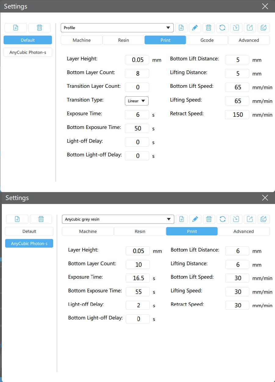

Top are the default settings that Chitubox decided on when I first got my Photon-S and won't print my bolts on the sheet.
Bottom are the settings I got from somebody on a Photon forum, that has worked. That isn't to say that there isn't something somewhere in between

Richard could be right about me getting confused between mm/sec and mm/min though! :oops:
