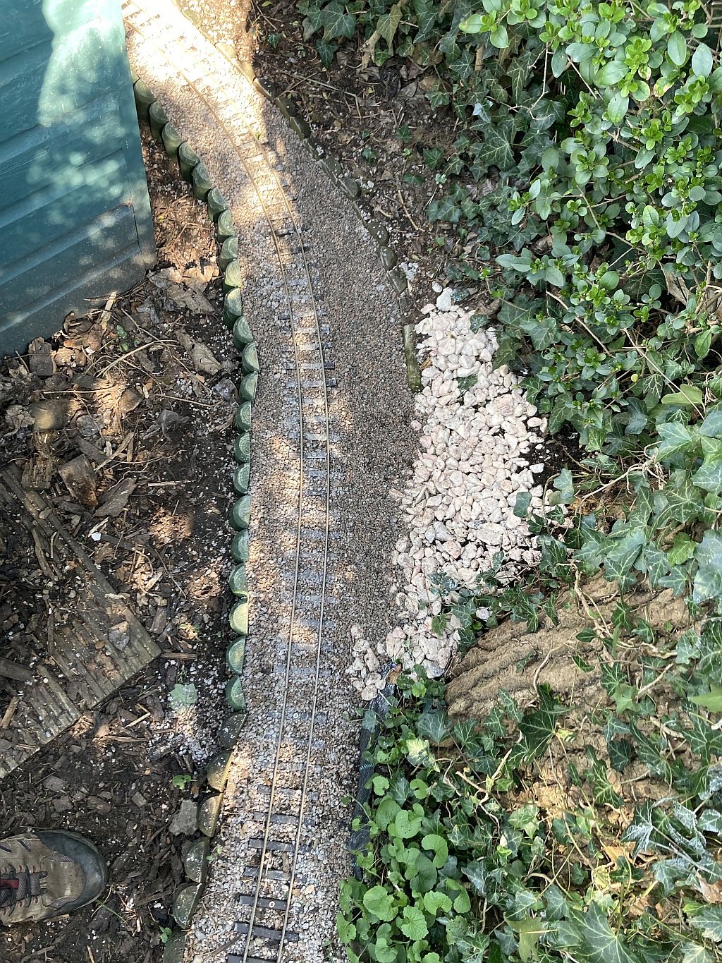

More about the track realignment. As the railway and the range of motive power I have acquired has developed its has become apparent that here and there some changes could be made to facilitate easier running, particularly for manual control steam engines.
The first change I've made is where the line runs behind the smaller shed by the hedge. The last part of the curve is perhaps a little too tight and there is a little bit of a gradient as well which doesn't help. Also it is right next to a large tree trunk and the slow growth of it over the last 6 or 7 years since I first laid the track has reduced clearance, so it really needed improving. This section of line also seems prone to having animals digging, pecking etc and the ballast keeps getting covered in debris from that and leaves and twigs.
So I've slewed the track slightly, so the curve blends more into the straight section. this has allowed an increased radius in the tighter part of the curve.
Once I had the track in place, i was able to carefully adjust the levels before final ballasting.
It looks a lot better, and so far seems to be easing the passage of trains (although I've only run a small number of trains on it yet!). I suspect I won't solve the issue of debris accumulating as this corner is a trap for anything like that.
