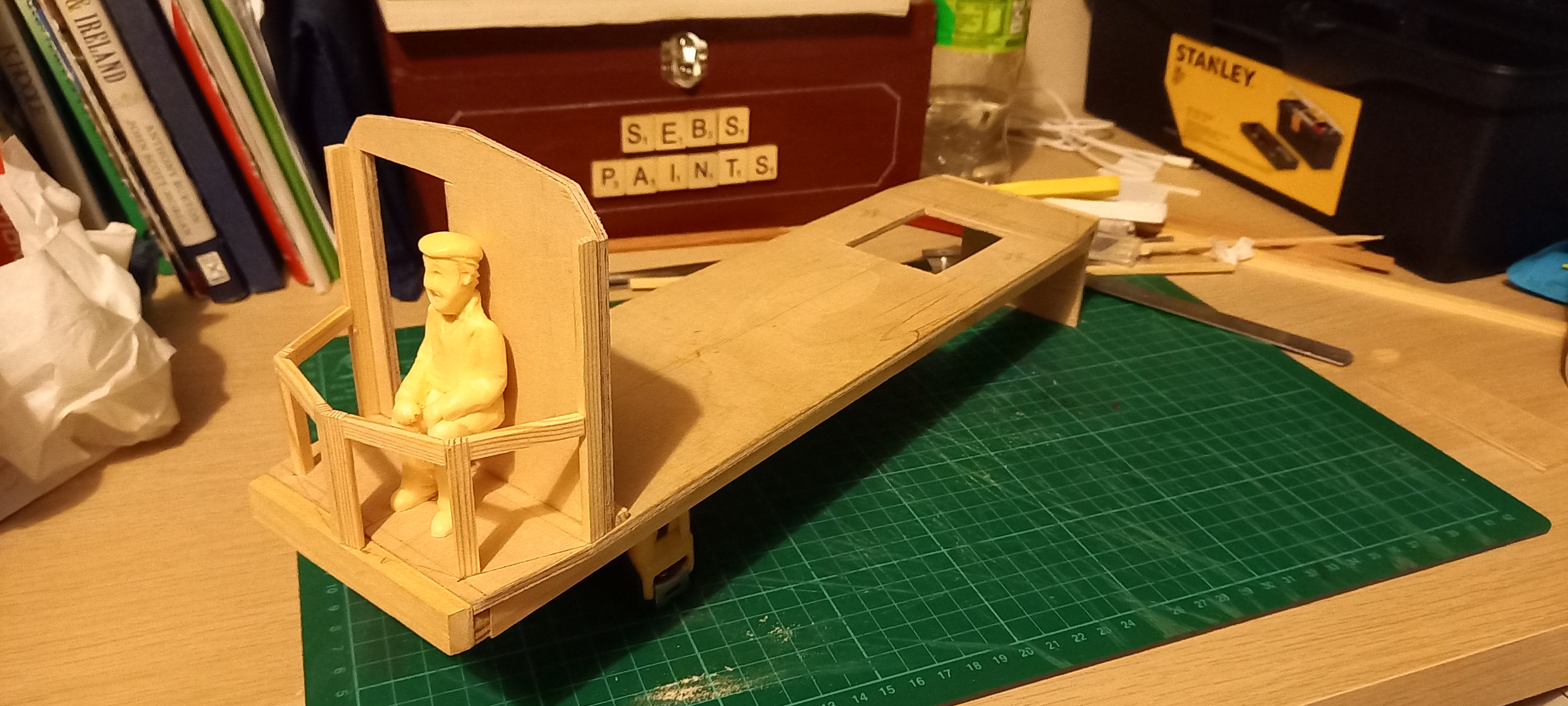

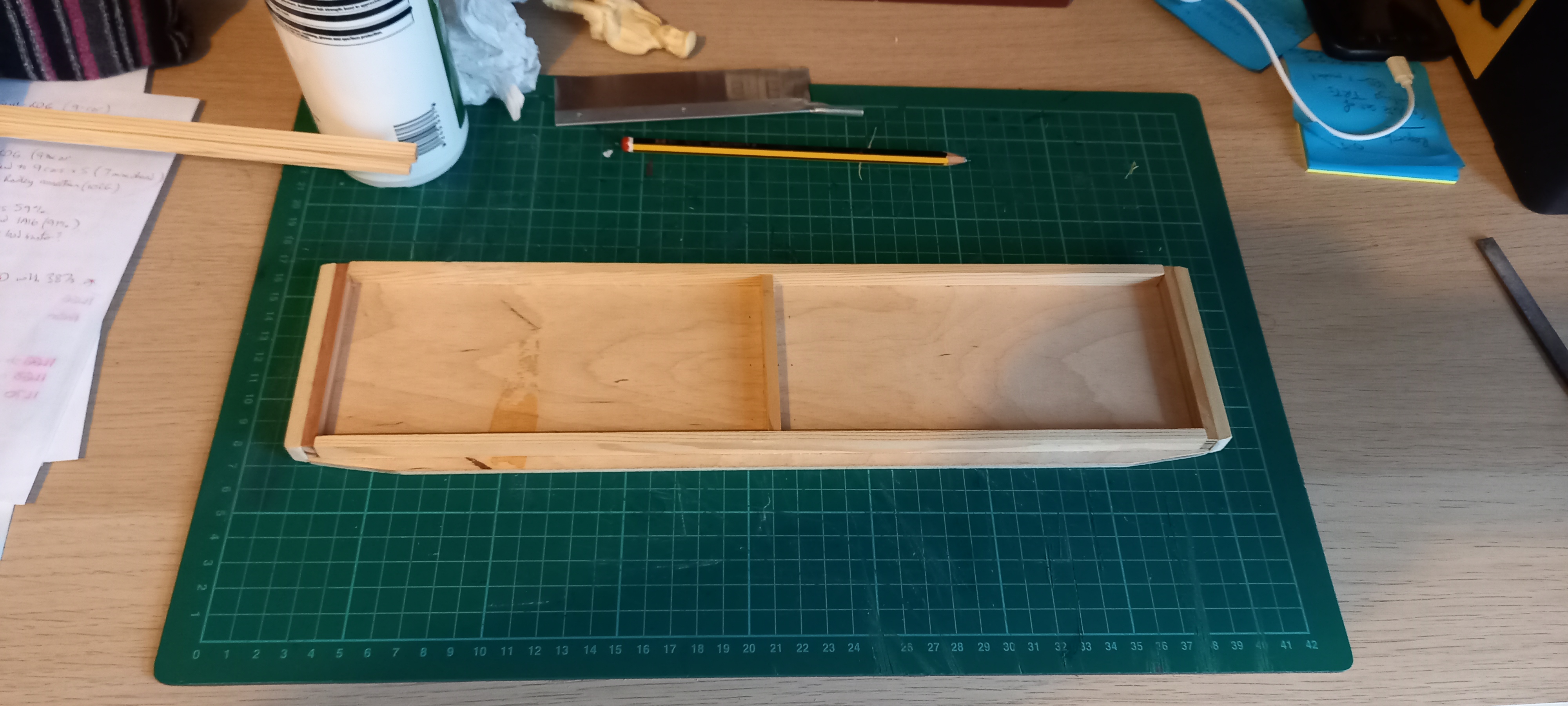

Posted: Wed Jul 05, 2023 11:32 pm
by Seb_N&BLR
A fairly brief project update after a few weeks of occasional bursts of activity, in my usual style. I’ve cut the plywood chassis and attached solebars, headstocks and buffer beams. After some careful measurement of the power bogie and the required coupler heights I’ve concluded that the bogie frames will sit entirely beneath the chassis with only the central pivot and motor required to penetrate the vehicle floor, which rather simplified the size of the hole required. There is enough rotational space for the bogie to turn through my tightest pointwork, about 2ft6 radius.
I’ve also cut one of the cab rear walls out of ply and it is now glued in place along with the first part of the cab structure. The (as yet unpainted) driver is positioned for scale comparison. It’s a rather cosy cab so the doorway to the saloon is offset rather than central - I’m trying to think how the Swindon design would be adapted to the narrow gauge rather than just reproducing a smaller version of it.
Pics:
A long long way to go yet but it’s pleasing to make initial progress.

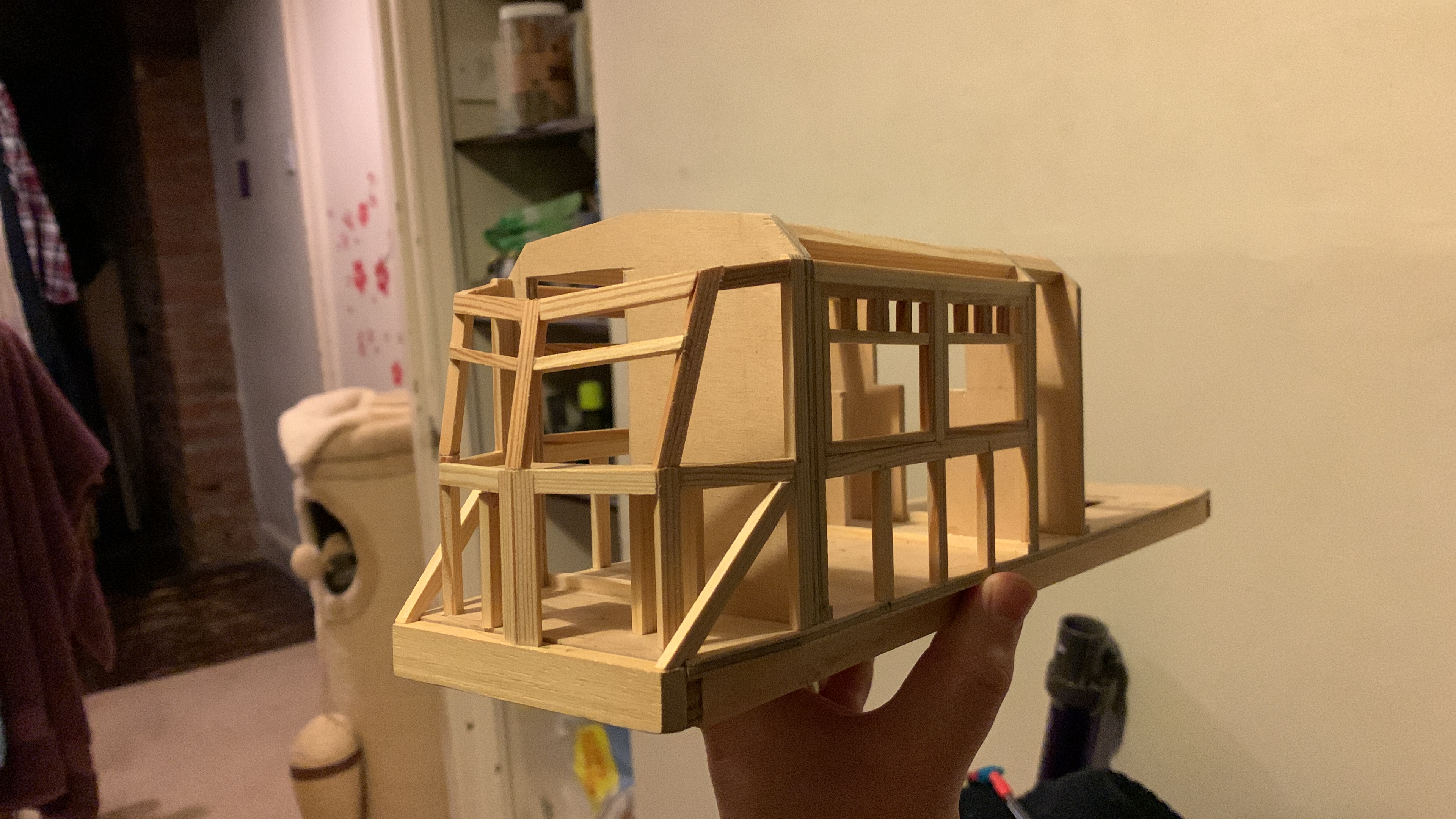

Posted: Mon Nov 06, 2023 6:01 pm
by Seb_N&BLR
After a hiatus of a few weeks due to family issues, I’ve once again pressed on with my Swindon railcar project. The frame of one cab and the main passenger saloon have been constructed and the character of the model is hopefully starting to appear. I’ve decided to clad it using 1mm ply rather than plasticard which will result in an all-wooden construction - the full size vehicles were wooden bodied clad in steel sheet similar to other GWR coaches of the period. All wooden body should make it easier to paint and achieve a consistent finish.
Some pics of it WIP:
I’ve also acquired a power chassis from Ince Loco Works which may get used for this project if I can work out a sensible way to attach & pivot it within the frames, hidden by the parcels compartment. The trailer bogie will sit beneath the passenger compartment.
