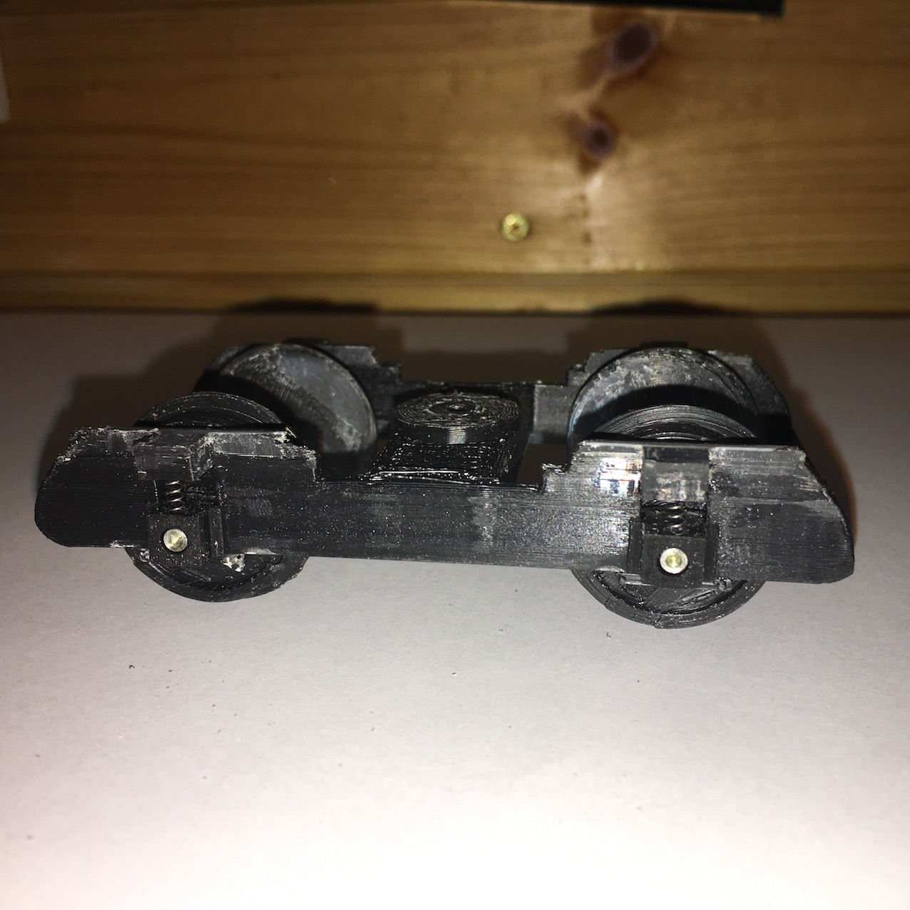

The bogies are now working.
I settled for this arrangement in the end:
You can see the spring between the axle box and the bogie. So the axle boxes move as per full size, but when fully loaded I expect the springs to bottom - and act more to keep the wheels in contact with the rail than to actually make the coach properly sprung.

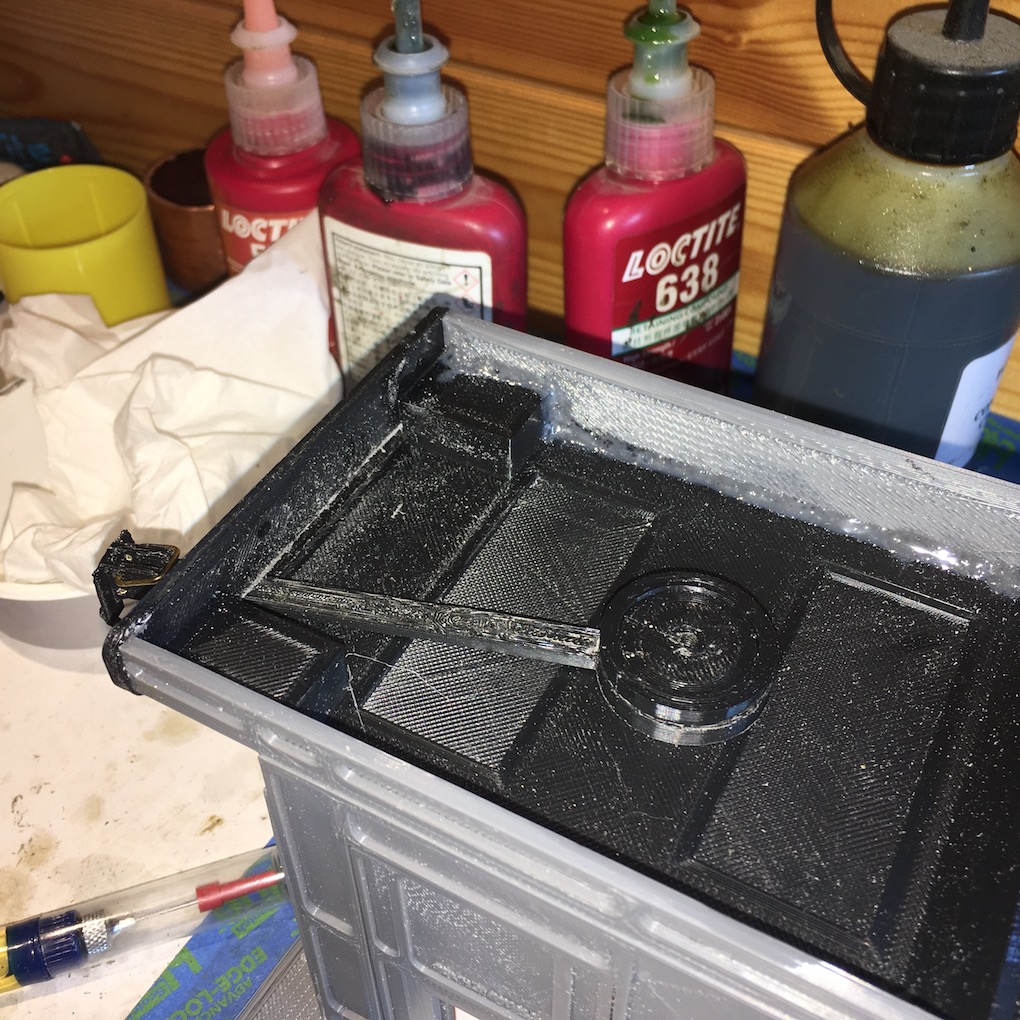

The couplings installed:
The ring is a bush to hold the coupling pivot ring up - and preventing it interfering with the bogies movement. There is a brass loop in the bottom of the coupling to take coupling hooks - so that wagons can also connect to the chopper couplings.
and the bogie fitted:
I have used a 6BA brass bolt fitted into a tapped hole in the bottom of the coach. Tapping into the ABS seems to leave the thread a bit tight, and that is helpful as it locks the bolt without resorting to lock tight. It is interesting to note how far the bogie will pivot, I think it is going to go round quite tight curves!
