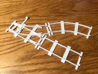

I printed out some of the Loco Remote track. I am hugely impressed with the design for this - especially the turnout. I can see that if I'm not careful, I will be printing myself a micro layout before I know it...! (In fact I've already dusted off a plan I made when I was playing with RailModeller Express...)
However, as with the Lego, the bits that are supposed to clip together, don't... It's not really a problem with the track, as a bit of filing will resolve the issue. But from a diagnostic perspective, I'm starting to think there's a pattern here, that somehow the default print settings are making things slightly larger/thicker than designed...

I have already augmented an STL file in TinkerCAD - adding to a Lego block. (This is one reason making Lego appeals to me - the ability to create new pieces, or converters - a bit like this Duplo to Brio adapter.)philipy wrote: Sat Dec 19, 2020 11:43 am I don't know anything about your Flashprint, but I'm not at all sure that a slicer can do the sort of editing that you need, to fiddle with adjusting things like Lego studs and holes. Certainly Cura can flip, multiply, move, etc and the scale function allows scaling by different amounts in the three planes, but I doubt that adjusting one small element of an stl file is possible. I think you need to go back to a CAD file to do that. I know it is possible to import stl's into Sketchup but don't know if Tinkercad can accept them.
I can definitely scale in FlashPrint, and duplicate and (I think) mirror. Maybe scaling differently in the 3 planes will resolve it? But I'm hoping there's some universal setting I can find... I've discovered "elephants footing" this morning, and read up on solutions, but on examining the prints I'm doubtful that's the problem. Think I need to keep looking...

It's not so much the modelling (and rivet counting) that interested me but the functional aspects - e.g. my prints of the Loco Remote track not clipping together as designed. It's not so much a problem in the sense of being an issue for my purposes as being a puzzle...FWLR wrote: Sun Dec 20, 2020 8:18 am That is very interesting to know Trevor thank you. Shrinkage is not worth bothering about is it, when there are such small differences in the finished part.
