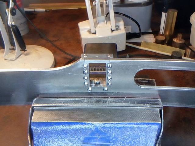

Manual CNC'ing the radii of the central slot

Got the keepers finished. Next job axle boxes

by FWLR
Nice work Dave. :thumbright:

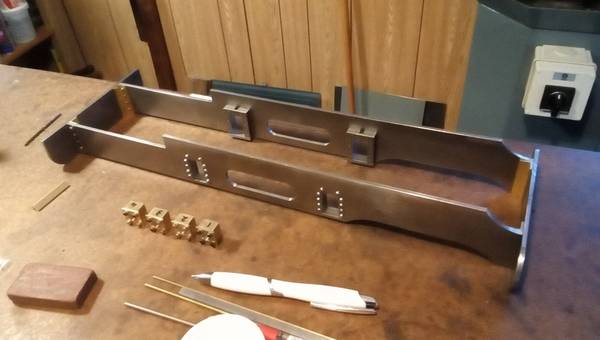

Finally the frames will stand up on their own - just. Drilling and fitting the angle pieces at the moment

by bambuko
Nice work Dave :thumbright:
I am slightly confused :scratch: , because you've said before that you are not planning to have sprung axleboxes,
but looking at your last photo (too small to be totally sure) there appear to be pockets for axlebox springs?
Any chances of close up photo and clarification from you?

by dewintondave
Thank you!
Those are slots to pass the rod from the axle box to the leaf springs above. It's all likely to be solid as the loco could be rather lively with such overhangs if it were sprung, but we will see :thumbup:
