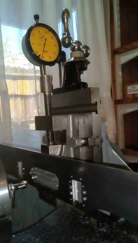

Manual CNC'ing the radii of the central slot
Best wishes,
Dave

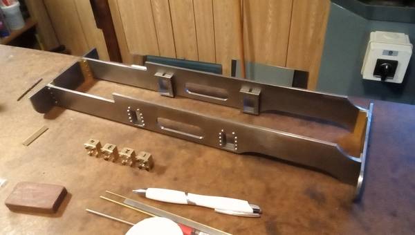

Post by dewintondave » Tue Apr 14, 2020 5:57 am
Got the keepers finished. Next job axle boxes
Best wishes,
Dave

Finally the frames will stand up on their own - just. Drilling and fitting the angle pieces at the moment
Best wishes,
Dave

I am slightly confused :scratch: , because you've said before that you are not planning to have sprung axleboxes,
but looking at your last photo (too small to be totally sure) there appear to be pockets for axlebox springs?
Any chances of close up photo and clarification from you?
dewintondave
Posts: 697
Location: New Zealand
Re: Charles - Penrhyn Mainline Hunslet
Post by dewintondave » Mon Apr 27, 2020 12:01 am
Thank you!
Those are slots to pass the rod from the axle box to the leaf springs above. It's all likely to be solid as the loco could be rather lively with such overhangs if it were sprung, but we will see :thumbup:
