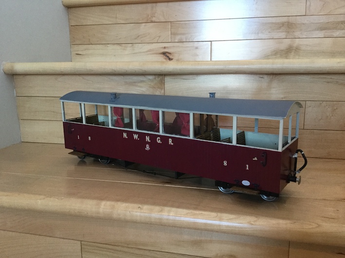

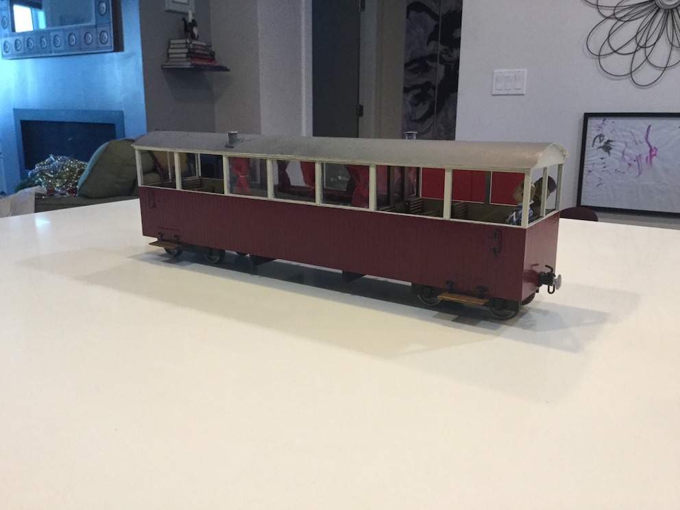

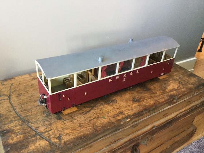

I've managed to finish a couple of the vehicles I've been trying to improve a bit. I'm quite pleased at how they've turned out.
I mentioned before the "Gladstone" coach, which I finished in a plain varnished-wood scheme about five or six years ago, and have recently repainted to look like the real NWNGR "Gladstone car" which I now think looks nicer. I've done it in its "as preserved" condition, although I like the lantern chimneys so I left them on, so it's a bit of a combination of its preserved appearance and how the coach is described as looking in its early days. It's not a nice as it would have been if I had built it like this in the first place, because with the masking and repainting I've got the windows a bit mucky, and some of the trim around the balcony windows is damaged because of an attempt I made to remove the roof- it's glued down well enough that it pulled the coach apart when I tried to remove it. Anyway, I'm actually quite pleased with it. Some improvements to the original IP Engineering kit I've made: I've removed the bracing/truss details from the IP kit and replaced the wood parts with more realistic longitudinal timbers and metal truss rods. The wooden "truss rods" were extremely easy to break, and an examination of old photos shows that the timbers aren't just posts, they go all the way athwartship. I made dummy turnbuckles out of some nuts and a bit of aluminium tube. I replaced the white metal door handles with some brass ones from Brandbright, and fitted Brandbright vacuum-brake hoses. The decals come from IP engineering, and the little coat of arms decal is on a plate I made from a bit of card. The interior was already made when I built the coach originally, (thank goodness because the roof won't come off) and features a blue carpet, patterned seat-cushions and red curtains. Notwithstanding the slightly mucky windows I am quite well pleased with how it looks.
The next thing I've completed is my "Brandbright" coach. I mostly finished this several years ago, but was unable to decide on a way to finish the roof. So it stayed unfinished for quite a long time. This week I decided to try something a bit unconventional, but it's worked quite well. I have a collection of coloured tissue paper that I use for model aeroplanes. I had some black tissue that I use for details on the models. It occurred to me that perhaps a doped-on coating of black tissue might resemble tarred linen. So I coated the roof with watered-down PVA, and sprayed water on a piece of tissue, then carefully smoothed it into the PVA. Once dried, I gave it a coating of model-aeroplane Nitrate dope. It's dried into a pretty decent representation of black roofing material, I think, and is water-resistant. I stuck on some lamp chimneys from IP engineering and some vacuum hoses, and now this coach is finished as well.
