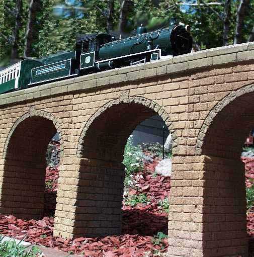

Now we get to the bridge that I am most proud of: Itβs a βstoneβ viaduct, with 11 arches, carved from Hebel lightweight concrete. Hebel comes in 24β x 8β x 8β blocks (Oops, Iβve slipped into Imperial). So obviously, each arch piece could be no more than 24β. I was able to use 1.75m radius for the track. But because I needed a width of 180mm for the track plus vehicle overhang, I could only make each arch segment 450mm long. The 150mm cut off the end was used for the piers. As shown below, I had to cut a small triangular piece off each end and then cut the 1.5m radius curve in the inside and outside of the curve.
Then I didnβt have enough βdepthβ in the 200mm high block to use a circular arch, so I used an elliptical one. And the βradiusβ of the ellipse is different for the front and back of the arch, and also from the arches on the straight portions. Suitable templates made it easier. Having marked out the arches, I used a long 1/4β masonary drill to drill many holes around the markings from back and front at the correct angle! and then gently use a saw to cut right through. Then an angle grinder and rasp, to smooth the arch out. My backyard was covered in white dust when I had finished. Make sure you wear a mask! Then it was just BORING scribbing the stone.
I used βproperβ (expensive) Hebel cement to glue the arches and piers together and used the semi-circular hunks from the removed arch as buried foundations. Waste not, want not. The parapets are cut separately and hebel-glued on. Having finished all that, I found I had created a perfect Roman Aqueduct - it held water nicely. So I had to drill oblique holes from the track bed out the side to let the water out.
The Hebel is coloured using various cement oxides mixed in water and brushed on.
I then put down some ballast in the βchannelβ and laid the track. The parapet is low enough that most vehicles with large overhang are higher than it anyhow.

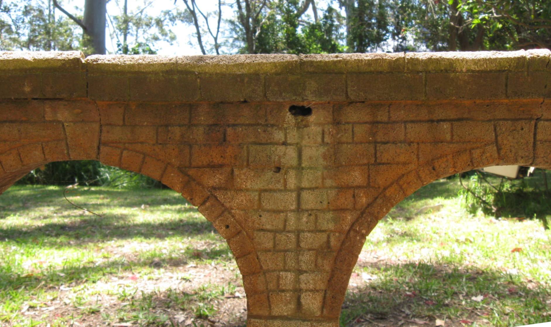

After a few years, every arch had cracked. There is only about 3cm thickness from the top of the arch, but interestingly, the cracks never appeared at the thinnest, top of the arch β always a bit away. Like this:
It hasnβt affected the strength at all (itβs still standing!). I can only assume I should have used more solid foundations. Anyhow, to add some detail to the scene, I added some work scaffold at this worst cracking. The scaffolding is bamboo skewers and heat-shrink tubing.
One last picture, (because Iβm proud of it, and itβs coming up to its 20th birthday.)

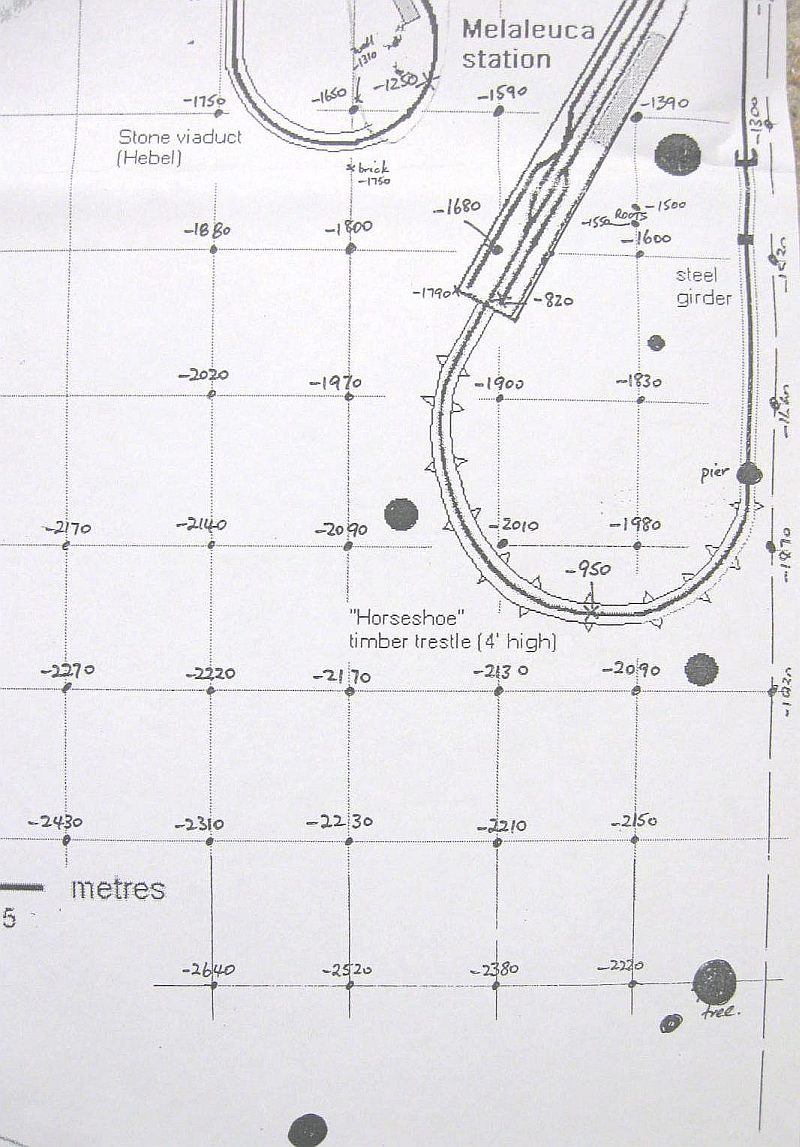

Just as an aside here. This pic shows how I surveyed my yard for constructing the GR. I put pegs in the ground at 2m grid and measured their heights from a datum using just a spirit level, a 2m length of wood and lots of pieces of wood of different thickness. The highest point of my track, which is inside my train room, is the datum ,so all heights show as negative. The pic shows less than a quarter of my yard.

I would be very proud of that Viaduct Greg. And so you should be too.
Itβs brilliant and nearly 20 years old now too, wow. They way you have worked out your angles and applied them to the arch and the columns is brilliant.
The scaffolding is truly inspired, never thought of putting heat-shrink on skewersβ¦
A truly superb Viaduct and worthy of the highest praiseβ¦β¦

Thanks Greg, absolutely wonderful. I do love the way the water has marked the face as it drains down from the weep holes.
I can sympathise regarding your dust, even my single arch bridge has generated dust that simply won't go away no matter how much I dampen, brush and sweep!

That's a truly inspiring viaduct Greg, and I can't help but admire your patience in constructing it so diligently. Excellent modelling

Love the scaffolding!

Greg, Just thinking, shouldn't you have some speed restriction notices around that crack & hump?

The viaduct is a superb piece of engineering and you have every reason to be proud of it, congratulations. As others have said, the scaffold is also inspiring and I am about to continue to build my ruined castle which I started years ago and then became sidetracked. The scaffold will enable me to show collapsed walls undergoing some consolidation. I can have site offices for the builders, and supplies of materials on site to complete the picture. You have inspired me, although it will be several months until the weather improves enough for anything to take shape..... thanks Greg!

Another great installment, Greg. Your viaduct is truly impressive. I especially like the way you have capitalised on cracks in the structure with the scaffolding. Nice touch.
