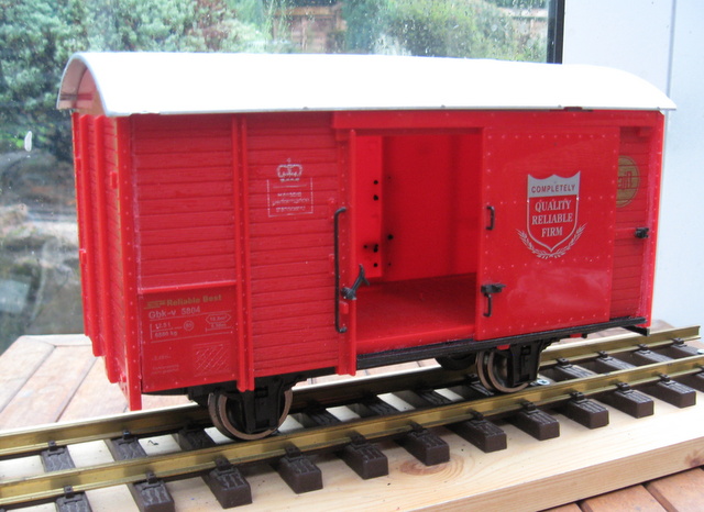

If I didn't know, never in a million years would I guess the origins of that van. Well done.
Re: Another new van for the PLR
Posted: Tue Aug 28, 2018 10:42 am
by Lonsdaler
Good stuff - the weathering is just right :thumbup:
Posted: Tue Aug 28, 2018 10:49 am
Seeing the transformation of this vehicle from its original form is a lesson in imaginative thinking. The modification and finish are both equally well done and it looks just right.
Posted: Tue Aug 28, 2018 6:34 pm
Thanks folks, you're very kind. Quite pleased with the way this turned out. These bashes are always a voyage of discovery.

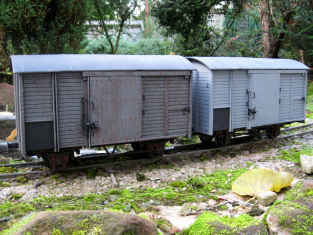

Van #2 now well under way, thanks to the kind donation of another van body from Bazzer42 of this parish.
Same technique as previously - end panels removed and ends glued back on to what remains
As the bottom slide for the doors is part of the chassis, I had to make my own from plasticard .....
...... and then use a bisected HLW chassis.
Needs a bit of tidying-up - a few gaps to be filled here and there and of course a paint-job. Oh yes, plus couplings and brake gear. Probably about three hours' work so far - but who's counting?

Second van now more or less finished. A little bit of tidying and of course weathering needed.
The HLW chassis worked out quite well - provided you don't look too closely.
Here's the new with the old.
Quite pleased with the outcome.
Many thanks to Bazzer42 for helping the PLR gain another new item of rolling stock.

I'm a big fan of weathering, and you've made a lovely job of "distressing" the first van, but I really like the contrast between the two - would you consider leaving the second in ex-works condition? I keep meaning to do it myself then get carried away with assorted grot colours...
Posted: Tue Sep 11, 2018 6:05 pm
by tom_tom_go
I agree with Andrew, maybe slightly weather the running gear but leave it pretty as a contrast.
Posted: Tue Sep 11, 2018 6:12 pm
Not sure. The PLR doesn't do 'pristine'. I might give it a little light weathering just to accentuate the planking.
