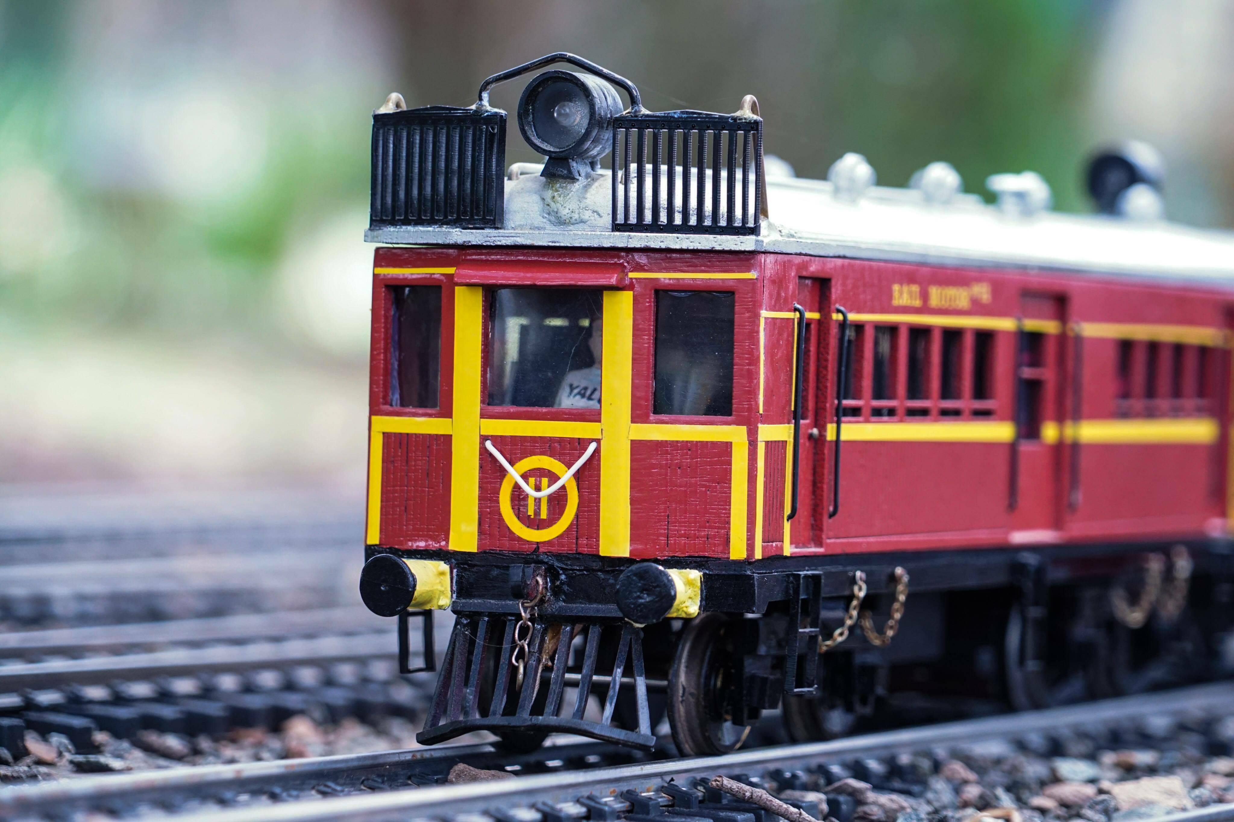

Todsmods
Re: My Winter Project - 2 Car Multiple Unit
Post by Todsmods » Wed Dec 13, 2017 7:06 pm
Looks great
Here is a picture of the Australian railcar set i designed myself
NSWGR CPH and CTH railmotor
James from Devon
Posts: 210
Joined: Mon Feb 01, 2016 6:58 pm
Location: Devon
Post by James from Devon » Sun Dec 17, 2017 5:18 pm
Todsmods wrote: Wed Dec 13, 2017 7:06 pm Looks great
Thanks and I love your railcar....what gauge is it?
Garden railways don't run on steam or electric rather wine and Jedi master level patience
