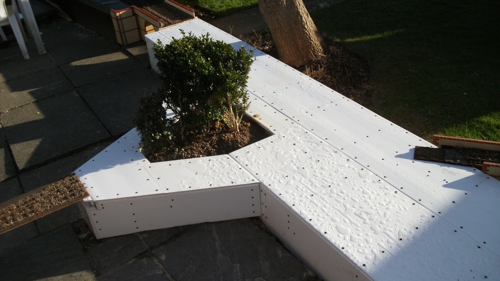

Decking completed today.

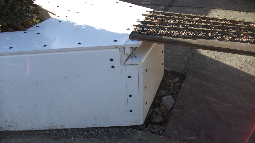

Also I was able to sort out the supports for the bridge.
DSCF4639 reduced.jpg (268.67 KiB) Viewed 14175 times
Just levelling bolts through some hacked about bits of left over plastic fixed to the underside of the bridge deck – you can’t see the captive nut.
The original drop-in bridge was quite heavy, and took up quite a bit of space in the little (plastic) shed. This has been stripped back to just the plywood deck with the (ballasted) tracks (including a point) on. I have in mind to fix a few bits to tidy this basic deck (and strengthen if thought necessary). Otherwise I will manufacture some drop-in (plastic) stoneware arches and parapets for it.

That is one very well thought out project, beautifully assembled with such a clean finished result. Short of sub-terranian upheaval I imagine it should be there for a very long time.
Re: A Plastic Decking Experiment
Posted: Sat Jan 20, 2018 11:08 am
by tom_tom_go
I agree, this has been brilliantly executed.

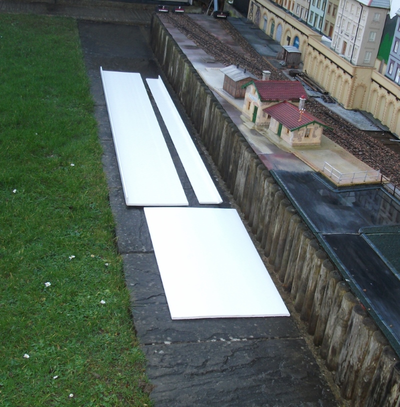

Apart from loads of bits of off-cuts, this is all that was left.
DSCF4645 resized.jpg (373.98 KiB) Viewed 14070 times
There was no 400mm wide board, just under a metre of 450mm wide board, just under 2 metres of 30cm deep fascia, and just over 2 metres of 10cm deep facia. As we started with 15 metres of 30cm deep and 30 metres of 10cm deep, I think this was quite close. We didn’t run out of the 1000 plasterboard screws, but there is about 50 left.
You could say that we ordered just enough, but it was close. We have still got some part lengths of material that we had obtained before when we were experimenting, but we didn’t have to resort to cobbling together bits to finish the job.

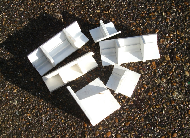

Using brackets or cleats (short lengths of the 10cm deep fascia) to connect the various sections worked well, but you had to consider the order of construction to be sure that you can avoid congestion around some joints, and of course you have got to be able to get a screwdriver in to be able to do up the screws.
This was fine on the square joints but the non-square ones needed specially fabricated cleats. Initially this was no problem apart from having to wait for the glue/solvent to go off before being able to use them. But we also found that even having carefully constructed the bracket to the measured angle, when we came to fix the joint, the angle was different. So, while the screws would pull the plastic bits together to fit the bracket, this would distort the adjacent piece, meaning trying to fix the adjacent non-square bracket was even further out of shape. Some of the non-square brackets had to be remade, and this could delay the flow of work. Rejected / not used non-square brackets/cleats.
