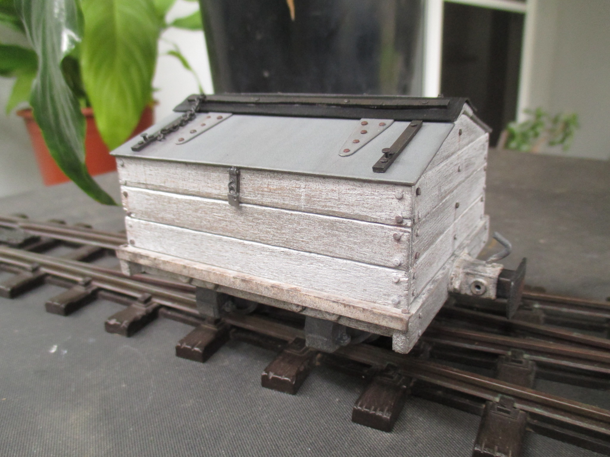

Posted: Thu Oct 05, 2023 12:23 pm
by Old Man Aaron
Well, it's only taken two years to get that momentum truck finished. As mentioned a few posts back, my intent was for this to be a former sugar cane truck, with an added molasses tank to hide the mechanism. I couldn't however figure out a tank design that would hide the mech, without looking too large and purpose-built - rather than the usual slapdash conversions you'd find in the canefields.
Instead, I've based it on a navvy toolbox wagon we have at the Woodford Railway.
Tried some new weathering techniques on this one. Weathering the planks was taken from Andrew's book - light sanding after painting.
The flexible rubber "ridge cap" that allows the top doors to open is a piece of heat shrink.
The galvanised roof/lids were done with a zinc-laden spray paint I normally use on corrugated iron buildings. Some overspray with other colours, and a dusty acrylic wash followed.
And the chipped angle iron along the sides was done by applying dark grey acrylic with a sponge, (sponge chipping) followed by carefully "dotting" the grey with a rusty brown enamel wash. This was then spread and "bled out" using a brush dampened with white spirit.

Love the toolbox momentum van Arron. The weathering is brilliant and looks so real. :thumbright:

Old Man Aaron wrote: Thu Oct 05, 2023 12:23 pm Well, it's only taken two years to get that momentum truck finished. As mentioned a few posts back, my intent was for this to be a former sugar cane truck, with an added molasses tank to hide the mechanism. I couldn't however figure out a tank design that would hide the mech, without looking too large and purpose-built - rather than the usual slapdash conversions you'd find in the canefields.
Lovely toolbox van - another demonstration of why you're up there with Peter Butler in the modelling hierarchy. Well done!
