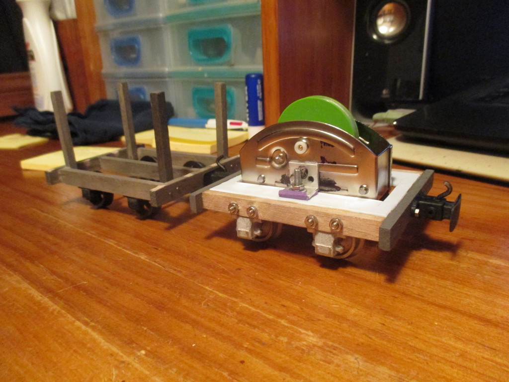

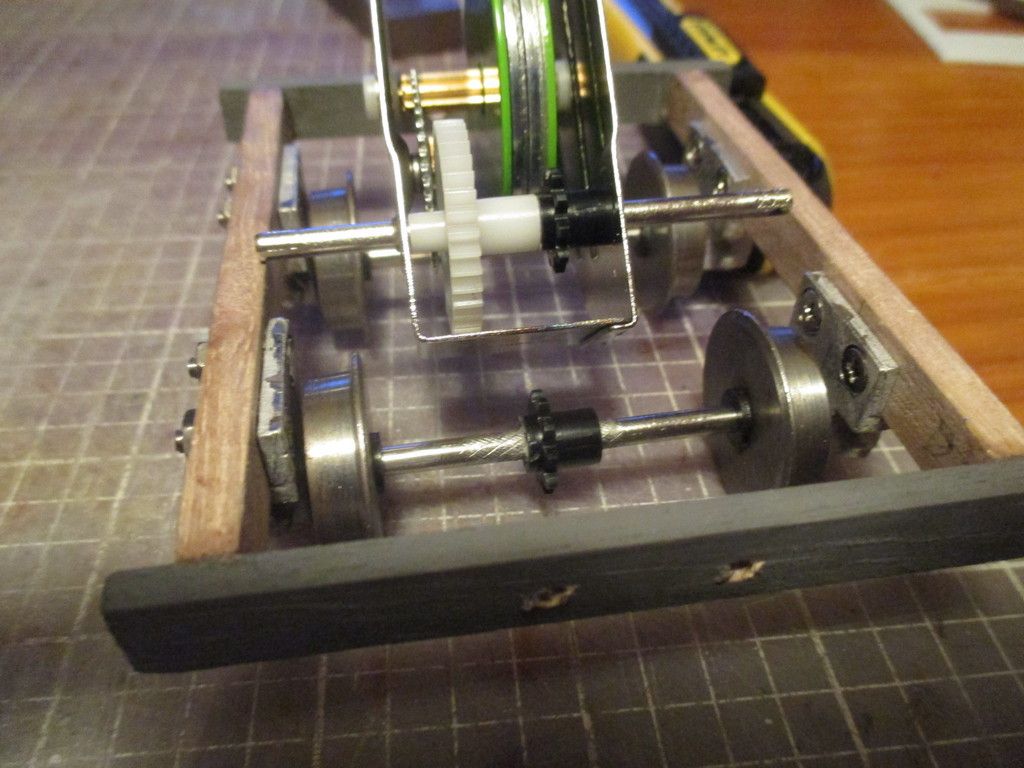

Finally got round to starting another much-needed momentum van. Stole Garethh's idea to drive via delrin chain, had to pry the mech apart to fit the sprocket. The IP Eng. axle needed a knurl on it before the β…›" sprocket would stay put - a drop of superglue was used too, though I doubt it's efficacy with delrin. Fitting the chain was a sh*t, won't be removing that one for painting..
This wagon will be a molasses tank, made to look as if it were converted from a cane truck - will look far more at home on a rake of cane trucks, than my guard's van. The tank (when I bother doing it) will be made of styrene to a boxy, riveted design, and likely fitted with captive nuts, so it's removable to allow repair or replacement of the Zecar mech if needed. Those ugly M2.5 nuts on the solebars will eventually be hidden by steps.
