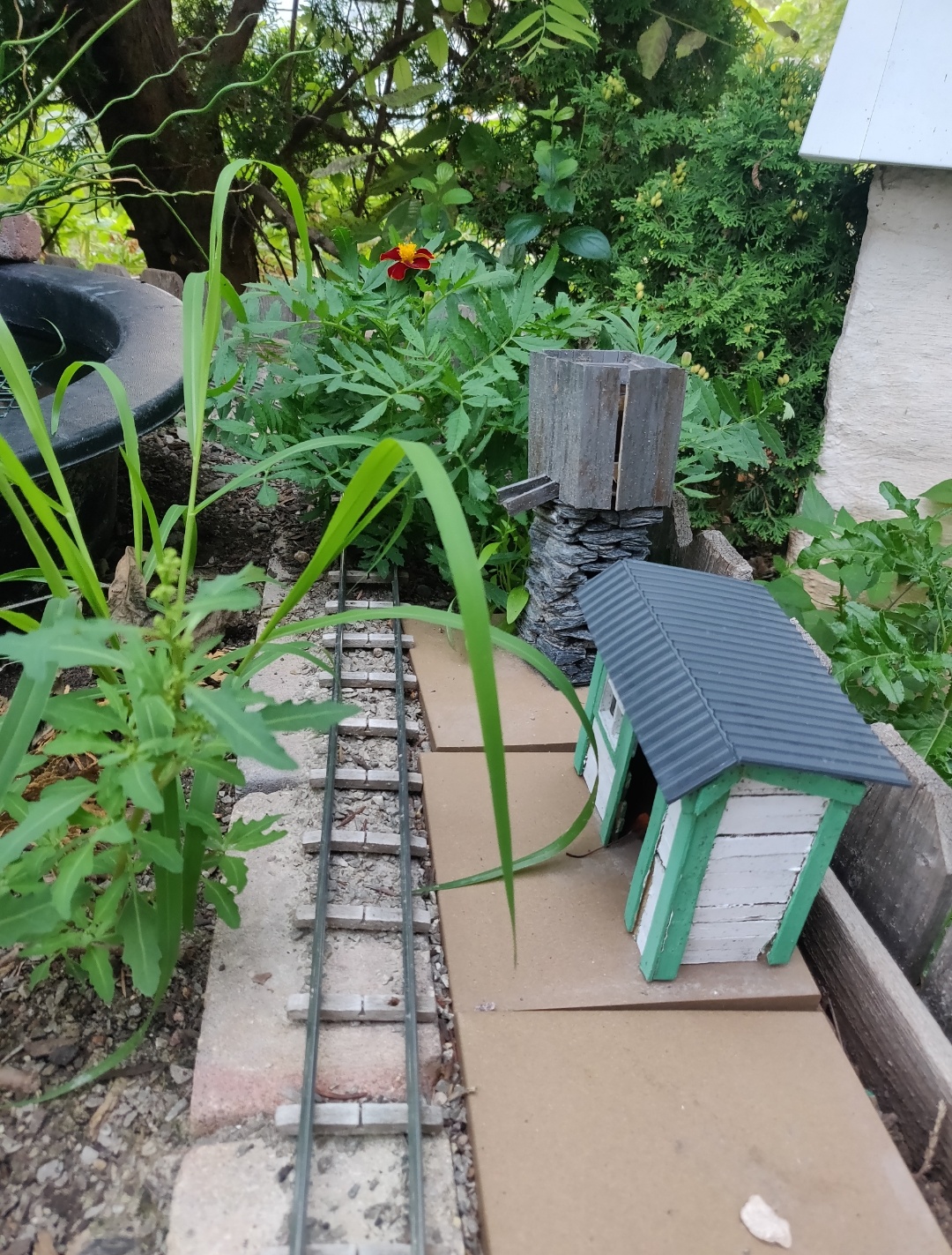

I've been finally getting back into it after letting the railway sit since June. The plants sure are happy! Most of the Irish moss is starting to spread out, and the marigolds are growing out enough to keep trains from passing the halt.
This week's projects have been clearing unwanted vegetation and leveling the bricks under the track. I keep meaning to post progress, but it's always too dark for pictures when I'm done!

Post by Andrew » Thu Aug 08, 2024 12:32 pm
Loving the light railway vibes in that picture!

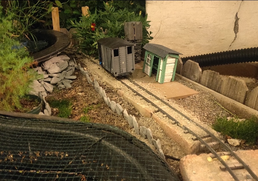

Quick evening update with some of the track fixed down and a bit of ballast in place. I tried building a slate fence and piling up some larger chunks around the upper pond; I'm relatively happy with the effect but much of it will need to be redone when I fill the ground level up to the top of the bricks. The two wooden stakes behind the marigolds are a rough mockup of the first tunnel portal.

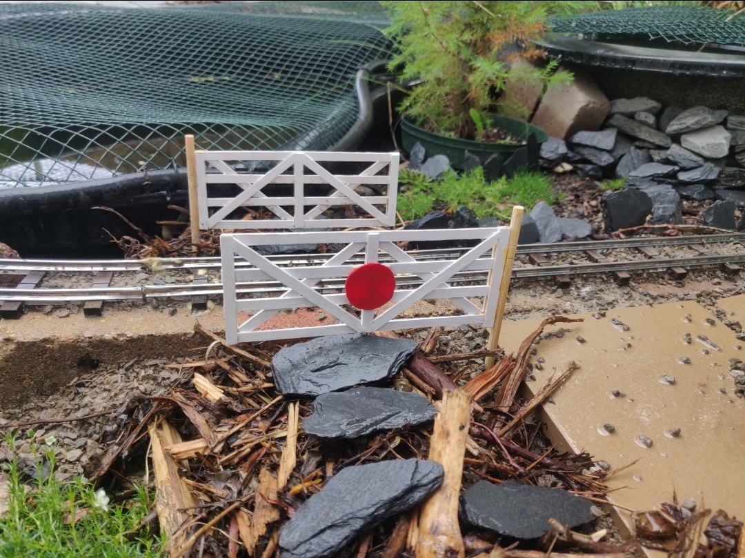

The other day the word came in from the Small Controller that our railway lacked a crossing, and that the situation must be remedied... Never mind that there's no room for a road or much of anything in the middle for which to cross! Needless to say I took steps to remedy the situation as quickly as possible :mrgreen:
The Irish moss on the other side seems to be growing well enough to feed a few tiny sheep, so maybe they can use the crossing. :scratch: For the amount of traffic expected a few signs probably would've been sufficient, but I really like the look of this style of gate. I don't think the Small Controller and his little sister the Young Stationmaster will mind the addition. :D
Re: Nolwyn Valley Tramway
Post by FWLR » Sun Aug 18, 2024 9:21 am
I personally think that a brilliant idea Drew. The Small Controller is a wise little man. You could put where those few slates are a small track to the hard surface and put a small pen/coral has you say in America and Canadian. Then it would look even better....
And the YoungStation Master would be even happier still. :lol

FWLR wrote: Sun Aug 18, 2024 9:21 am I personally think that a brilliant idea Drew. The Small Controller is a wise little man. You could put where those few slates are a small track to the hard surface and put a small pen/coral has you say in America and Canadian. Then it would look even better....
Thanks Rod, I'm thinking I might add some more grit/ballast to the path once the ground is settled in a bit. Food for thought :scratch:

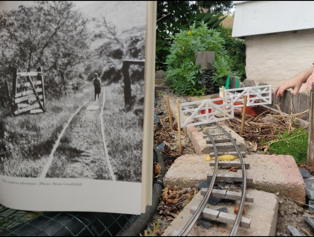

No time for trains this week, but my copy of Railway Adventure finally arrived in the mail. I was out in the garden leafing through the photos and one of them looked familiar...
I feel like I might be on the right track!

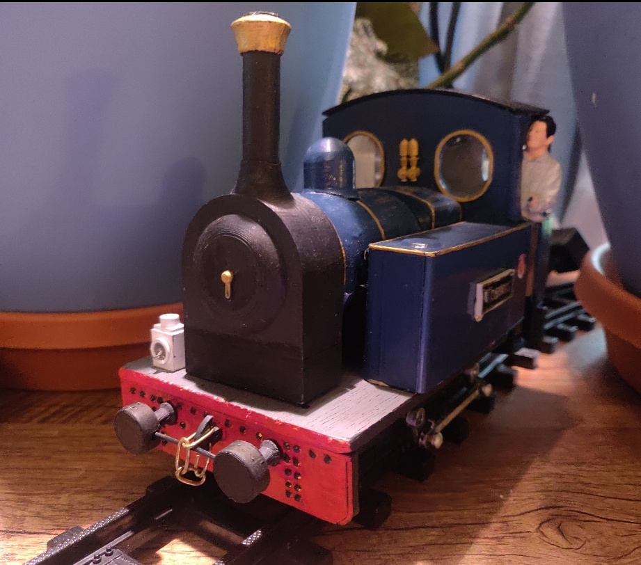

I took some inspiration from the descriptions and photographs of Dolgoch and made some repairs and modifications to Thornas:
I enlarged the front buffers, will do the back ones as well but need to print more of the discs. I even accidentally imitated a little bit of the characteristic sag. :mrgreen:
Having seen how vastly detail can improve a model, I printed Philip's excellent backhead for Luna and painted the cab interior to match. At some point this spring Thornas suffered a fall and lost his rear buffer beam so a replacement was borrowed from his yet-unfinished classmate Rose, a tram. :silent: 2mm nail art rivets were added and I'm happy enough with the effect to order some more for the rest of the locomotive; the trial 100 won't get me much farther (only 36 left).

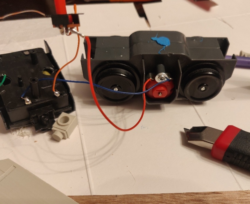

As for the diesel, that was built on the motor bogie from a "Caterpillar" licensed toy train (seen in the background of the first picture).
Powered by 2 AA batteries. No remote, sound, or even reverse yet, but plenty of room to add those in the future.
The body was from Thingiverse: https://www.thingiverse.com/thing:4129195
Originally I had built it as designed, but the front end didn't sit well with me. It just seemed too modern for my (undefined) era. So I designed a slightly rounded nose with one headlight, inspired by a streamlined NG diesel I saw in a Horst Lichter video. I also modified the side panel to add a door which allows access to the batteries, it's a bit finicky but it was fun making the handles actually work.
It all appears to pass inspection. However, as this is my first non-self-made motor block, I was unable to fudge the tolerance on the gauge to cope with the (ahem) inconsistent quality of my trackwork, and it usually derails at one point where a tight curve is slightly under gauge. I will have to sort that out when it's warm enough to work on the track again!
