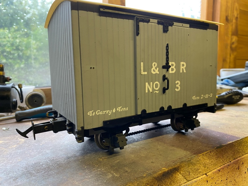

Re: Zach Bond "Momentum Van" project
Post by Garethh » Wed Aug 19, 2020 5:10 pm
Peter your van looks brilliant, I did consider attempting something similar but having a young family means free time is at a premium so I went with the quick and simple solution. Also means I can swap between 32 & 45mm easily if visiting other lines. I was concerned about noise so I’ve mounted it on a rubber washer, may follow you on the foam route if it’s too noisy when I get a chance to run it.
It’s still raining so it’s now got 4wd, don’t think it’s too intrusive

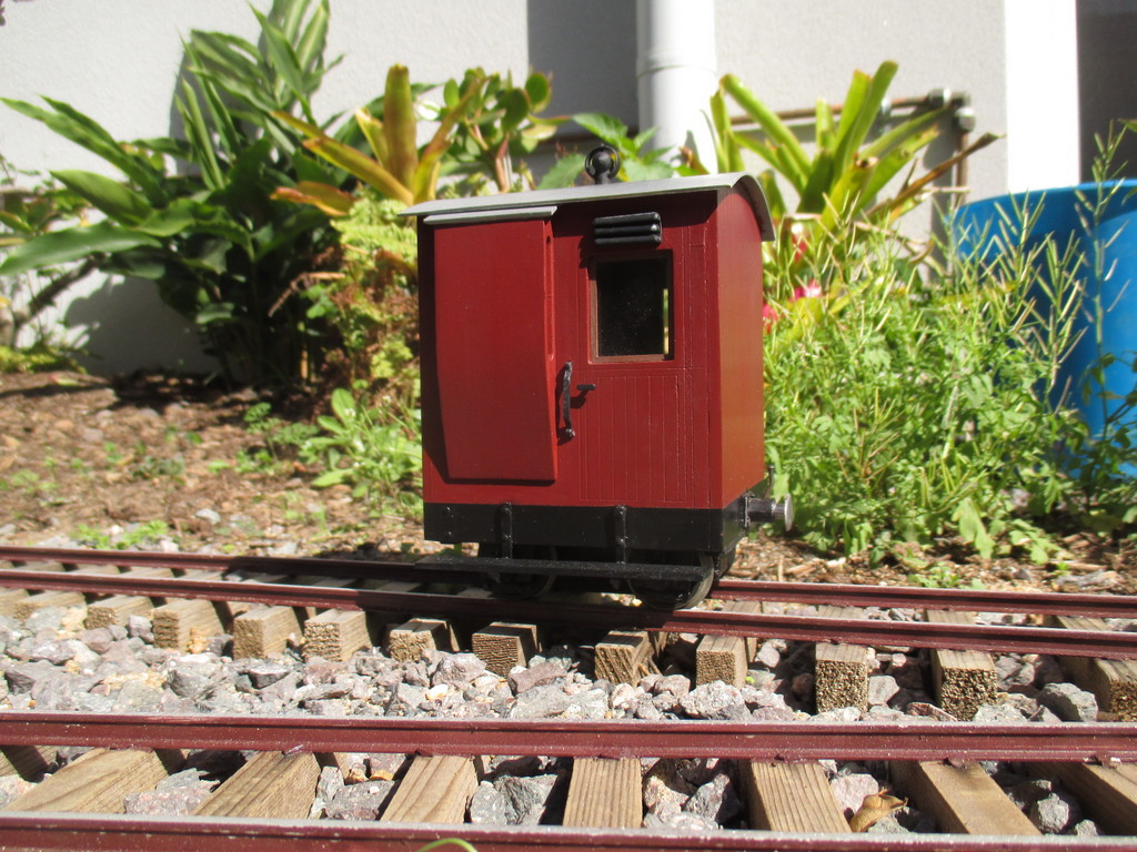

Might as well throw mine into the hat..
I built mine back in 2016, almost certainly lurking on this thread for reference. Figuring a guard's van wouldn't be out of place on most trains, I cut down an IP Rheidol kit, to make something vaguely based on the Innisfail Tramway's guard's vans.
The body and chassis are fixed together via the couplings' mounting studs. The axleboxes carry the wagon's weight in the usual manner, taking care to ensure no part of the mechanism touches the chassis or body, and enclosed the "machinery" from the bodywork to help prevent the body from becoming a sounding box.
It hasn't had a whole lot of use, as for the most part I've had nowhere to run. At around 800g it's quite effective, as we've come to expect of the Zecar.
Here it is running on an indoor test loop years ago.
I've plans for another two momentum wagons, as rakes of sugarcane trucks don't have guard's vans attached. Ordered the Zecars from the US four months ago, and by now can only presume they've been lost somewhere. I've just contacted them about re-sending the order.. One of them will become a navvies' tool wagon, based on this ex-Moreton sugar mill example now stored at ANGRMS. I don't remember what I had planned to build with the other mech.

Garethh
Posts: 219
Location: Surrey
Post by Garethh » Tue Aug 25, 2020 3:21 pm
Managed to get out in between showers for a quick test run, tricky driving with one hand a filming with the other, but should give an idea. Definitely calms her down a fair bit, especially considering the gradients and curves on my line are pretty severe. Is a bit on the noisy side but I live next to a main road so in the flesh it’s not really noticeable.

Garethh
Posts: 219
Location: Surrey
Post by Garethh » Tue Aug 25, 2020 5:23 pm
Yours looks like it works nicely. Mines at around 6-700g at the moment, may experiment with a bit more weight
