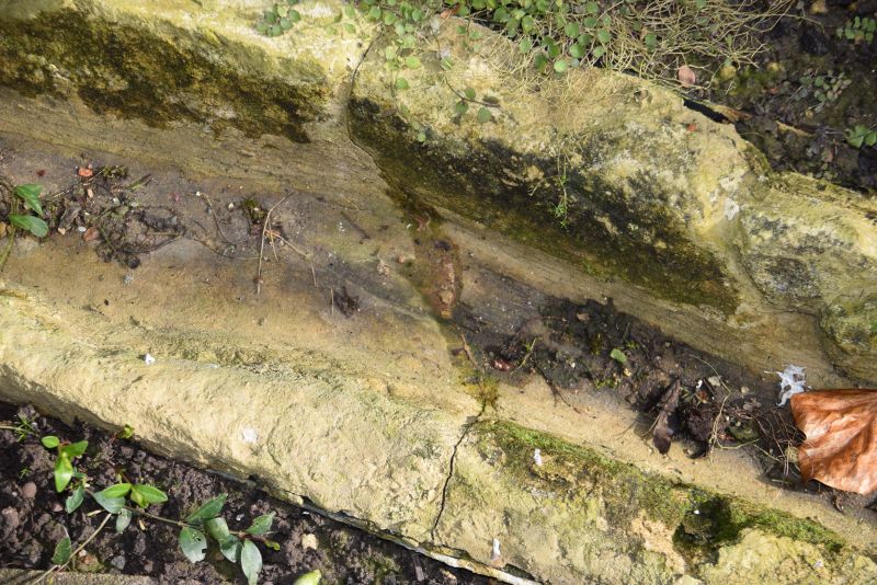

At the end of September, before the weather really turned, I noticed problems with both the stream and the bridge.
Firstly a crack across the stream about 3 or 4 feet downstream from the bridge:
DSC_0003 small.jpg (194.21 KiB) Viewed 32003 times

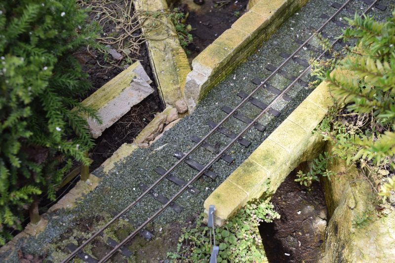

The heaving clay has really mangled the bridge as these pictures show:
DSC_0002 small.jpg (189.65 KiB) Viewed 32003 times
DSC_0001 small.jpg (191.53 KiB) Viewed 32003 times
The broken off parapet was actually done by a pigeon blundering through the cracked piece.
The plan is, once the weather warms a bit and the danger of frost is past, to open up the crack and try to repair it, there is a butyl liner underneath so it will hopefully be possible, although I'm pretty sure it will crack again as the ground moves.
As for the bridge, I'll mortar the bit back on but there are so many cracks in total that I think it will neeed to be replaced by something else in due course.

I feel for you Philip, I had a crack develop just after my creek leaves the pond and I'm on sand which is generally a stable foundation.I raked the crack out, made sure it was dry then filled it deep down with silicone rubber smoothing with a finger then sprinkled sand on it. When cured you can't see it and it is flexible. It lasts several years. As for b!!!! pidgeons and others "nuf said".

LNR wrote: Sun Mar 22, 2020 11:50 am I raked the crack out, made sure it was dry then filled it deep down with silicone rubber smoothing with a finger then sprinkled sand on it. When cured you can't see it and it is flexible. It lasts several years.
Thanks Grant, that sounds a good idea. I've been toying with using Stixall which also has a rubbery texture, but it may depend on how big the crack is when I start raking it out.
I would go +1 for Stixall. It will give a much more secure bond and fill than silicone. Wipe off surplus and then wipe down stonework with isopropyl alcohol (or meths, I think) to remove any shiny residue.
