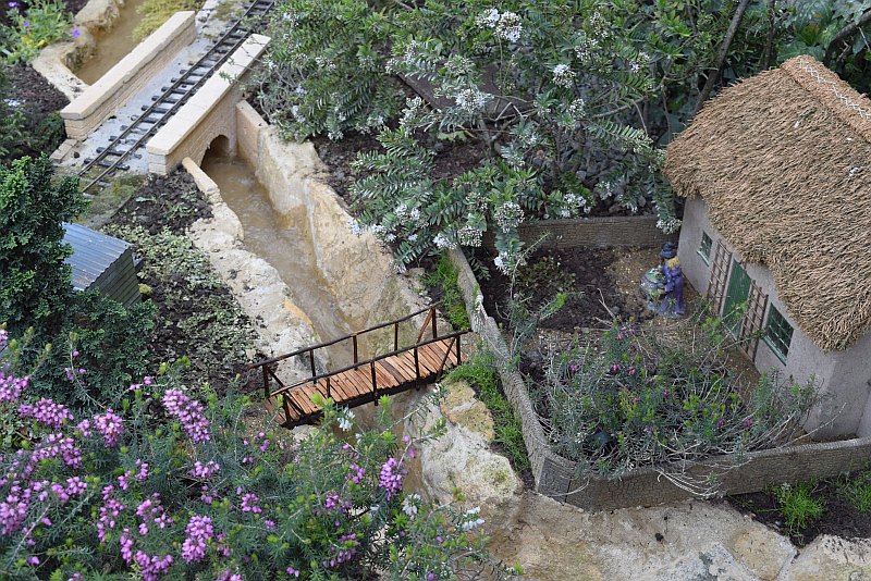

I said that there are some odds and sods to sort out, and the more observant amongst you may have spotted in the last photo, above, that there was no gate into the cottage garden and, more importantly, no way for the residents to cross the stream and get to the railway.
The gate was simply a question of replacing the original one from the corner into the new position in the centre, which has now been done.
A small 'rustic' footbridge has always been on the jobs list as part of the stream construction. So much so that last Autumn I had the foresight to save some prunings from the apple trees , and this is the result:

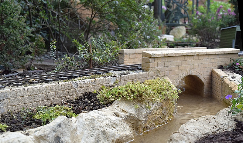

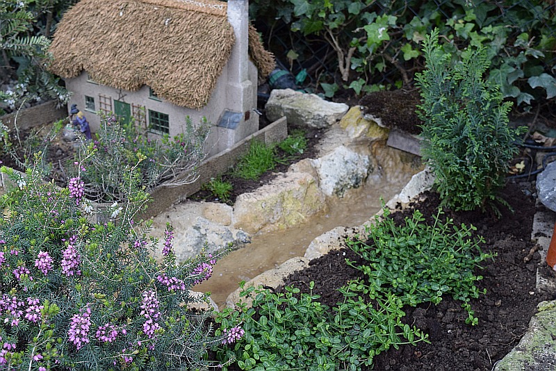

OK, it's been a long time coming but the stream is finally finished. It still needs some attention to the planting and of course needs time for Mother Nature to do her stuff, and the railway itself needs some tlc as well, but other than that it's there.
DSC_0001 small.jpg (316.59 KiB) Viewed 33360 times
DSC_0002 small.jpg (271.49 KiB) Viewed 33360 times
DSC_0010 small.jpg (284.86 KiB) Viewed 33360 times
DSC_0011 small.jpg (499.49 KiB) Viewed 33360 times

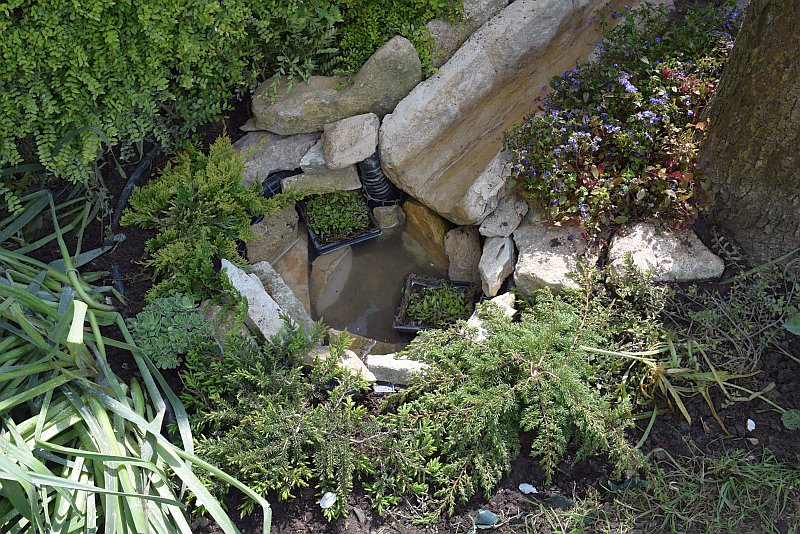

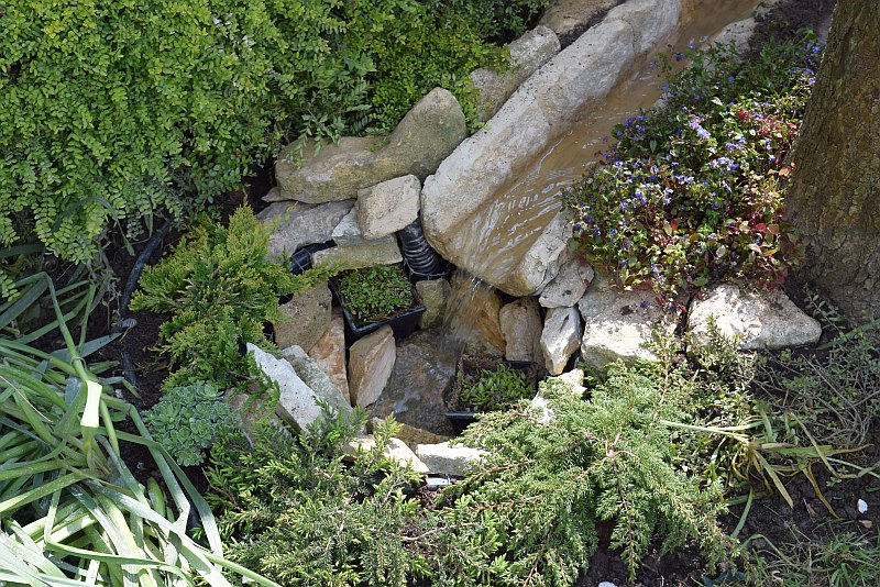

I did say earlier that I needed to work out something that had been bugging me and that it would either be an epic fail or a triumph. Well I'm happy to report that it isn't a fail, but although I'm not 100% happy with the result, I'm hoping that time and plant growth will finish it off.

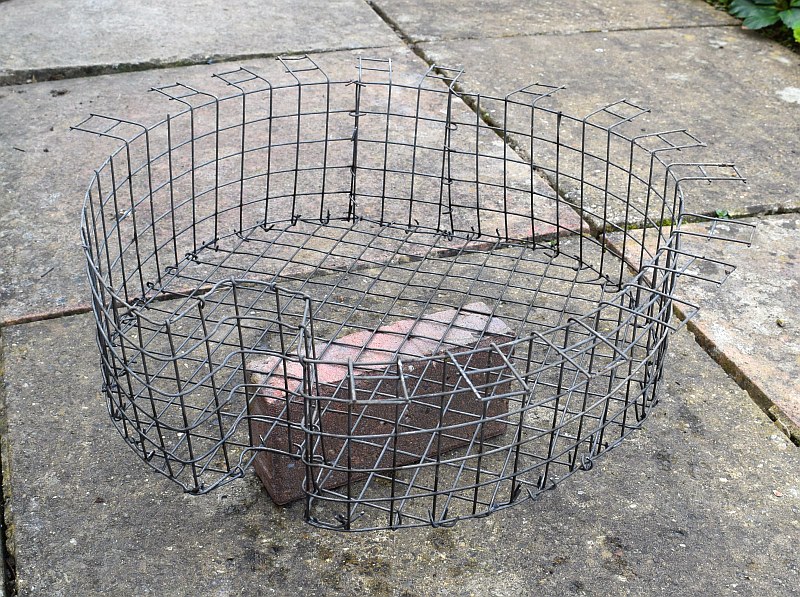

Rik's end sump he finished with an upturned lid filled with white pebbles which looks fine in it's context and I was originally planning to do something similar. However my sump would be in the middle of a planted garden border and a circular patch of white pebbles simply wouldn't look right ( Remember the conditions on my Planning Consent? " You can do what you like as long as it doesn't spoil the garden"). After throwing various idea's around in my head, I came up with a plan. I didn't want a static pond which might attract mozzy's and I was mindful of Rik's experience of trapping and drowning wildlife, so I fabricated a basket from some 1" weldmesh which was lying around and sized to sit inside the sump at about 120mm down.
DSC_0003 small.jpg (297.08 KiB) Viewed 33360 times
Then I bought some marginal pond plants in 110mm deep pond pots and arranged them, along with bits of rock, in the basket. Around the sump I've arranged 3 Prostrate Junipers, bits of rock and various other plants to disguise the edges. When the stream is switched off, the plants are semi- submerged
DSC_0013 small.jpg (266.05 KiB) Viewed 33360 times
and when it is running the waterfall created keeps them splashed wet. My hope is that in due course they will spread and sprawl over the rocks.
