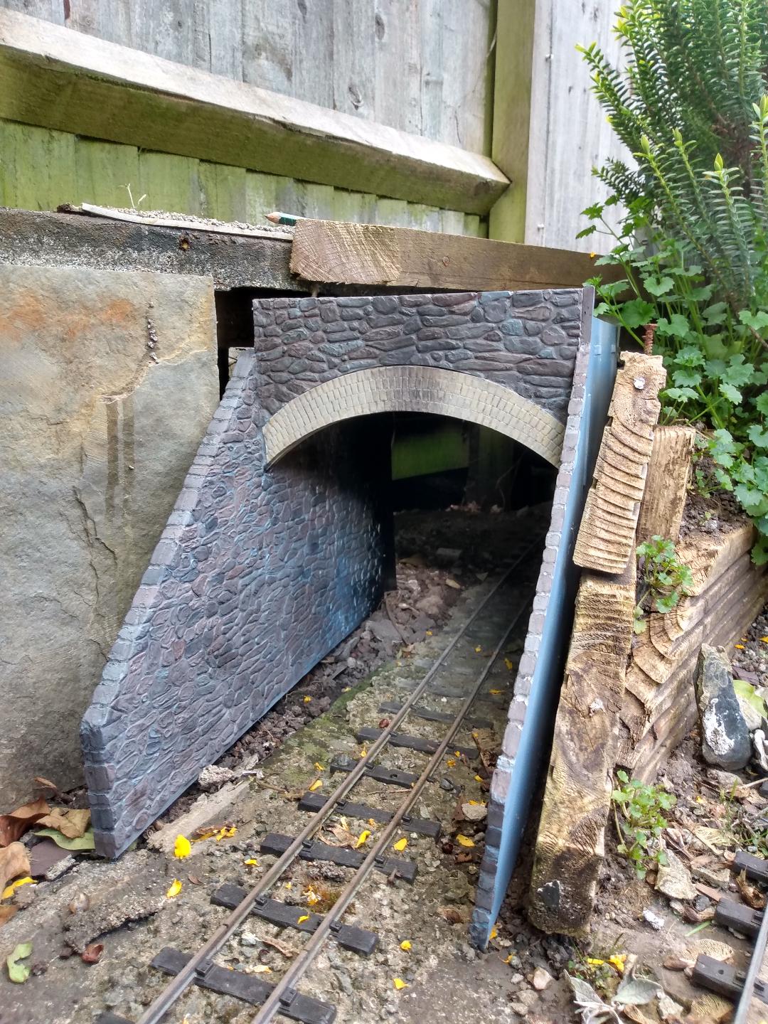

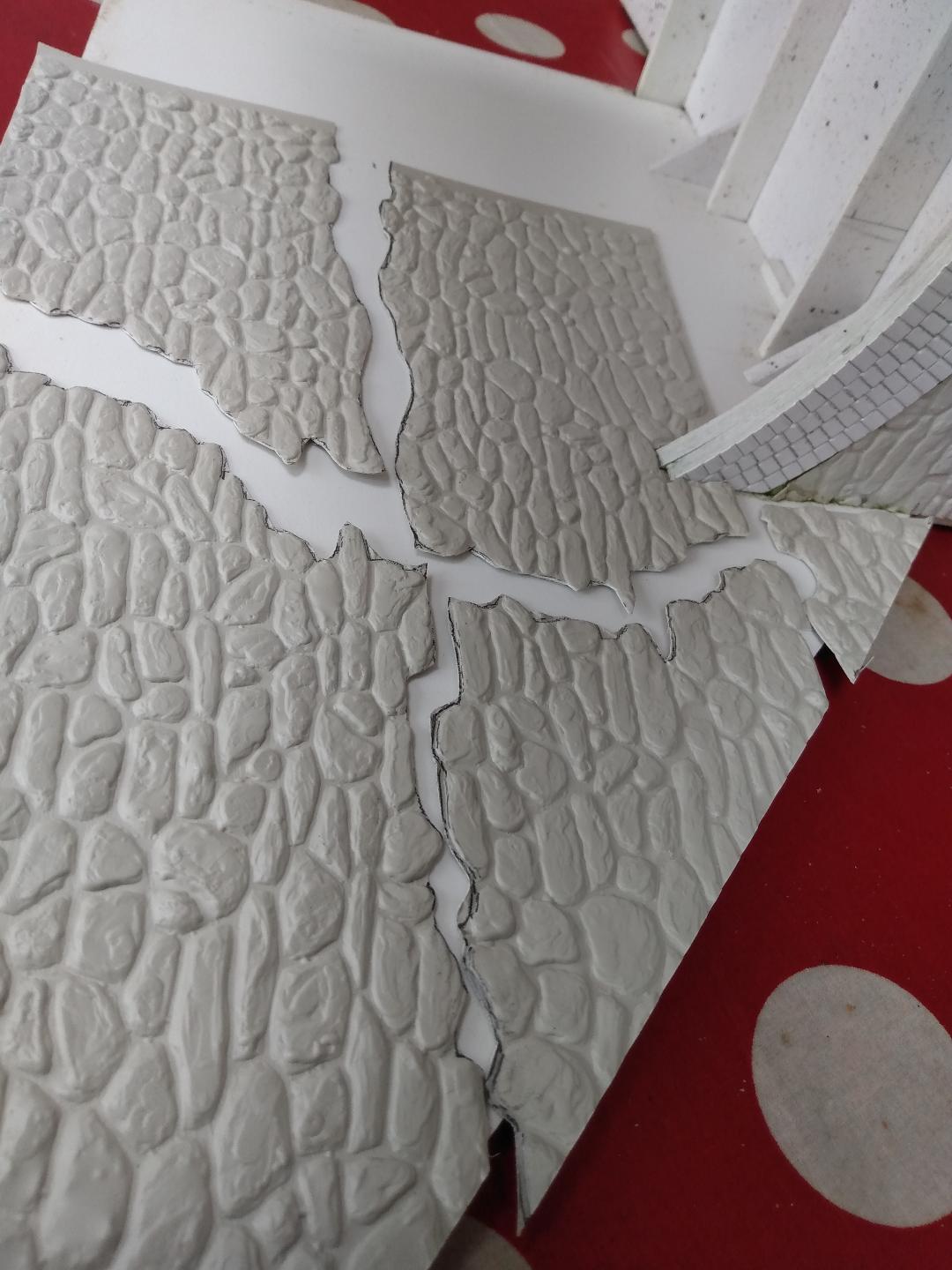

With warmer weather approaching I'm looking forward to running trains semi-regularly, but first I'd like to get the area around the tunnel sorted out - it's currently a complete mess, and it's where the signal box will end up, so both projects are kind of linked.
As reported here, I created the basic shape of the tunnel mouth a while ago, but it hasn't fared well out in the elements. The stone cladding has come unstuck, peeled off and then curled up. I think the problem is that the glue dries really quickly, so it's hard to get enough on a large area. With that in mind I flattened out the old embossed sheet as best I could using boiling water to soften it, then cut it into smaller pieces that are easier to glue.
I did the same on the other wall, which has remained un-clad until now:
Tunnel bits.jpg (144.95 KiB) Viewed 48450 times
That's all glued on now, and the gaps filled, so I'm tidying up and adding a little detail with the Dremel now, then hope to start on the painting...

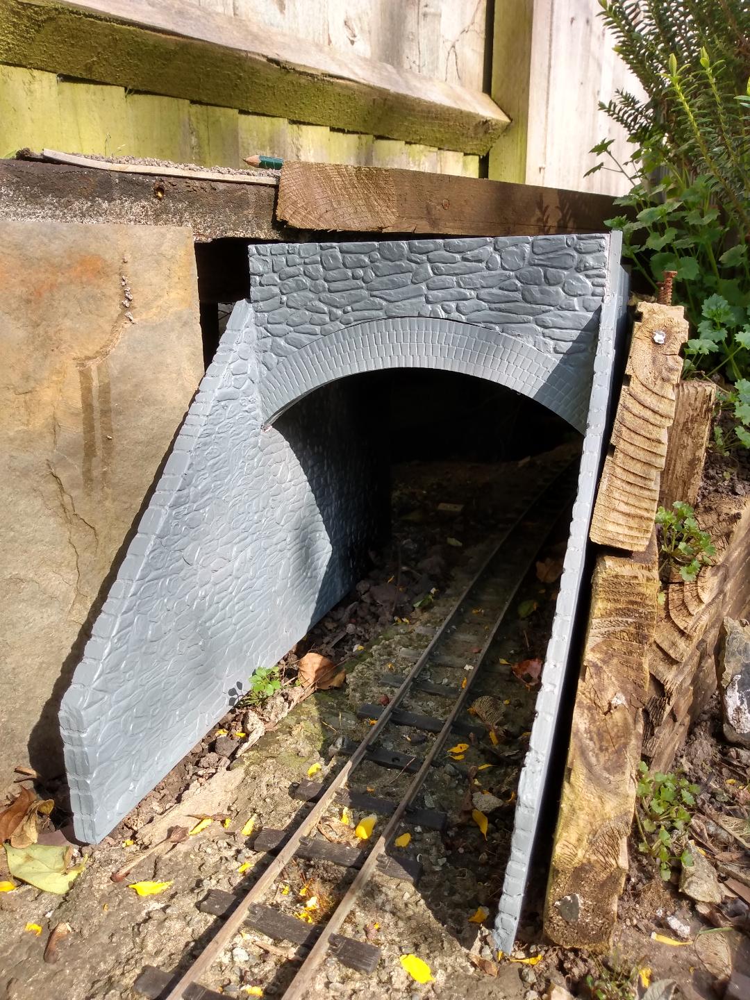

A little more progress - primed and temporarily back in place prior to final painting:

That looks good, Can't see the joins :D
Re: (WH)WHR Buildings
Posted: Sun Mar 29, 2020 11:17 pm
by IanC
Very impressive repair work.

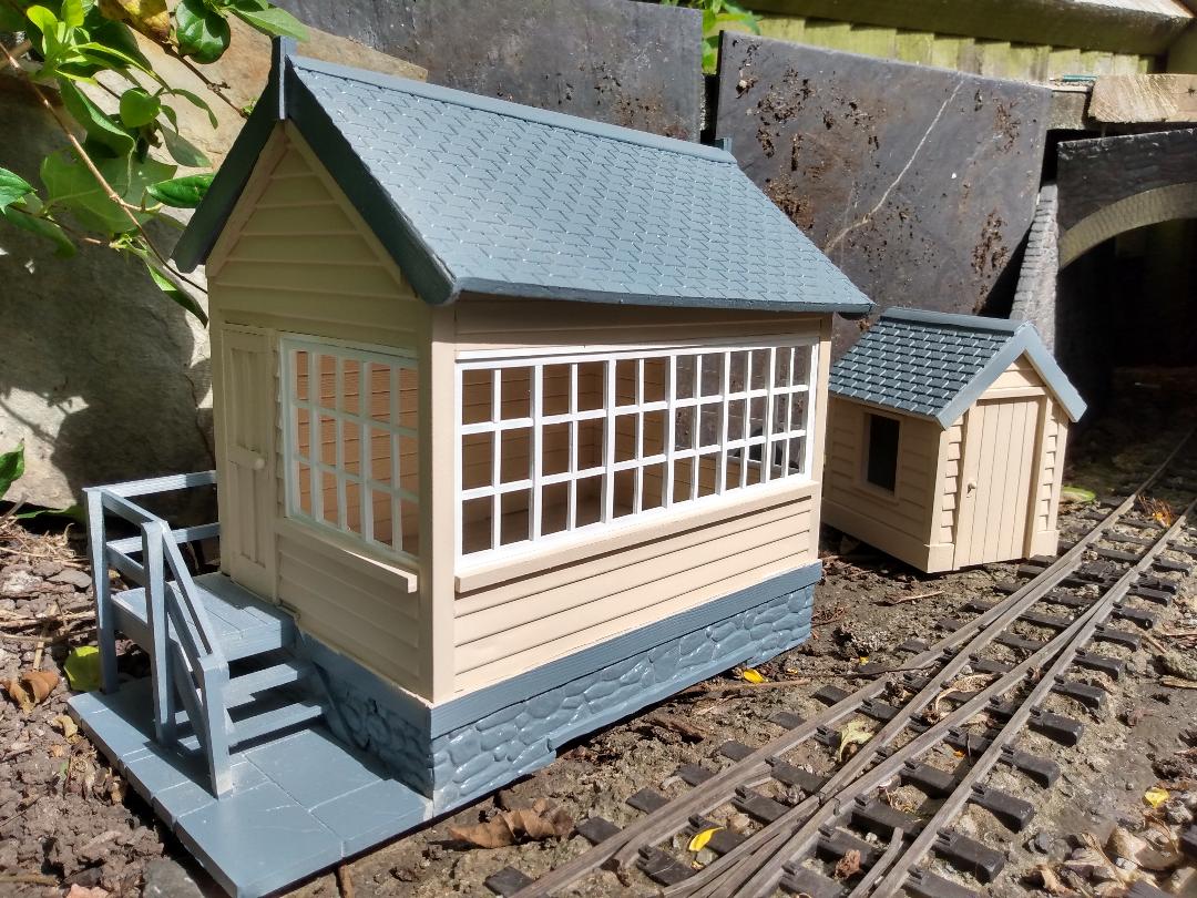

With this weekend's warmer weather I got the spray cans out and got stuck into painting the signal box and shed:
Signalbox 17.jpg (193.5 KiB) Viewed 47956 times
Lots of work still to do, but I like getting to this stage, when the spray painting's done and the rest can be tackled in stages, with a brush.
The 'box roof's not on properly yet - I had to do a bit of a redesign, and it's quite a tight fit, so although it's still removable I don't want to put it on or take it off too often.

The 'box will be in the same colour scheme as your station building, which I'm planning to carry on using until you need it because I haven't built my own one yet! Don't worry, it won't stay out in the elements like the other buildings! They should make a nice pair for now at Trefechan, the lower terminus. The shed will head up the line somewhere, not sure of the exact spot yet...

The signal box base will have the same finish as the tunnel mouth, which was one reason that I was keen to progress both projects at the same time. The other is that between the two "building" projects and some landscaping, this area of the railway should be significantly improved - it's been an eyesore since the planters that were here before fell apart... The two slate tiles temporarily propped against the upper track will form the backdrop, with planting in front of them and over the tunnel mouth.
