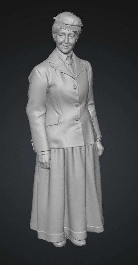

StuartJ wrote: Mon Sep 29, 2025 12:24 pmNot working women, but does this help for Victorian passengers and staff/crew?
A bit assistance from Gemini and Photoshop passed into Meshy got this model waiting to download.
Meshy 6 screen shot.jpg (36.61 KiB) Viewed 19816 times
Maybe a bit too much like King Charles facially though :king: :lol: :lol:

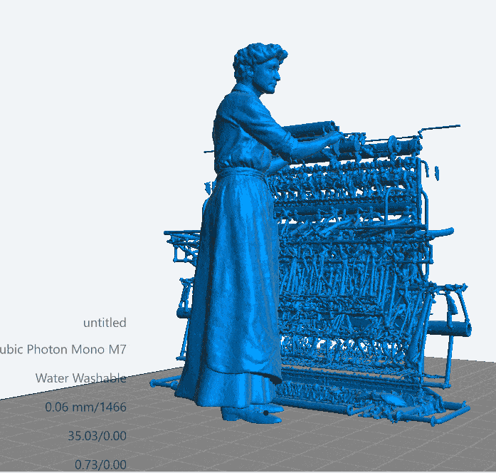

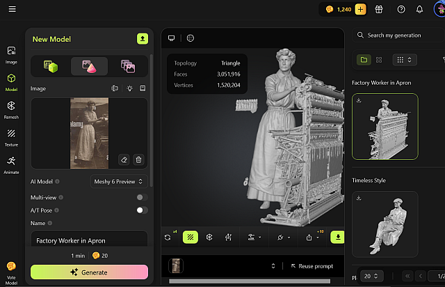

Good as it is for generic type pictures of figures, I've been a bit disappointed with the way that Meshy distorts photos of real people. However, by accident it has just nearly blown my mind!
I came across a picture on Alamy of a girl operating a Victorian cotton mill. Thinking of Trevor wanting female workers, i downloaded the picture and roughly edited her out and bunged it into Gemini. For some reason, it deleted most of the background but left part of the loom in. Not expecting anything usable, I loaded it into Meshy anyway, and Wow!
Screenshot 2025-10-03 21.38.10.png (169.91 KiB) Viewed 19287 times
2nd optimised.gif (11.81 MiB) Viewed 19287 times
I wasn't expecting anything usable, but merely some garbage to edit out. i doubt it would print well though, because there is just too much that is too small to support. It does potentially open up possibilities though. F'rinstance, how about a signal man and all of his levers, printed as one unit?

Post by Paul_in_Ricky » Sat Oct 04, 2025 11:25 am
That looks a good figure (if you cut the unprintable mess off).
Did you run the original image though Gemini to improve it as well as the erasures ?
Posts: 6037
Re: 3D print people figures
Post by philipy » Sat Oct 04, 2025 12:28 pm
Errr... sorry. I must have been asleep when I wrote that post. :oops:
I didn't use Gemini, I just put the picture straight into Meshy and pressed generate. Meshy also added a 3d version of the watermark "Alamy" so I put it into Meshmixer and deleted that bit.
