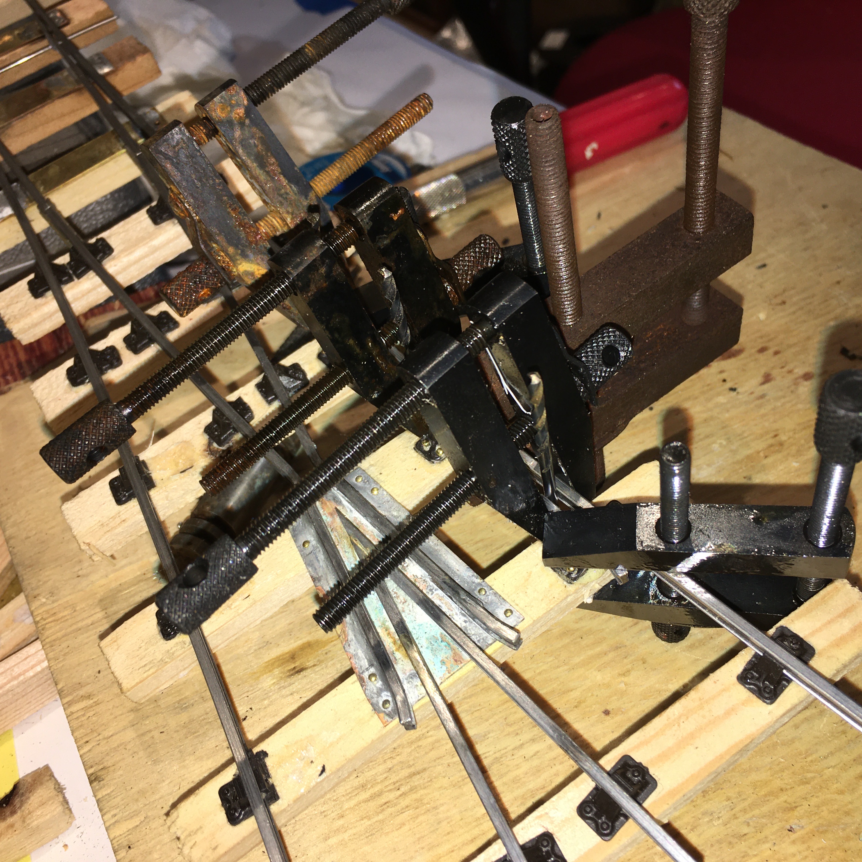

I have "cut and shut" those check rail chairs on the point. I used 2.3mm drills as spacers and clamped the rails up to the spacers as in the following photo. I did drill out the false bolt heads and glued and pinned the chairs down in their new position:

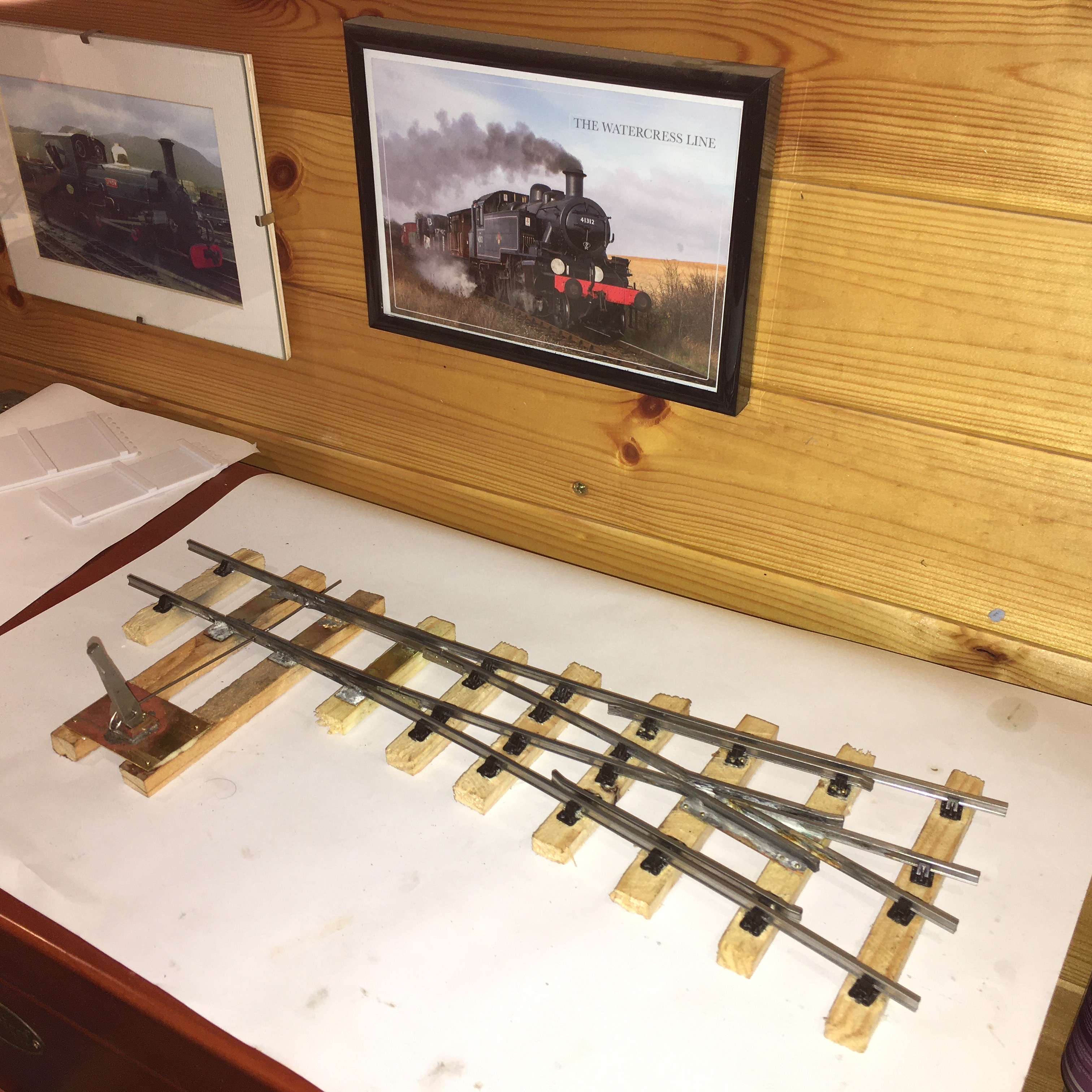

and finally a photo of the finished point:
The gap between the check rail and running rail ended up being a pretty even gap of between 2.45mm and 2.5mm - which seems perfect to me. Of course the final test was with a wagon and coach - nothing attempted to climb the frog - so I think that is a success.

That point (and trestle) has come out very nicely. Nice robust throw, too. :salute:
Drill bits make great precision spacers, I use 1.5mm bits between the wheels and frames of Roundhouse locos when setting for 45mm gauge.

Old Man Aaron wrote: Tue Oct 19, 2021 7:02 am That point (and trestle) has come out very nicely. Nice robust throw, too. :salute:
Thanks chaps for a really handy tip. Not thought of using drill bits as precision chunky feeler gauges or spacers.

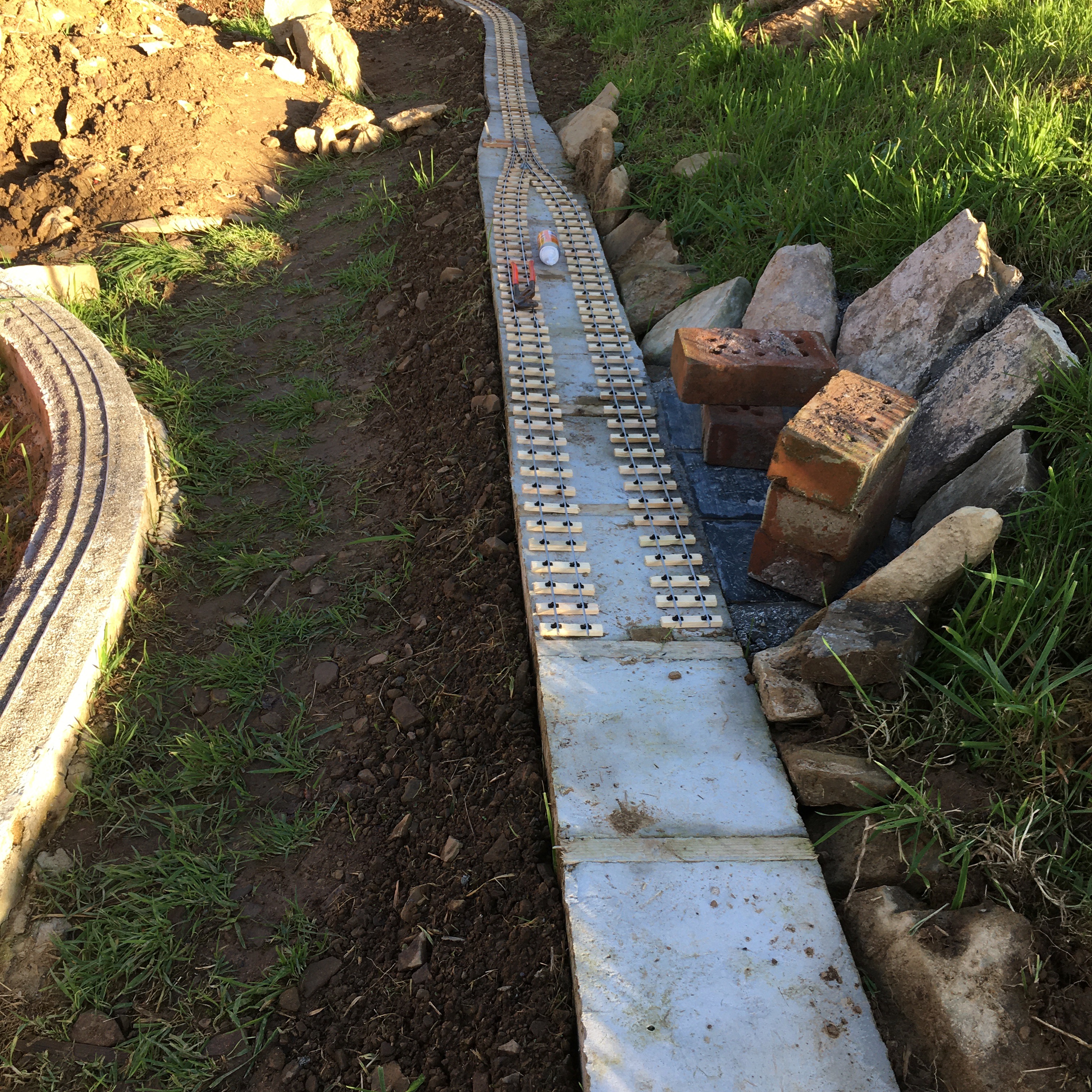

It has been raining here for the best part of the week - which has slowed progress down a bit. I have however managed to lay track into the passing loop at Dduallt station:
The photo was taken before the track was fixed down - which I hope explains the kink in the near track!

There's nothing like a shot of freshly laid trackwork to start off the day, to my mind ...... :thumbup:

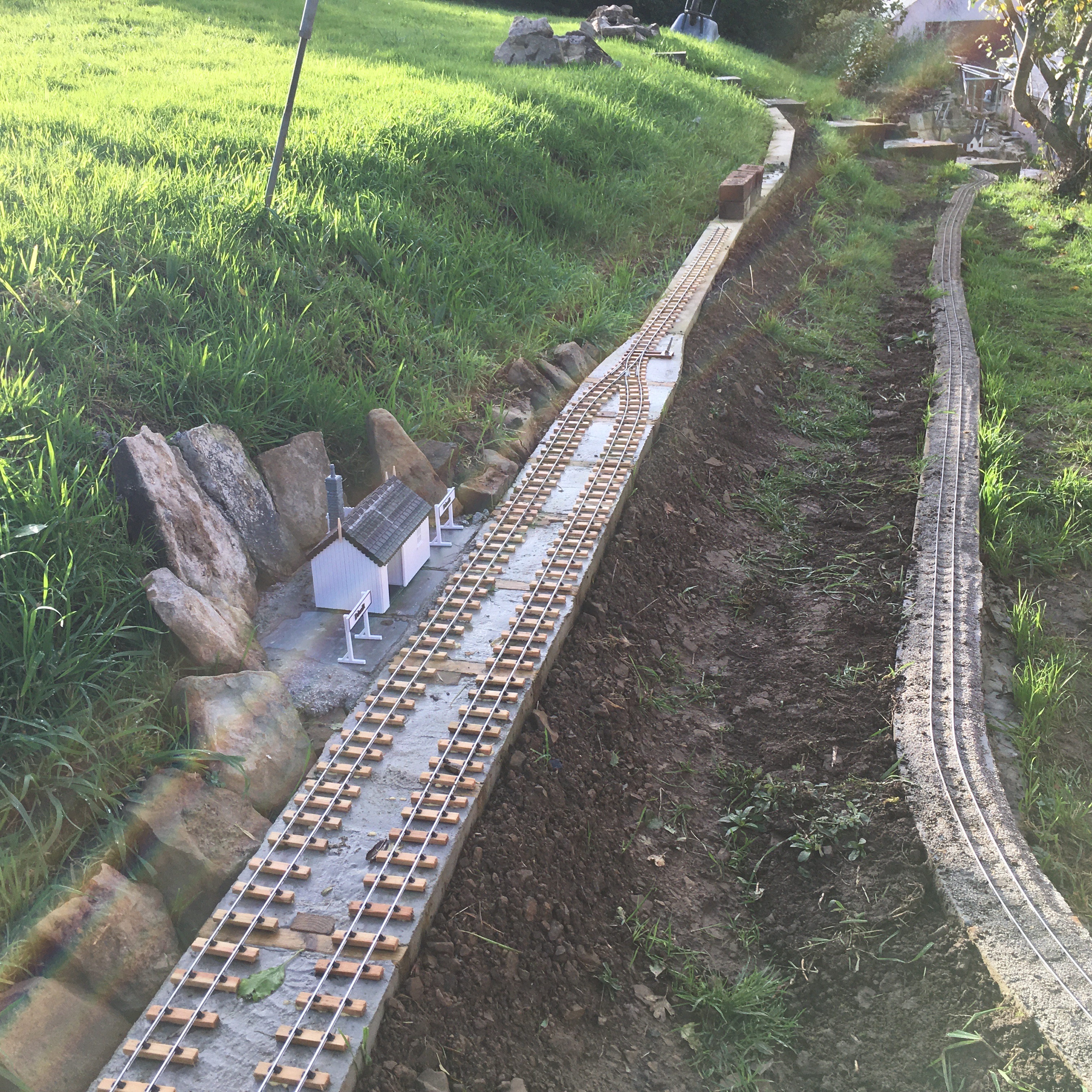

The passing loop is complete, and I will now be able to run trains up the line to the new station. It isn't finished but this should give you an idea of what things will be like:
The station building and signs are not permanent yet, and the landscaping into the bank behind the station needs completing - or I will end up with grass everywhere again.

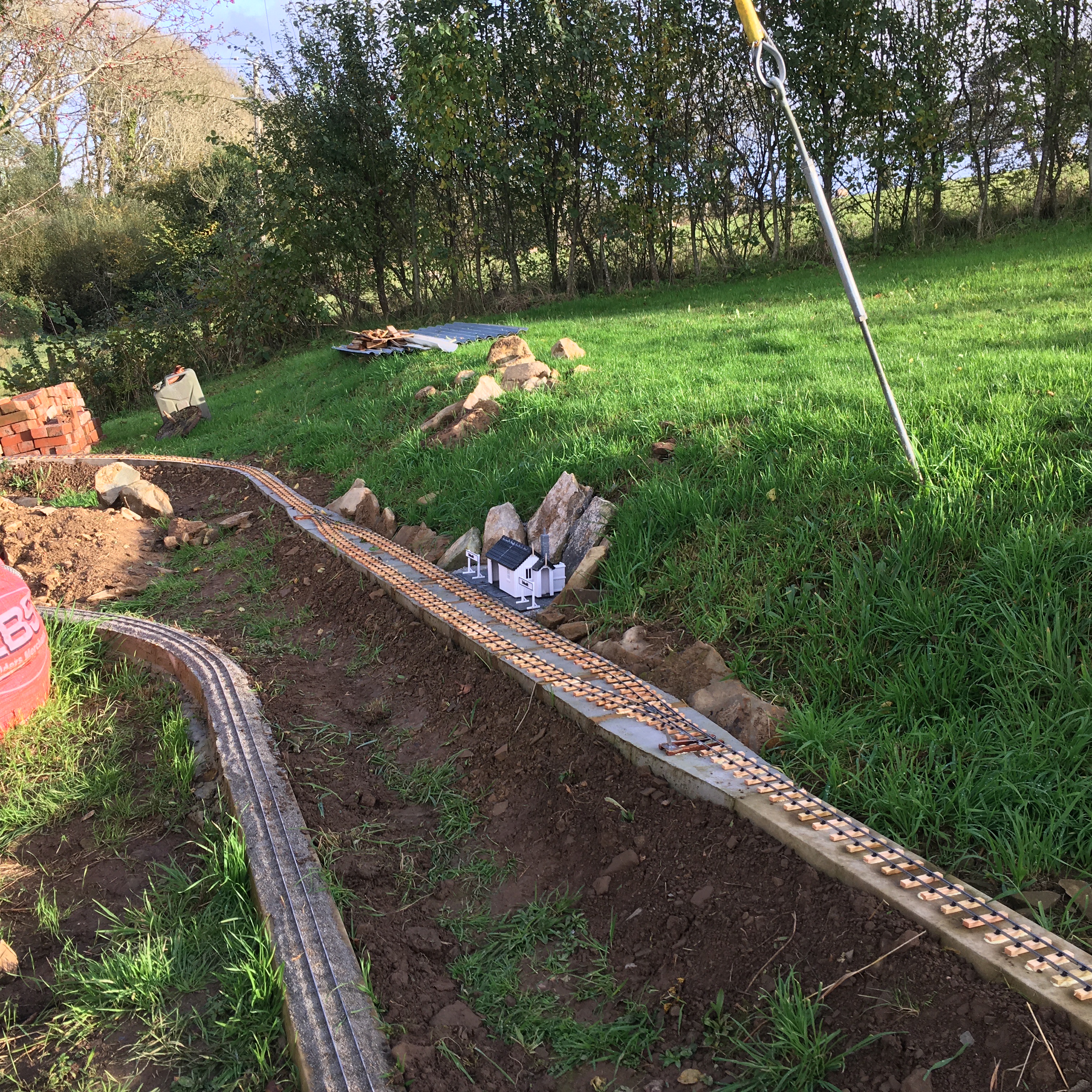

The weather is deteriorating here in West Wales (we have had a week of rain and wind) so I don't know how much further I will get before the spring. However I hope to at least get track laid as far as the steps:
And for next year further extension towards and through the hedge into the vegetable garden.
Posted: Fri Oct 29, 2021 4:31 pm
Trevor, I live in West Wales too and the weather here has not been anywhere near good enough to accomplish what you have, so well done! Not only is it wet and windy but very slippery underfoot too, especially on sloping ground similar you yours. Top marks for sheer determination.

It is getting slippery and that is what is about to force me to give up. Still as you say progress is being made.
