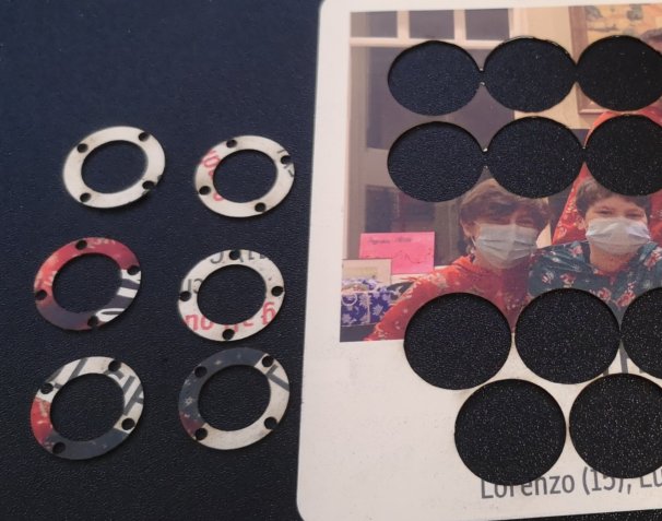

New cylinder gaskets cut from a non-glossy Christmas card. I wonder how my friends and family would take a request that all future cards be on non-glossy paper to allow for easier 'recycling?!'

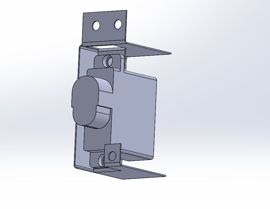

Other than that, I'm playing with ideas for mounting the micro servo in the standard location, whilst providing a bit of space for a Deltang receiver. I thought about 3D printing something, but the idea of putting plastic in the cab of a spirit-fired loco seems.....unwise. The idea is that this would be cut from sheet metal using the laser cutter. There's a few problems to fix. The top tab needs to bend from behind the servo instead of the front as the front corner is very thin in the current design.

Christmas cards, interesting choice for a gasket. during my apprenticeship one of the tasks was to make gaskets, and brown paper was what we used, and a ball peen hammer to "tap" them out, no cutting implements allowed.

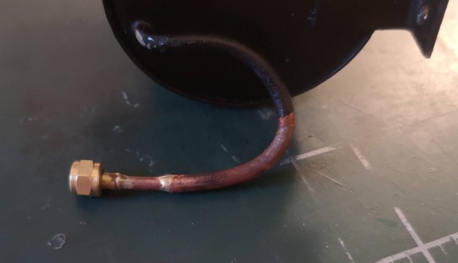

Unfortunately, whilst bending the pipework to fit the body, this happened:
That's the steam line to the pressure gauge. I was sensible enough to remove the gauge before bending the pipe, as I know the gauges are fragile, but obviously I was expecting the pipe to be more robust.
I've no idea how to go about fixing this. Best idea I can come up with is breaking it off completely, cleaning it up, then fitting a sleeve over the break and silver soldering the whole lot? Would this work, or is it better to cut the pipe short and somehow create a new fitting? Or remove the pipe and replace it at the connection to the boiler? (No idea how I would do that).
Devastated to have fallen this hard at almost the final hurdle doesn't even begin to describe it...

Lovely looking loco! As for the pipe, why not just cut it off and solder a new nipple on? Pressure gauge will sit a little lower but not a big deal? Otherwise you could fit a new nipple and a union to a bit of pipe with a nipple each end?

Yep. A few folks have already pointed that option out to me. Makes the most sense. Just need to learn how to silver solder. & Procure the necessary supplies...

I know how you feel, getting a loco to that stage, then being hit with a setback like that. Silver soldering is a nice, easy job - when you've proper cadmium-baring solder to hand, anyway..

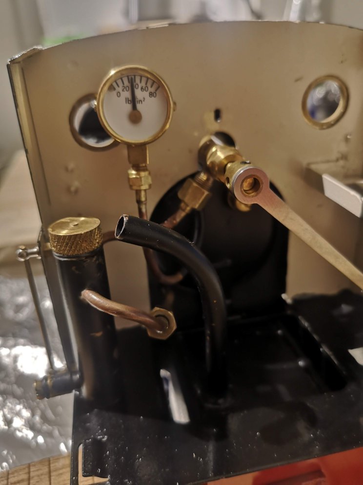

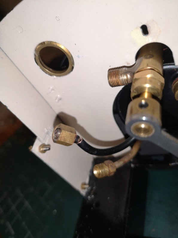

Finally got the gauge connection repaired with silver solder:
Passed the steam test with no concerns: It still runs smoothly on air, with one slightly sticky point where, if it stops, it can require slightly > 10psi to get back going again. However, on steam it seems to really struggle, and needs the throttle wide open just to turn over:
