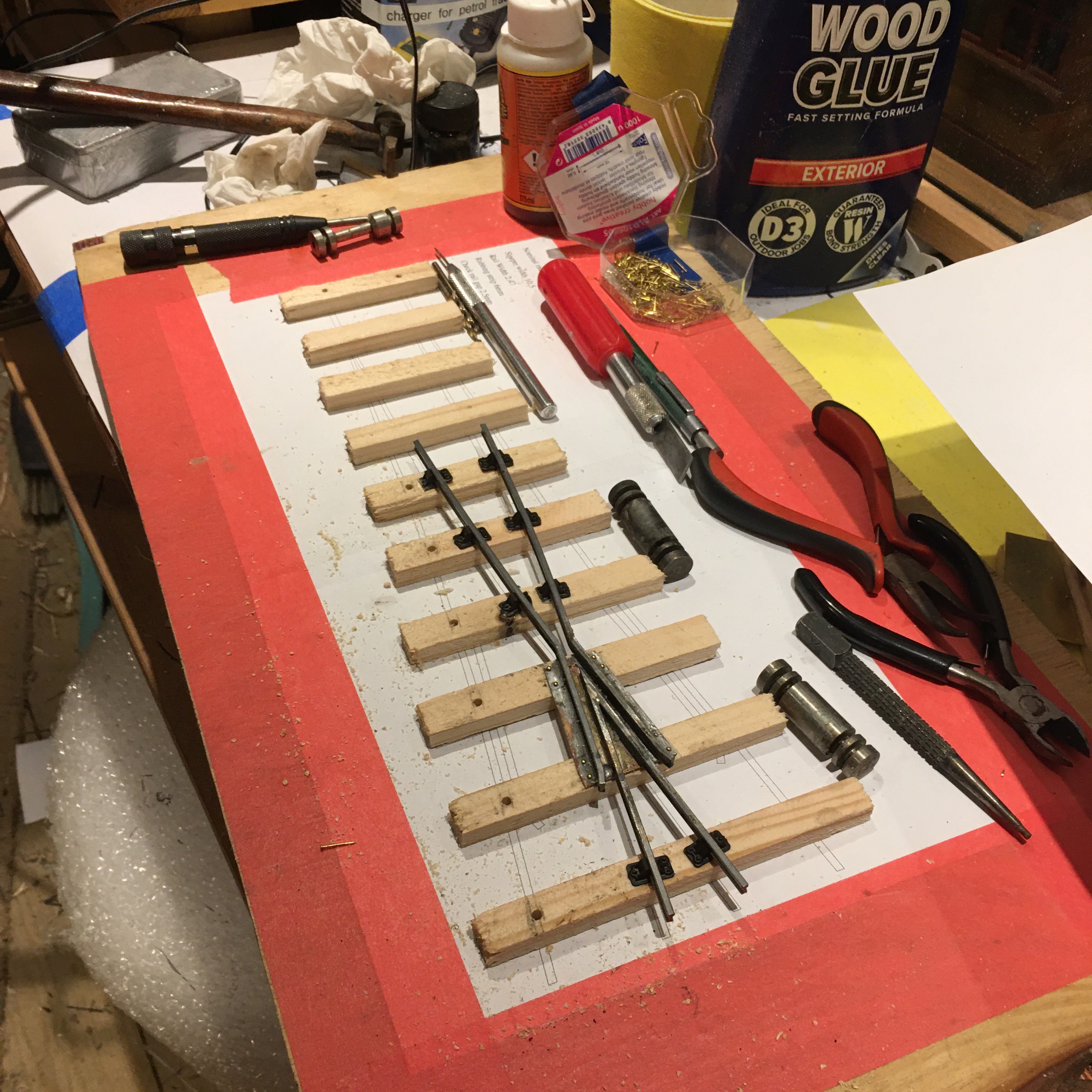

The point is progressing:

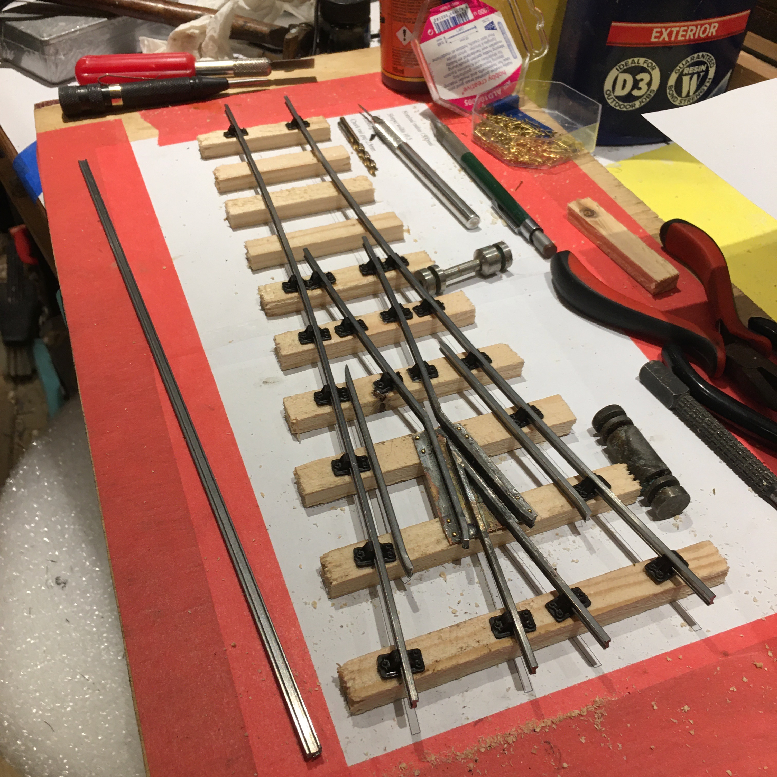

the soldered frog and wing rails fitted:
The chairs are fitted into holes, and glued in place as well. There are 8 brass pins holding the frog in place (as well as glue).
and the outer rails temporarily fitted in place:
I positioned the outer rails using the track gauges, marked where the rails crossed the sleepers on both sides of the rail, and drilled holes central between the two pencil marks. The temporary assembly is to make sure that the holes were actually in the correct places - and that the track gauges fit easily. Proper check rail chairs to be fitted before final assembly.

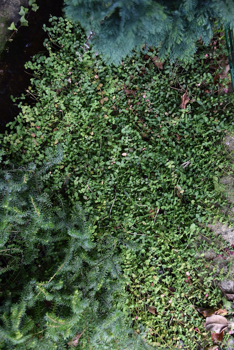

Posted: Sun Oct 17, 2021 1:16 pm
by Jimmyb
philipy wrote: Sun Oct 17, 2021 11:25 am
Trevor Thompson wrote: Sun Oct 17, 2021 9:23 am
gilfachphil wrote: Fri Oct 15, 2021 8:29 pm At the Welsh Botanic Garden today in the Japanese garden I spotted Leptinella Squalida which is a low growing mat forming plant which might be suitable for the bank.
I will have to look for that - its about time we visited again
It's fairly widely available. I got two at different times, but neither have survived, don't know why. It comes in two different colours, a greenish one and a dark brownish purple colour.
Looked this up and I have some, the spot in which it was planted died, but it has spread, and though difficult to see in the photo (it is the black variety) it is everywhere in just two years.
Posted: Sun Oct 17, 2021 1:50 pm
Interesting picture Jimmy, which may explain why mine died. I planted it on open borders between lawn and track, whereas yours seems to be happy in the gaps between the rocks. If thats correct then I fear it won't like Trevor's big open bank.

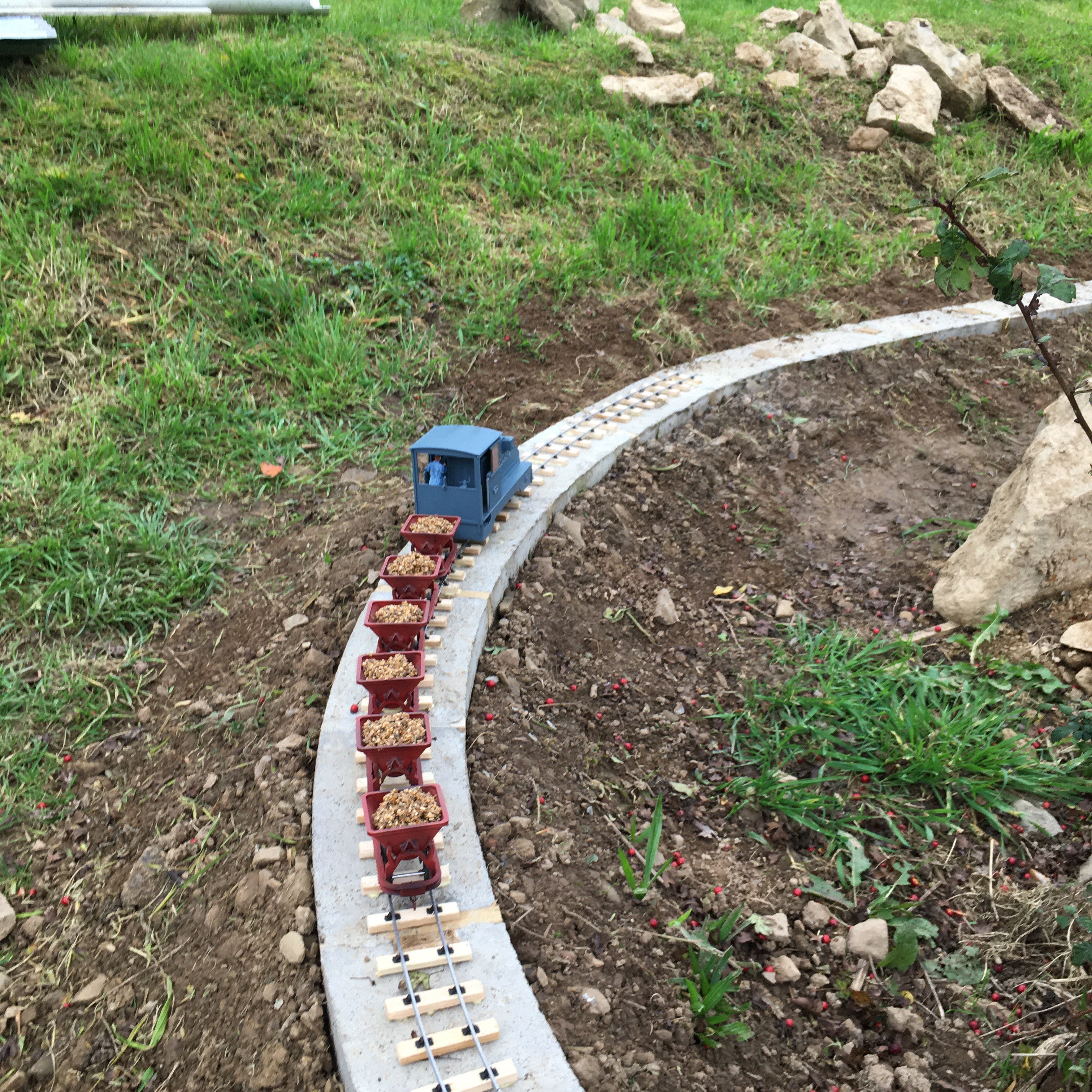

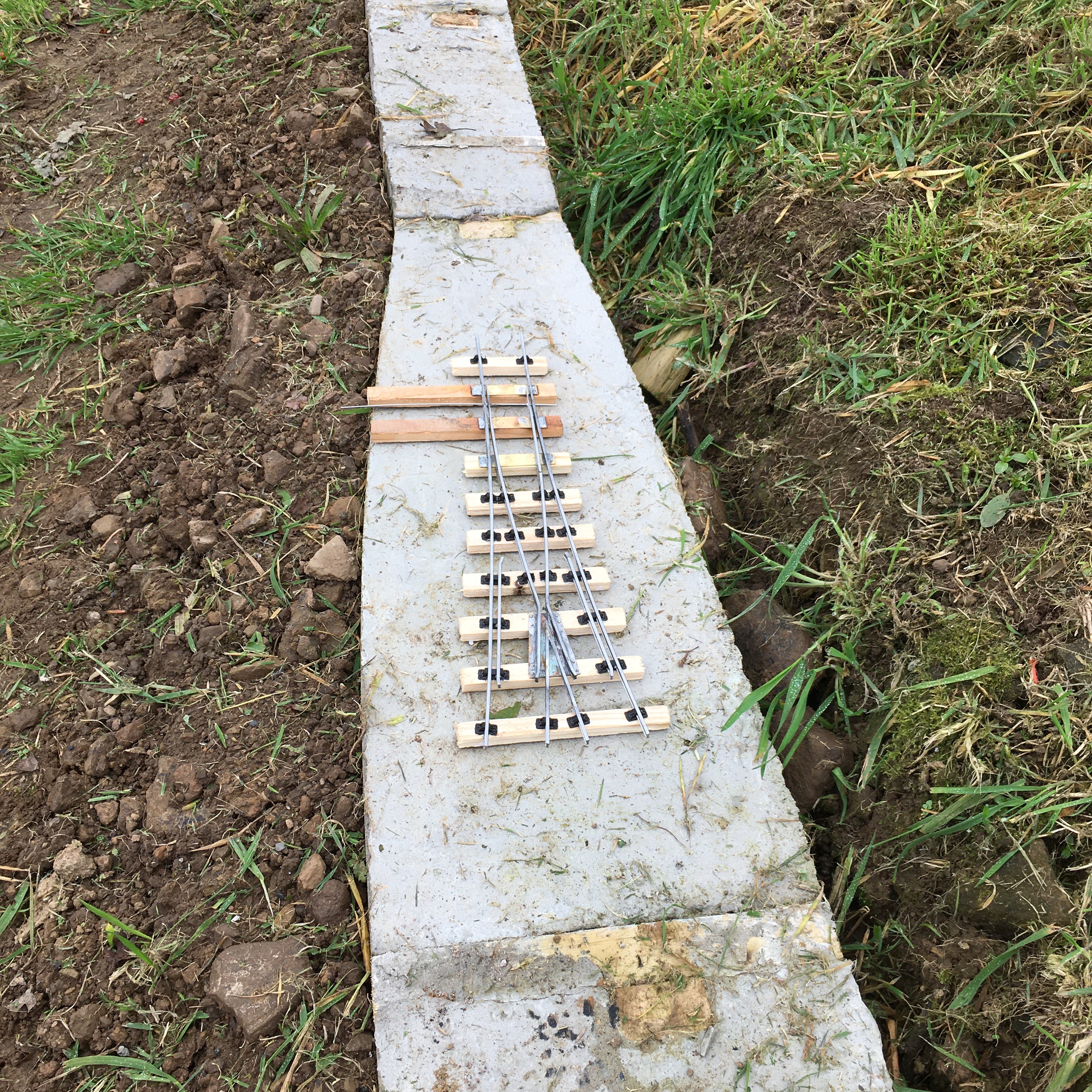

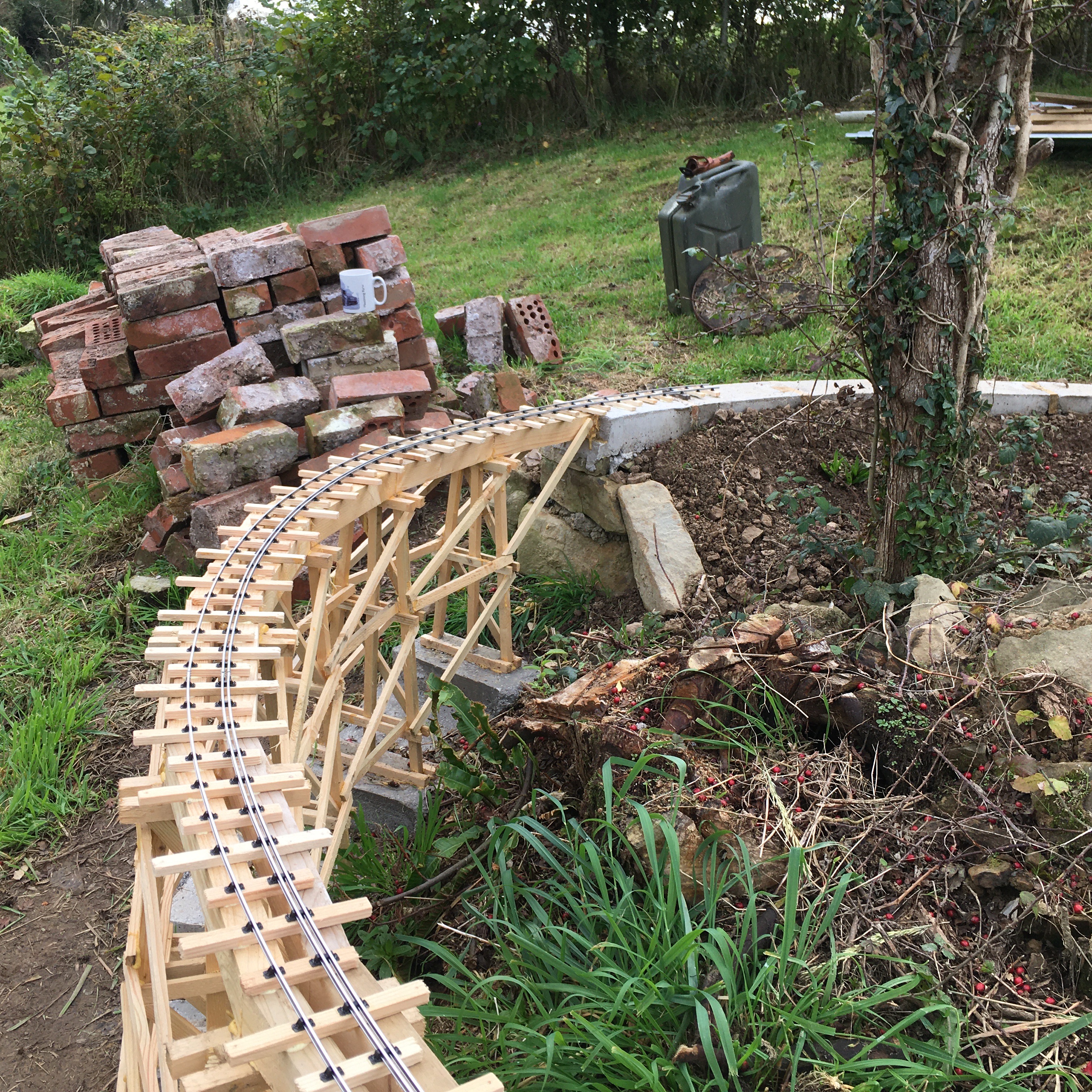

Going back to progress on extending the railway.
The track has now reached "dry land" at the other end of the viaduct:
and I am thinking about the passing loop. The first point offered up to see if it fits:

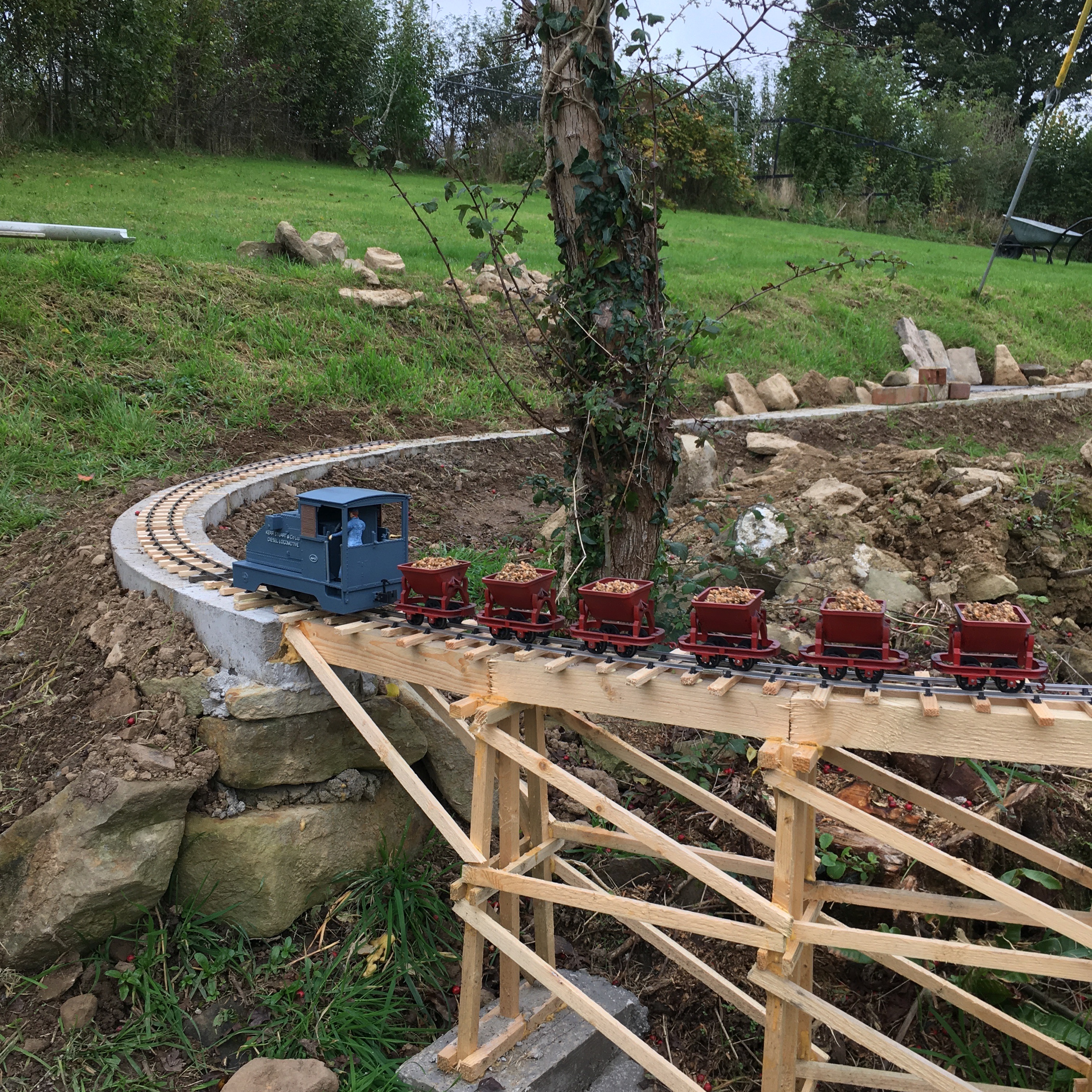

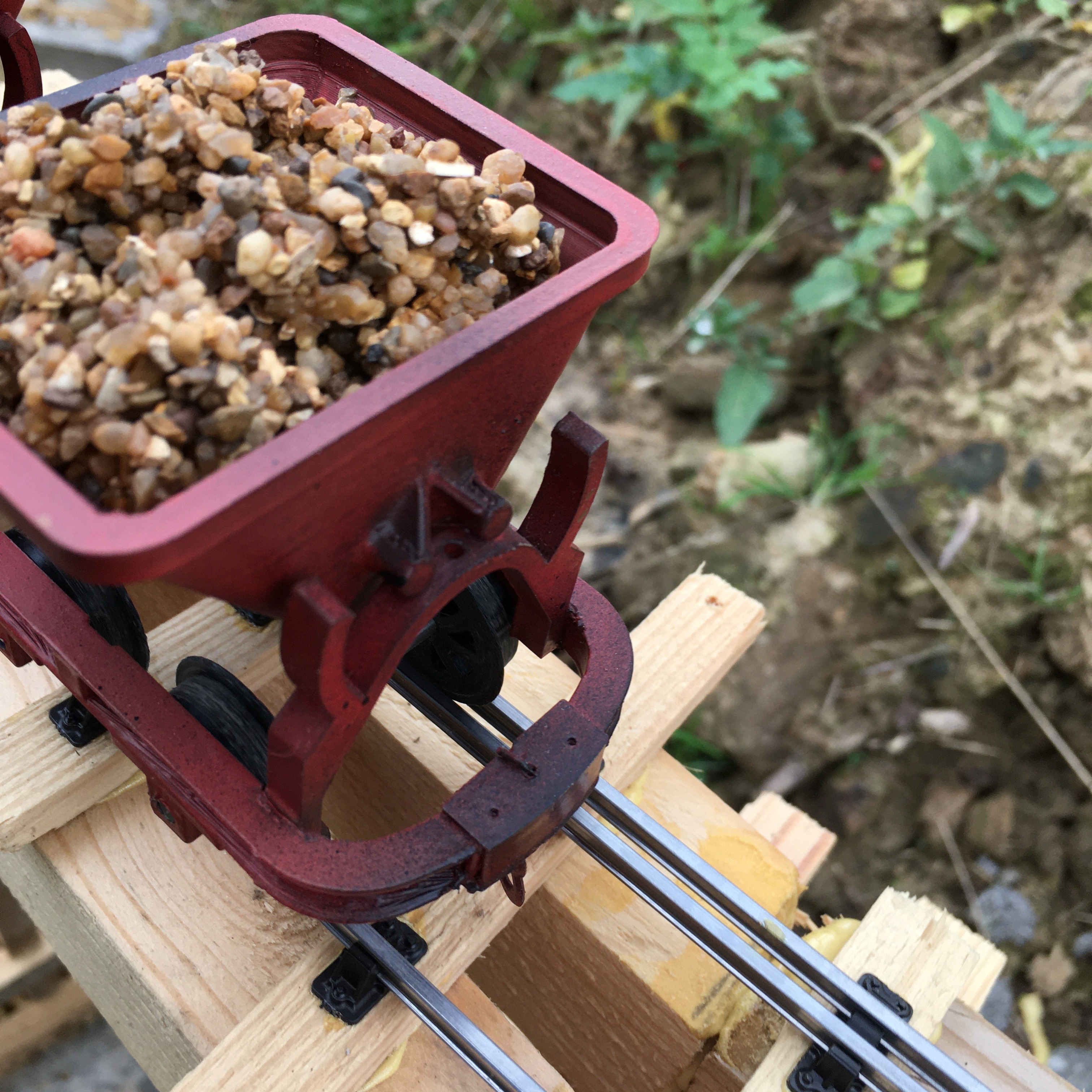

Testing the track on the viaduct:
The first train to pass all the way from one end to the other.
and to arrive on dry land at the other end.
Next stop the passing loop and Dduallt station building.
