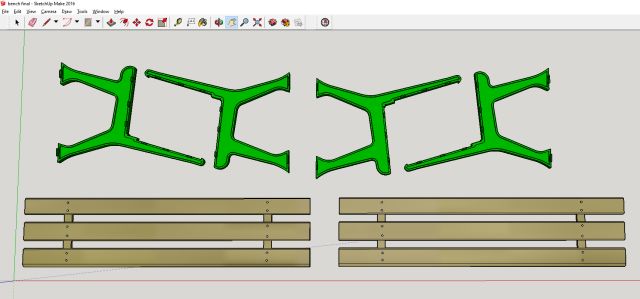

Hi all,
Thought I'd join in the fun so have downloaded and am currently playing with Sketchup - I can see the potential, but I think I've got a lot more tutorials to watch!!!
Push/pull and offset tools are fun, but I'm currently struggling to combine the two in a way that ensures that shapes I create are solid... I'll let you know how I get on!

Andrew, Push/pull is essential, but I didn't get to grips with the Offset for quite a while and don't use it that often even now. It's useful on curved shapes but for rectangles/straight lines it's just as easy to simply measure and draw straight lines. "Follow Me" is also very useful as are the two "Intersect Faces With..." tools.Andrew wrote: Tue Oct 13, 2020 5:55 pm
If I can help feel free to PM me.

That is interesting. The push pull I use all the time. The offset I have never used. I haven't found the follow me to be much use. When I want it to follow around a curve - bent pipes for example it doesn't work. No idea why. I also tried to make a ball with it and that didn't work either. I came to the conclusion that it was something which only worked properly in the paid version.

It does work but I suspect it is very unforgiving of the geometry it is being asked to follow and then it says something about the path not starting or ending correctly, or a couple of similar messages. I have found that curves don't always select properly and it is necessary to highlight some or all of the individual segements.Trevor Thompson wrote: Wed Oct 14, 2020 12:44 pm Andrew
Take a look at https://gardenrails.org/forum/viewtopic ... 15#p140475 and then read my follow up reply to Peter Butler at 2pm the next day.

Something I was trying to demonstrate to somebody else:
Draw the line in the shape you want, then draw the cross-section you want ( make sure it is touching the end of the line)
Select the line ( make sure you get ALL of it)
Select the Follow Me tool and click on the cross-section shape... magic happens!
BTW, the two versions show the difference between the default 24-segment circle on the rhs and a 96-segment circle on the left.
