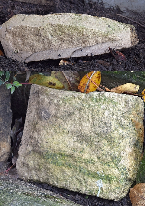

Good luck anyway. Certainly up here in the damp Northwest, those stones are no longer that colour! This is what they had 'mellowed' to last year. In fact, the green of algae or whatever is getting more prominent as time goes by.

Ahh, the Midlands damp is obviously more efficient than Northwest damp, these are a couple of the stones I was angle-grinding just back at the beginning of September this year! :lol:
That is a nice shot of your train, BTW.

It doesn't take long, does it? If the sun's out, that wall has the benefit of full UVa and UVb radiation in the afternoon. Maybe that helps control the algal growth?

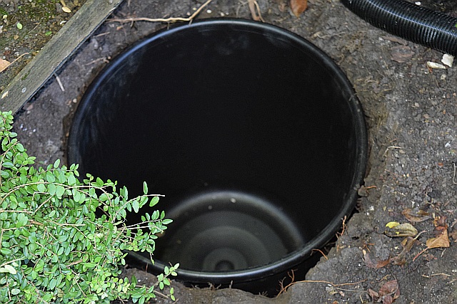

I just had to larf a few minutes ago!!!
Just having a passsing look around the garden, seeing how many bulbs were coming up, etc, and something caught my eye, the stream sump dustbin seemed a bit higher in the ground than when I last went near it. "Oh good" I thought, "the rain has settled the soil round it so I can top it up a bit.". Then I realised that there wasn't actually a gap, just the top of the bin about 2" above the surrounding soil level. So I bent down and pressed it down until it stopped, but as soon as I let go it gently bobbed back up again. The rain has filled the bottom of my hole, excavated from the solid clay, and the empty bin is actualy floating in a pond of its own. :lol:
Somebody did ask if I was going to use a liner for the stream....! :!:

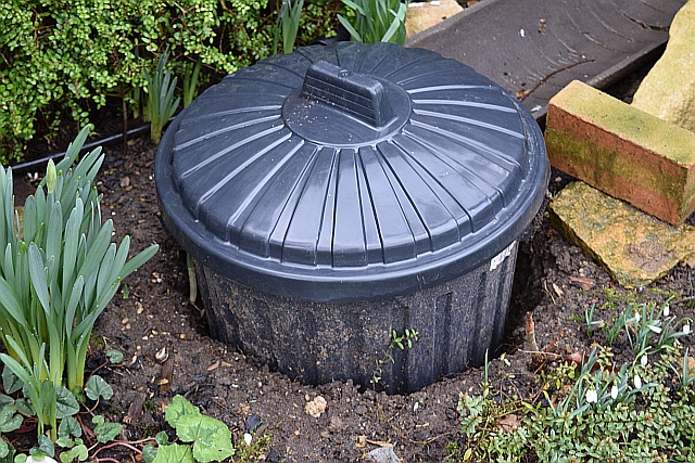

I haven't been entirely idle over winter, in fact I've achieved more than I thought I would be able to.
Firstly, to return yet again to my clay 'soil', sorry but this amuses me :lol: . When I dug the hole for my dustbin sump, I had it fitting quite nicely with the top at soil level.
As I said a few posts back, one day I noticed that it had lifted up and discovered that there was water sitting in the hole and the bin had floated up a couple of inches.
The weather dried up somewhat and eventually it went back down more or less to where it had started.
Then it rained again and this is the result:
That went down again eventually, although not quite to the bottom. Yesterday I put two large concrete ridge tiles in the bin, last night it rained again and this morning it is floating with a pronounced list to one side!
DSC_0001 (2).JPG (245.29 KiB) Viewed 32135 times
Before anyone suggests it, I don't want to put water in the bin yet so that I can adjust heights etc to match the end of the stream bed, when I get that far. I'm just hoping that in due course the bin full of water, plus the weight of the pump, plus the weight of the pebbles on the lid, will be enough to counter the upward water pressure collecting in the hole in subsequent winters!

You certainly are having some issues with that sump Phillip. I think I would be pulling what little bit of hair I left out because of it. But I am sure you will overcome it.

Looks like things are progressing well. I never had an issue with my bin floating upwards, but maybe my water table is lower than yours. Also, I got my stream up and running fairly quickly, so it was filled with water almost from the word go.
For a while, I ran it without a cover - but was alarmed to find a dead hedgehog floating in it one morning. Spurred me on to get it covered that day. I then found a few drowned frogs in it when I cleaned it out at the end of the season. They must have somehow squeezed in through the hole for the pipe from the pump. I now make sure I keep the sump topped up and have provided frogs with an escape hatch in the lid. Since then (about twelve years ago), I have found no more drowned wildlife in the sump.

Soar Valley Light wrote: Sun Mar 24, 2019 8:17 pm Is the bin a full sized (four foot(ish)) one? Does your stream drain away completely once the pump stops?
Hi Andrew, no it's not a full sized one, its a 70 litre. Can't remember the dims off hand and I'm away for a couple of weeks, will check when I get home.
Yes, in theory, if I get the gradient correct when I put the rocks and mortar stream bed down, it will drain completely. The soil level is currently flat from the bridge to the sump and the plan is to introduce a couple of degrees fall in the stream bed itself. More of that when I get that far. However I do have some issues with levels where the stream flows into the sump and I haven't fully resolved how to finish it yet.
Yesterday morning before we left, I managed to do a bit more and trim the liner more closely and put ( not fix) the bridge then run the pump so water flowed under it. No time to take pictures but it looked fine so far. I'll document it properly when I get back.

ge_rik wrote: Sun Mar 24, 2019 8:39 pm Looks like things are progressing well. I never had an issue with my bin floating upwards, but maybe my water table is lower than yours. Also, I got my stream up and running fairly quickly, so it was filled with water almost from the word go.
No I don't think its water table, we live near the top of a hill and there is a 20ft deep ex-LNWR railway cutting right in front of the house! The problem is soil permeability, this thick yellow clay simply doesn't allow water to percolate through at any great speed.
ge_rik wrote: Sun Mar 24, 2019 8:39 pm They must have somehow squeezed in through the hole for the pipe from the pump. I now make sure I keep the sump topped up and have provided frogs with an escape hatch in the lid.
Yes I saw you had done that on your blog and I have it in mind. I've been meaning to ask about your pipe/cable hole. Is it actually a hole, or a slot cut in from the side to allow the inverted lid to be removed easily? I'm a bit concerned that a slot would allow warping of the lid from the weight of the pebble topping, but it will be a 'mare to try to lift it up and slide it up the corrugated pipe. I'm thinking about a removable inverted-U shaped clip to hold the ends of the cut rim together.
