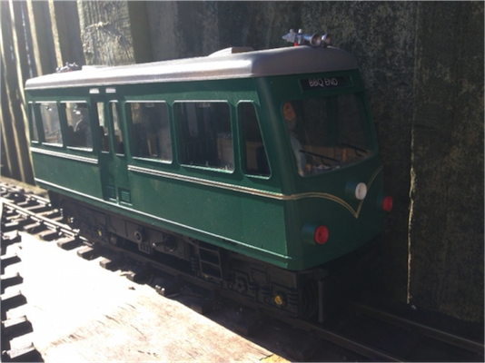

A quick update - now managed to sort the flanges and gauge issues - pics of a quick proving run up and down the line this weekend - sits nicely on the The Tesco Online Construction Express chassis - just need to sort some steps in for passengers like Jim's
Video to follow

Re: Railbus for the PMR
Post by Big Jim » Sun Feb 18, 2018 7:43 pm
That does look good.
