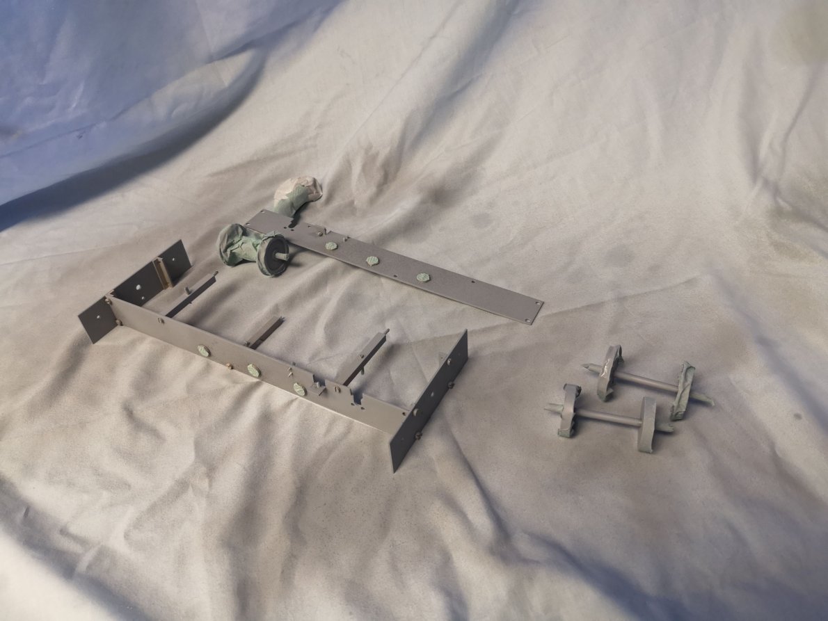

Frames etch primed and painted in Dupli-color black engine enamel:
Cranks quartered and pinned. This was a daunting process. I've so far avoided drilling and pinning the return cranks on my Lady Anne, and the timing has never slipped. However, Dylan has the early round axles and cast cranks, all of which are pinned together once the quartering is set. Once I found the right size drill and punch it wasn't too bad. The roundhouse instructions suggest ultimate accuracy is unnecessary and if they look quartered by eye it's good enough. I guess I was slightly off since I had to file out the connecting rods slightly to get it to run without binding, but we got there, and I suspect I could manage my Lady Anne now too.

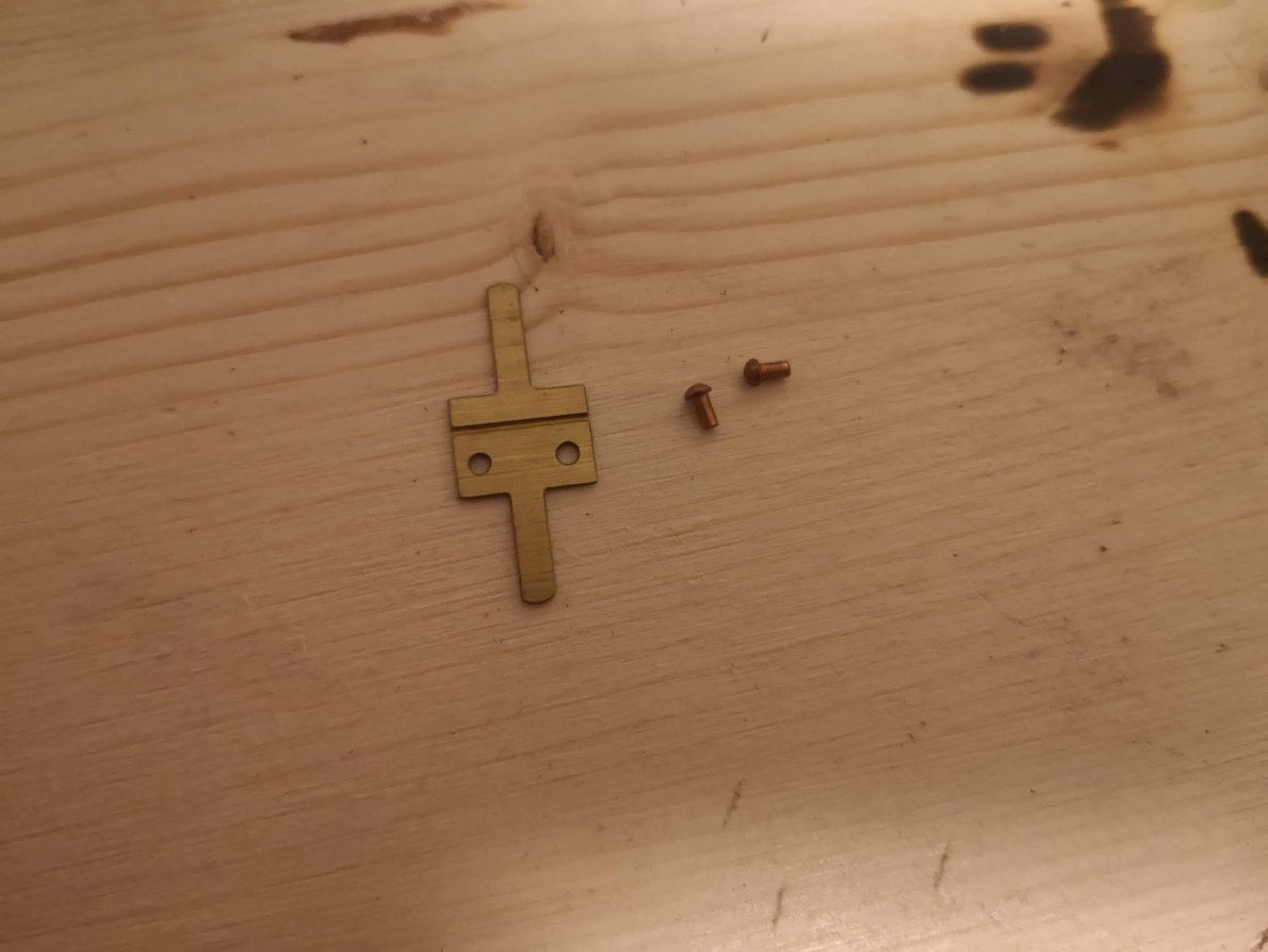

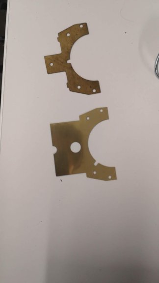

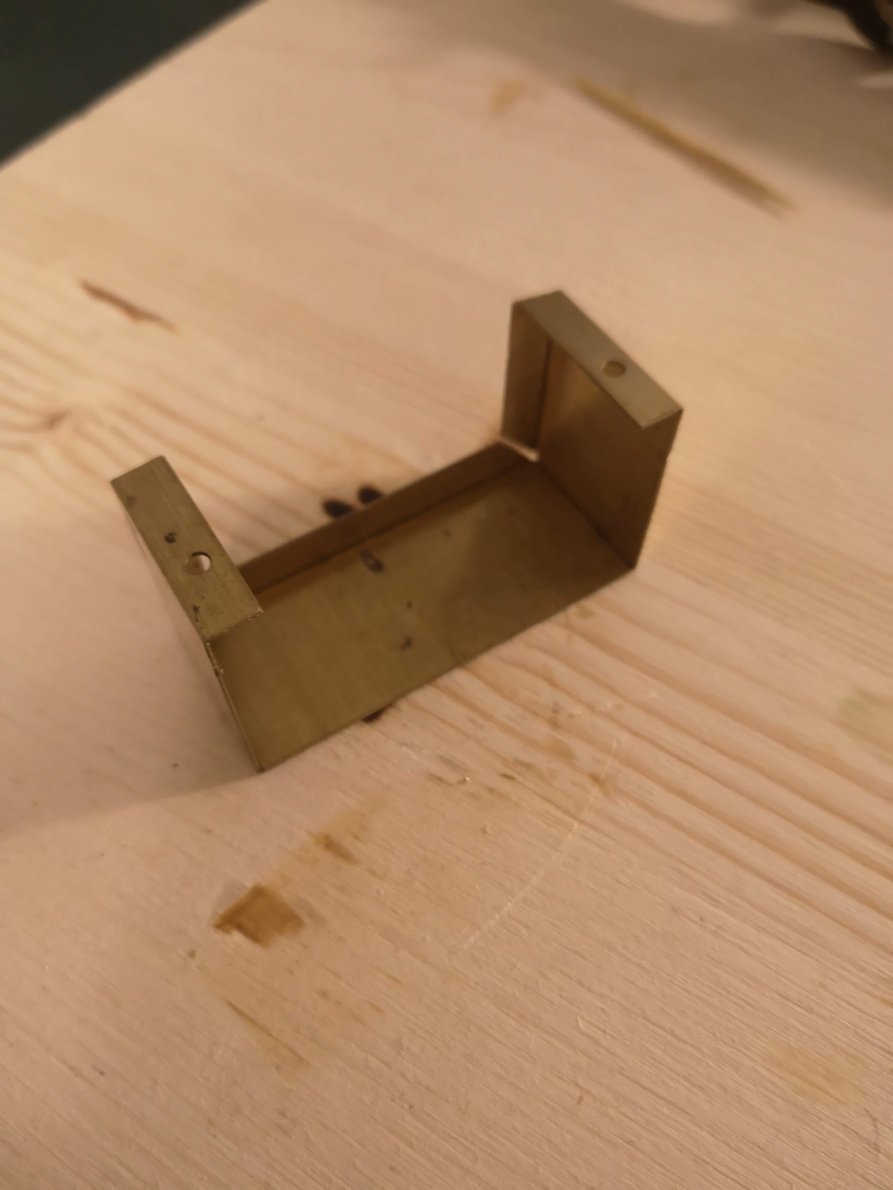

I decided to bite the bullet and get to soldering the bodywork. The cab and side tanks were basically the same as my Lady Anne, so no surprises there. The smokebox and saddle tanks took some creative setups to clamp everything in place whilst I soldered everything, but it wasn't too difficult:
Roundhouse don't have the instructions for these older models anymore, but I'm muddling through. It looks to me like the rear lamp brackets are intended to be fixed on using these 'rivets.' The only way I can think of fixing these is by hitting the shaft of the rivet from the backside in order to round it over though?
The other mystery is what I believe is the battery box. I think it goes on the underside of the cab roof as on my Lady Anne, but it's a very different shape, and I'm not sure how it accommodates the likely 4 AAA batteries...?
I did have the realisation that, in with all the screws are what I thought were 2 1" 6BA hex head screws. In fact, these are two lengths of 6BA threaded rod with nuts on the end. I guess either Roundhouse's or the previous owner's intention was that these each be cut in two 1/2" lengths for mounting of the cylinders. However, the limited space between the frames makes me a bit nervous about this approach as there isn't room to get pliers or other tools in there should I need to extract something, so I'm inclined to be patient and wait for the right screws. BA screws have been procured and should be with me in a couple of weeks. Might tackle some painting in the meantime...

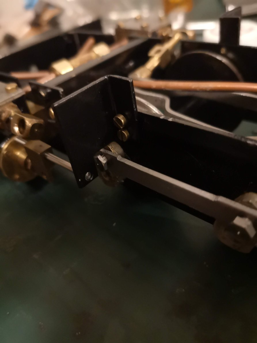

A care package arrived with some 6BA bolts courtesy of my Dad, so the cylinders were mounted. Upon mounting the motion bracket these fouled the front cranks, so some material was filed away for clearance. This has been one of the biggest differences between building this and my modern Lady Anne. Roundhouse were clearly more of a cottage industry at the time, with everything being handmade with quite a bit of variation. Nothing the file couldn't fix.

With the cylinders mounted, I could now set the valve movement and timing via the eccentrics. I confess, this is probably my favourite part of building a loco as it's very satisfying once you get an understanding of what's going on and therefore how to adjust things to optimise performance. With a few tweaks, and liberal oiling, I was able to get the chassis to run on air remarkably smoothly in both forwards and reverse using the old bicycle pump method.
Whilst pleased, this actually surprised me as the chassis still feels very stiff when trying to roll it by hand. So much so that one of the wheels came unglued from it's axle when I tried to reverse the direction of the eccentrics. $#^#$%^!!!
So I had to buy some penetrating Loctite after-all. Permatex is a more common brand over here. The equivalent to Loctite 603 is a sleeve retainer 64050. There are two products, both called sleeve retainer, with 64050 being much less viscous, and therefore more suitable. With this fixed, and a bit more effort, here's where I'm at as I type:

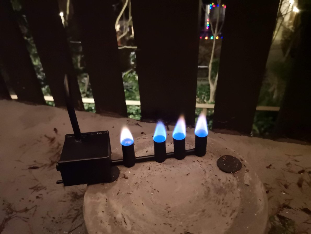

Next, onto setting the wicks in the burner. I decided to discard the original asbestos string wicks in favor of a modern equivalent. The included "Roundhouse Guide to Spirit Firing "was very helpful here. One thing I found helpful was to actually let the burner run dry once or twice before the final setting of the wicks, as the ends of the straggly bits of wick tend to get burned off, which calms the flame down considerably.
So, at this point, I'm ready for a steam test! I will leave this for the weekend however when I have more time and daylight.

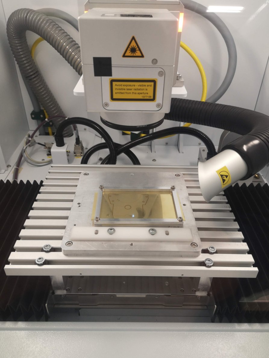

You really have done a superb job with the laser engraver/cutter Ted. You persistence will have its rewards with a very fine and excellent loco when you have finished it. :salute:

Appreciate this. My only experience of meths firing to date is with the old mamod trays, so setting wicks was new to me. My wicks actually sit slightly below the tops of the tubes, but the Roundhouse instructions say they shouldn't be "more than 1/8 above" the tops, so I guess I'm ok? Sort of? Certainly seems the flames are giving the appropriate size & color...
There's also a lot of debate about what fuel I should be using, as nobody sells "methylated spirits" or "denatured alcohol" here. Best I could find was "methyl hydrate" which sounds like it has a much higher methanol content than stuff used in the UK. Again, we'll see how it goes!
Re: The Reading and Squamish Light Railway Stock Thread
Posted: Sat Jan 23, 2021 12:12 pm
by GTB
big-ted wrote: Sat Jan 23, 2021 4:22 am There's also a lot of debate about what fuel I should be using, as nobody sells "methylated spirits" or "denatured alcohol" here. Best I could find was "methyl hydrate" which send like it has a much higher methanol content than stuff used in the UK. Again, we'll see how it goes!
Methyl hydrate is one of the older names for Methanol. Also known as wood alcohol and methyl alcohol, among numerous other names. Methanol is the correct chemical name though.
I would imagine methylated spirits/denatured alcohol supplies have dried up with the ethanol being diverted into making hand sanitiser. That said, here in Oz you can still buy methylated spirits from the local supermarkets and hardware stores.
I've read about methanol being used in small steam locos, but it wouldn't be my first choice of fuel.
1. - it's very toxic. A fatal adult dose can be as low as 10ml and only 5ml can cause blindness. It can be absorbed through the skin as well.
2. - it has a lower heat of combustion than ethanol. What that means in English is that, relative to ethanol, you will need to burn a third more methanol by volume to boil a given amount of water.
I guess that the burner would need to be set up specifically to use methanol. Maybe by packing the wicks less tightly, so the methanol burns faster.

Hmm. Very interesting. Thanks Graeme. Yes, I was aware that it had at least a much higher methanol content. I suppose it makes sense that methanol is more readily absorbed through the skin than ethanol given its a shorter molecule.
My other options seem to include a naptha (petroleum) based stove fuel, lacquer thinner(!) or I did find this stuff:
https://www.staples.ca/products/2980779 ... kcQAvD_BwE
It claims to be 80% ethyl alcohol, but it also claims to be moisturising. & It's eye-wateringly expensive...
Needless to say, none of these options seem appealing!

Methylated spirits/denatured alcohol is about 95% total alcohol. Apart from the stratospheric price of hand sanitisers, they don't have enough alcohol to make a decent fuel.....
Some campers/bushwalkers still prefer to use spirit stoves, instead of gas. Check the local camping/outdoor shops to see what fuels they have available. From a few things I've read, I suspect that in North America spirit stoves are set-up to burn methanol, as it's difficult to get suitable ethanol based fuels.
The way forward is probably to set your burner up to use methanol. Petroleum fuels like naptha, kerosene, etc. don't burn cleanly in a burner designed for alcohol.
......unless the local moonshiners can supply 190 proof white lightning. 8)

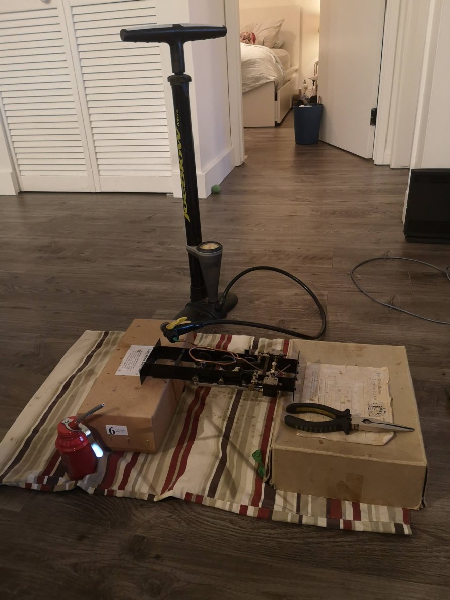

Well, the first steam test was....
A total failure.
It gets up to pressure, but opening the regulator just sends jets of steam out the exhaust pipes & the wheels show only mild inclings to turn over.
On the one hand, I'm not surprised, as the chassis feels very stiff. To the point where one has to press down on it to generate enough friction at the wheels when pushing it along a block of wood. This is in stark contrast to my Lady Anne which positively glides along. There's also a few obvious steam leaks around the valve chests. Again, not surprising given the seals have sat dry for 20+ years. I have a cylinder rebuild kit ready. But it runs so well on air?! Granted, the gauge on my bike pump isn't super accurate but past experience suggests it over reads, & everything turns over smoothly at 20psi?!
Also the matt black paint I used on the firebox (Tremclad high heat) is garbage & wiped off as soon as I wiped off the first drops of hot oil with a cloth...
So... I think I'll strip off the boiler & see if I can free things up a bit, rebuild the cylinders, then try again. Next weekend...! :D
