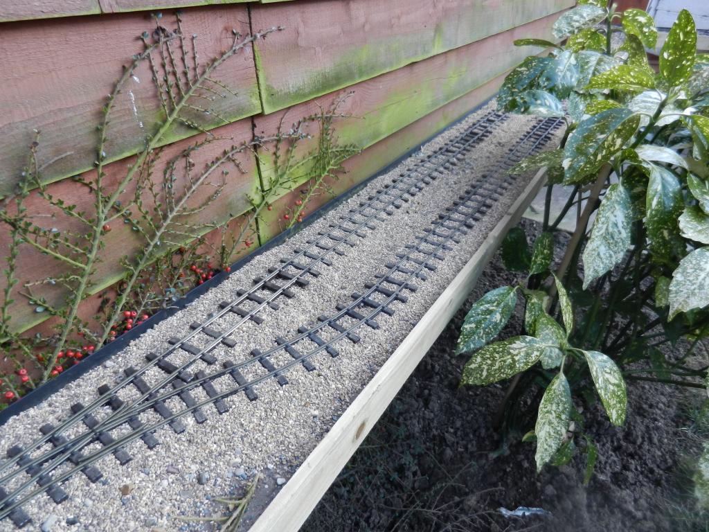

The use of waterproof pva has been successful in fixing ballast to trackbed. This has also protected my timbering sleepers from rot. I dont recommend it for actually fixing track to the trackbed though it does help additionally. This summers has been hot and some expansion has occured thoughthis has not affected the track so it appear to be flexible as well
Post by tom_tom_go » Tue Sep 17, 2013 8:58 pm
I use 3mm Dorset pea shingle from an aquarium shop and just add it loose:
(old photo as this was before the summer and I just poured it on quickly to see what it would look like)
METHSSNIFFER
Post by METHSSNIFFER » Tue Sep 17, 2013 9:43 pm
That looks the job! Nice one. It doesn't have to be laid with pva it just keeps it down. If you are in plentiful supply it keeps your ballast wagons topped up
