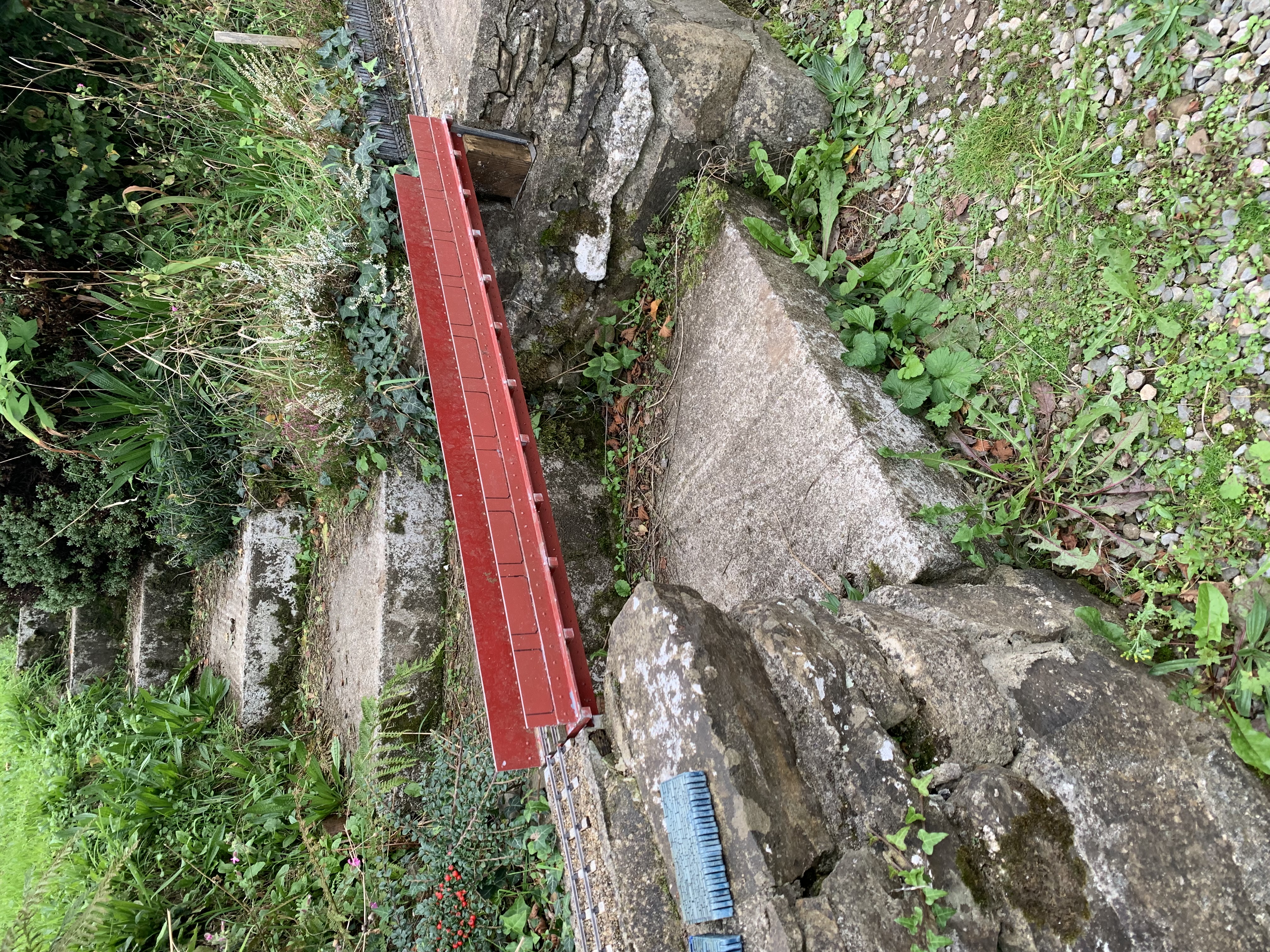

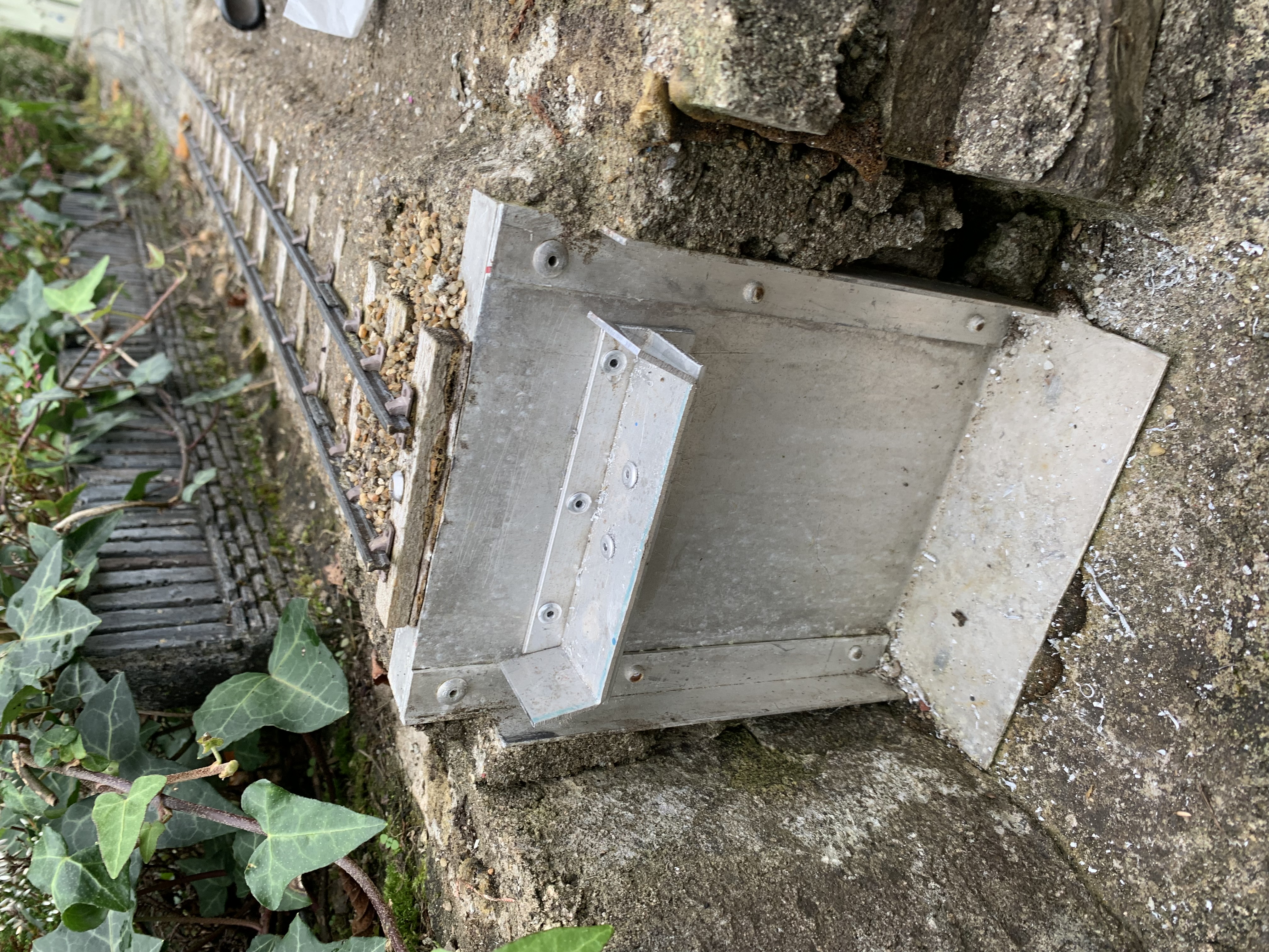

The first stage of modifying the existing bridge (so that it lends itself to becoming a bascule bridge) is complete. That box section underneath the deck has been removed (with the handrails and walkway which were rotting). It has been replaced with the same alloy sections cut in half and fitted on to the top. It is lighter, which will reduce the balance weight slightly. The fittings to locate it have been replaced:
The bridge locates onto alloy sections, riveted to the abutments:
The bent bits are exactly the width of the bottom rails so they locate the bridge both up and down and side to side, ensuring that the rails line up accurately:
So in the short term the bridge is usable. Hopefully when it raises and lowers it will drop back into these locations ensuring that the rails continue to line up. Painting can wait until the assembly is complete.
I can now add the lifting mechanism, which is partly made.

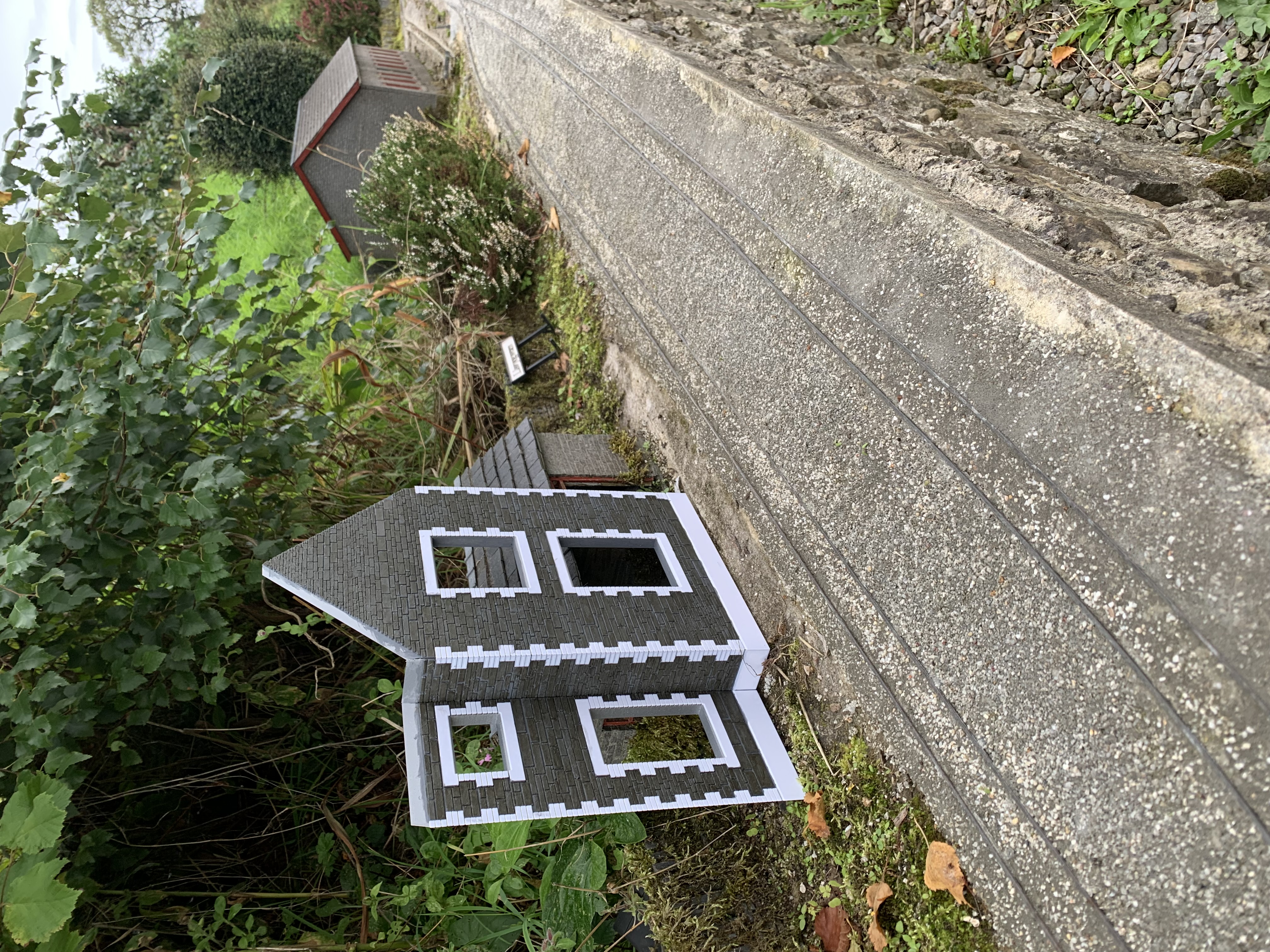

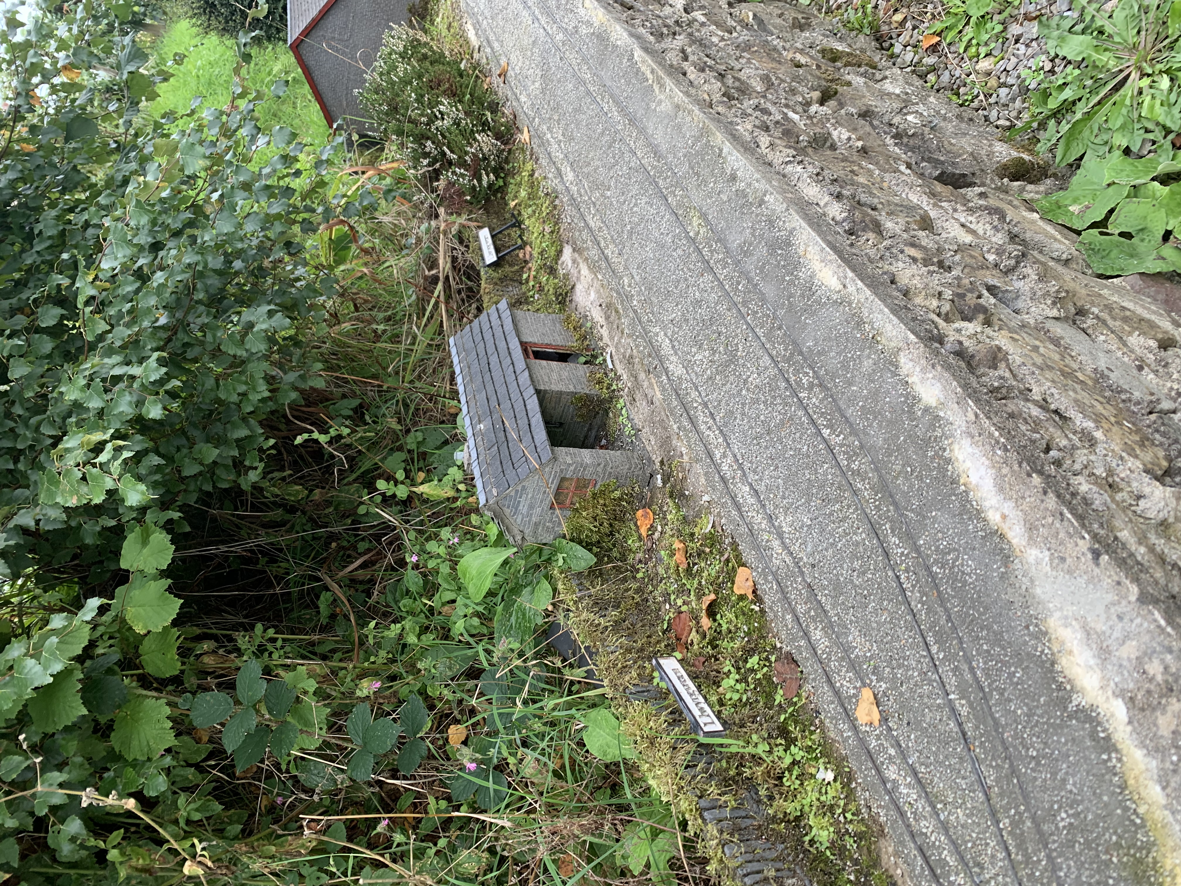

Just down the line from the bridge is the second station on the line. The building there is the first one that I built, based on a Coris Railway prototype. Slate blocks bonded together with tile adhesive on top of a plywood former:
It has been outside since it was built and both the door and the ply framing have disintegrated. Rather than repair it I have started to make a more "Ffestiniog" themed replacement:
During the winter the area behind it will be cleared and that tree pruned severely, so that a larger concrete platform can be put in place to take what will be a large station building (I am sure you can work out which station building this is based on).

I would have left out the horizontal bottom part as it tends to collect dirt, leaves and other stuff, keeping the middle section from locking in place properly. Just the angled sections will do, perhaps with a bit of reinforvement.Trevor Thompson wrote: Fri Sep 25, 2026 9:38 pm
