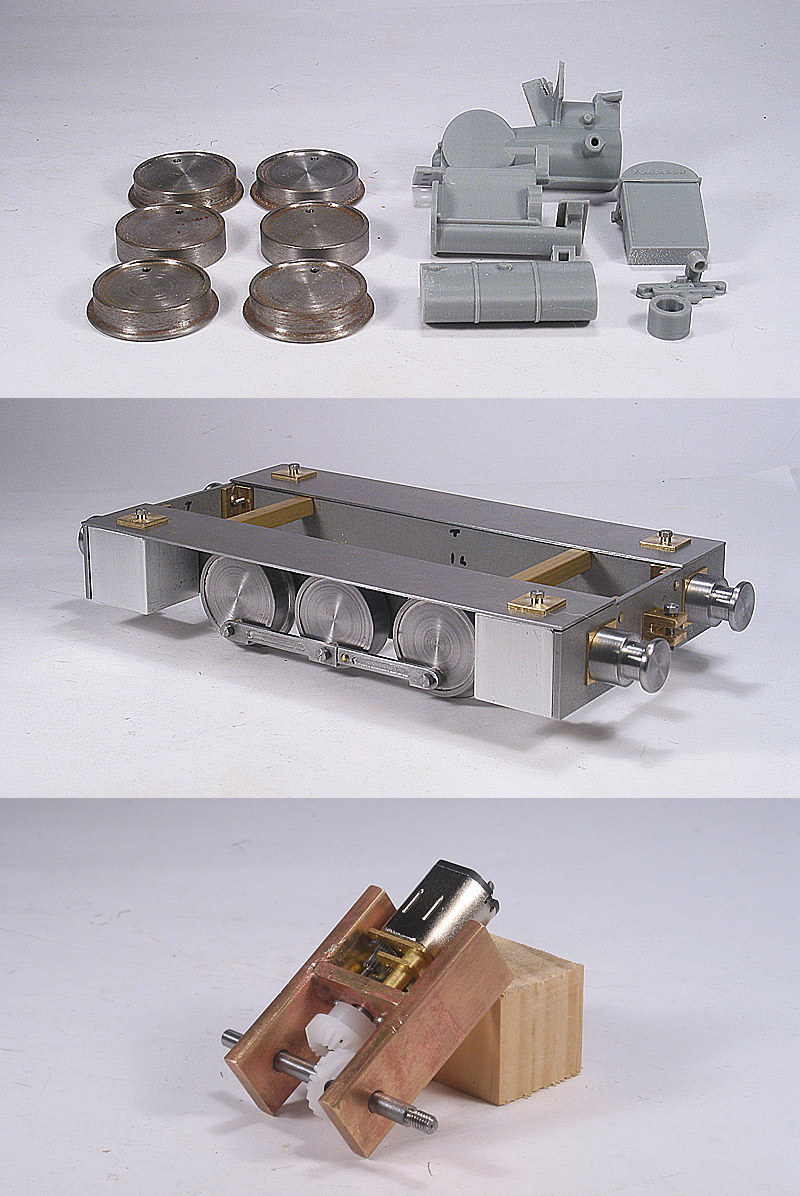

The consequence was that work started on the model rail tractors, beginning with turning the wheels. No research needed, as that was done years ago and the search results were already in the files. The models are based on one of the Days rail tractors that ran on Russell's timber tram that interchanged with the VR at Gembrook and ran to timber mills out along the Black Snake Creek.
The first pic in the composite photo shows the turned wheels and 3D prints for one tractor. The kit I saw had a tractor printed in one piece but the supplier decided to convert to a multi-piece to make printing easier. Fine with me, it made detailing a lot easier as the build proceeded. The 3D prints are hollow, so don't add anything much in the way of weight to the model.
The second pic shows a chassis ready to be fitted with the motor/gearbox, The design being built with my usual preferred methods and is basically a simple small diesel chassis. Designed to be nice and heavy for hauling a scale load.
The third pic shows the assembled drive minus the covers, ready to be installed and wired.
The chassis of the models is built as heavily as was practical, to get a drawbar pull high enough to pull a scale load. The motor drive is more visible than I'd like and there was no space to also fit rechargeable battery cells, or hide the on/charge switch, the charging socket and the rx-esc. These were built into the timber load on a pair of log bogies.

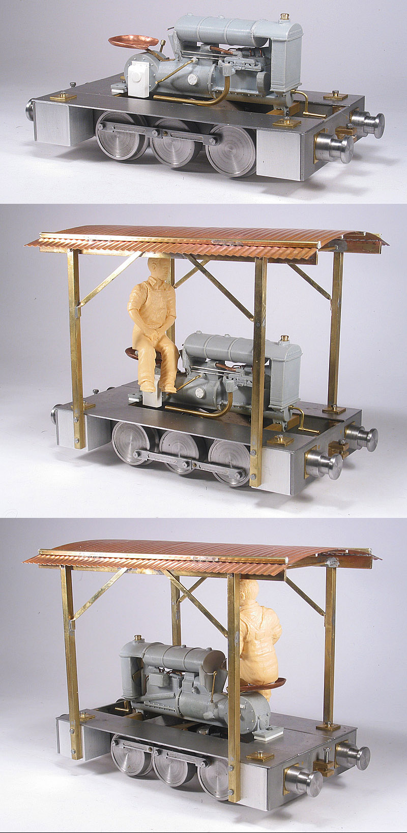

The first pic in the next composite photo shows a running chassis fitted with an assembled and detailed Fordson Model F print. The pressed steel seat typical of tractors was beaten to shape on a wooden former. Again copper shim was found to be much easier to form than brass shim.
Some of these rail tractors ran in this condition, not that the usual shelter did much except keep the sun off. There's an old photo showing one without a shelter, running on the timber tram at Tanjil Bren in winter. Some poor soul is huddled in a greatcoat driving the thing in snow up to the footplate.
The second and third pics show a completed model rail tractor with a driver figure temporarily fitted. Ready for the paint shop.
There seems to be no record of paint colours used on Days Fordson rail tractors when they were new. Preserved ones are in all the colours of the rainbow, so when the weather improves enough for painting I'll need to make an executive decision on the paint scheme.
The final weight of the completed model has come out at a 640g and the max. drawbar pull was measured at 150g during a bench test. So a single rail tractor should easily handle a scale load on the track.
