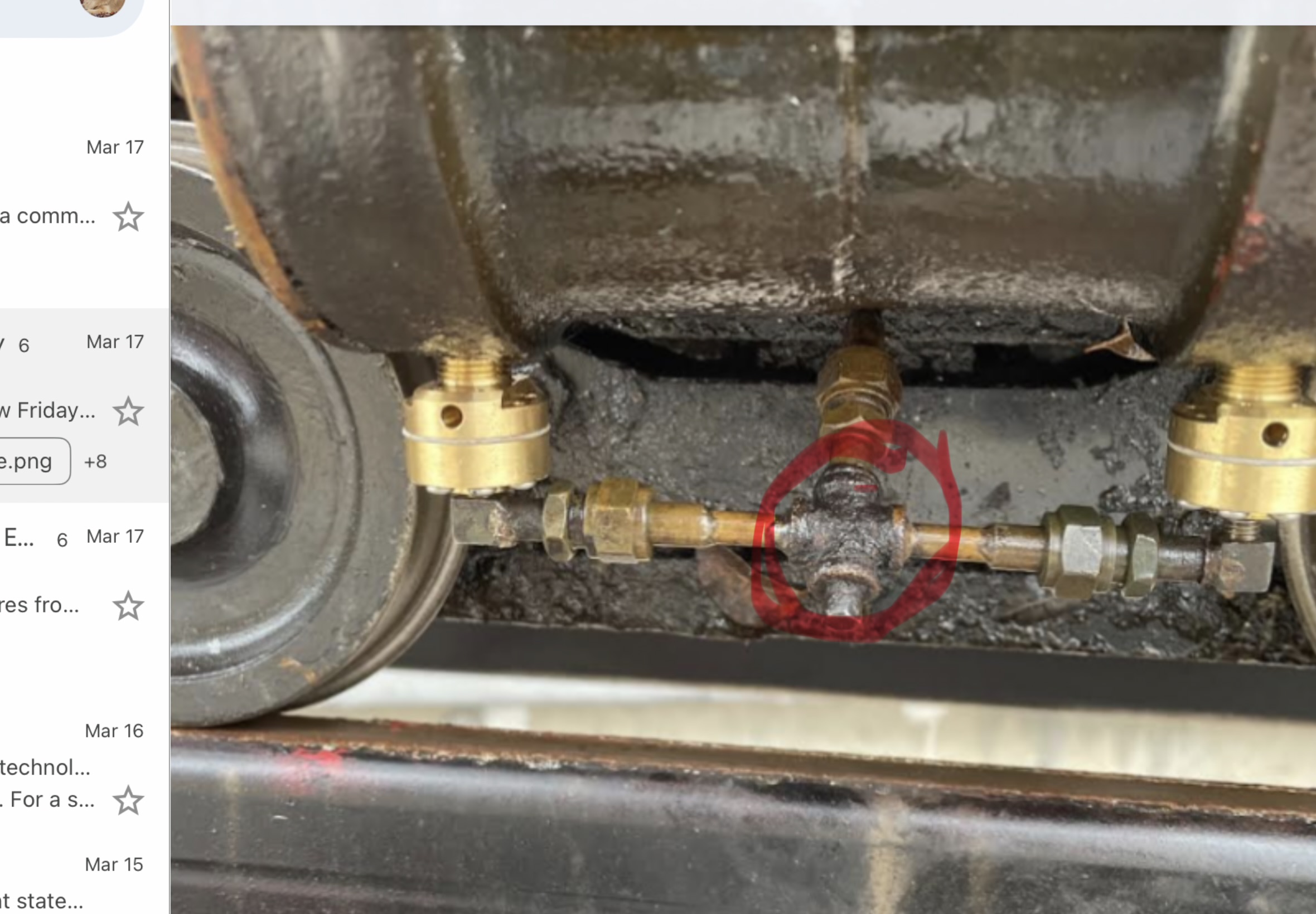

Greetings, can anyone ID this valve ?
Thanks
Geo 🇺🇸
GAP
Posts: 887
Re: ID
Post by GAP » Mon Mar 30, 2026 10:45 pm
I don't think it is a valve more like a 4 way joiner with one connection plugged, used to drain the system of sludge occasionally perhaps as it is on the lower side of the "tank".
Scrat
Posts: 299
Re: ID
Post by Scrat » Tue Mar 31, 2026 6:52 am
Seems to be a set of steam-operated cylinder draun cocks.
So the middle piece should only be a joiner.
I would expect another joiner like that under the loco, where the pipes from left and right cylinder come together and the "real" valve somewhere in the cab.
