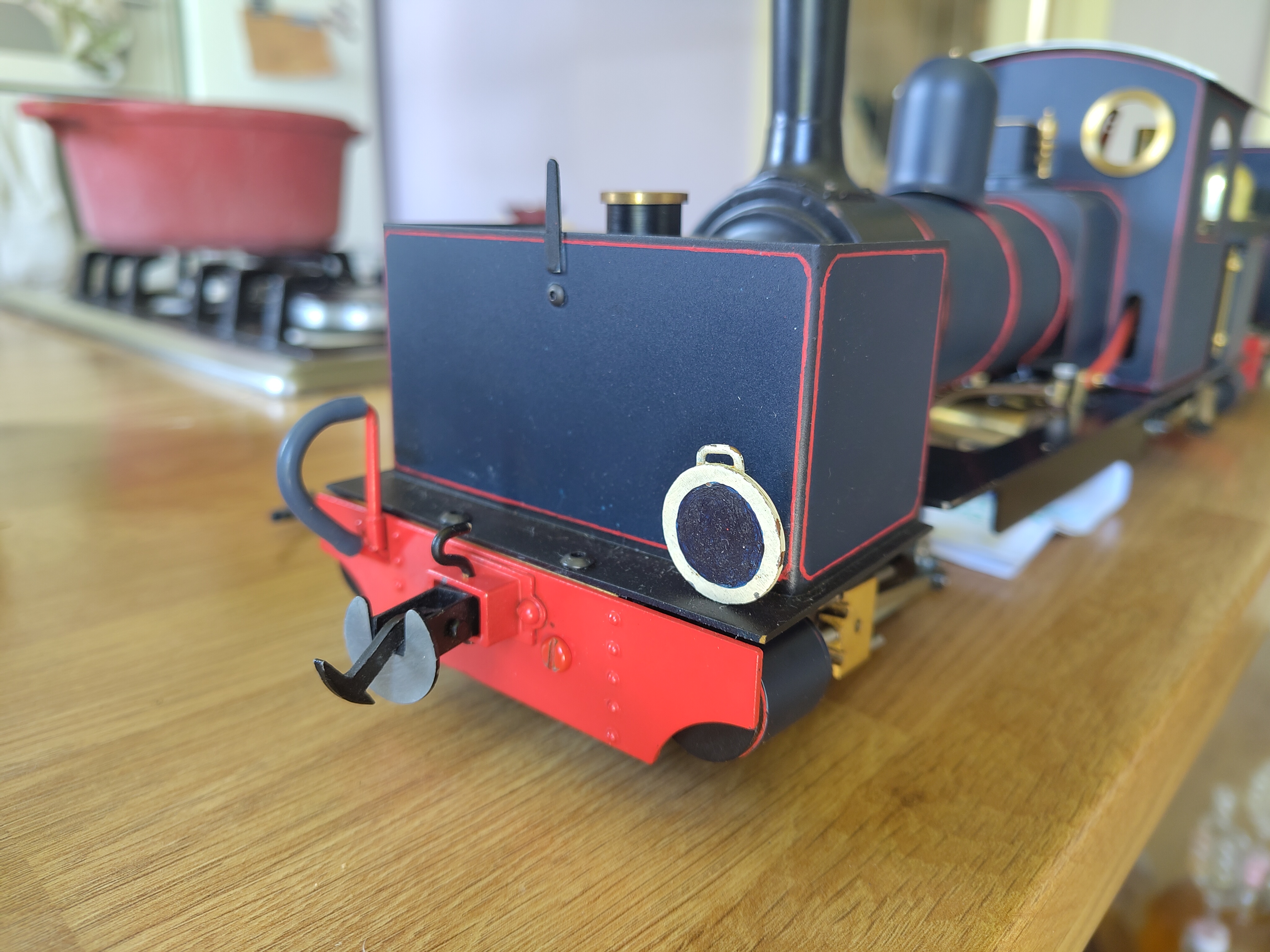

I've found that tenmille choppers are compatable, and most of the small brass versions, for example from brandbright, will also couple (but there tends to be a modicom of fiddling to get the blades to not clash.
Similar to others I've used Accucraft choppers on most of my stock as they are readily available (indeed, becuase some people prefer a simple buffer with chain I've managed to buy most of mine in big bundles second hand) and reliable and, crucially, they work very well when propelling.
What I've been doing to reduce the over-hand is to: Remove the spring, file the small button on the back of the pivoting part off, drill the pivot hole 4.5mm further back, then mill off the face of the pocket (could easily be sawn off then filed true) down to the back of the original hole. This reduces the length of the coupling by 9 mm if both halves of the pair have been modified which makes just enough difference to be worth while.
Seen here on the front of the garratt, a quick brush on a piece of emery cloth gives the buffing face a more realistic look.
