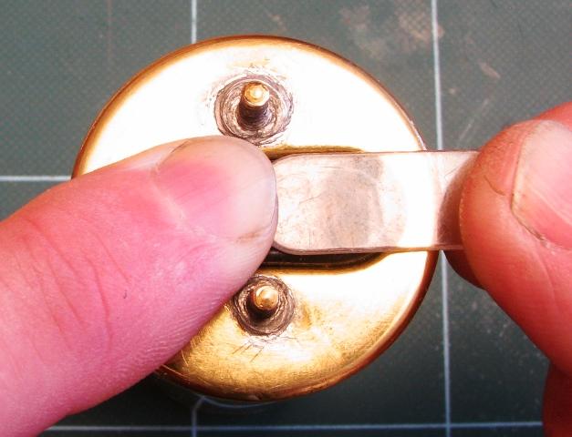

OK Sam, just tried it again so here are some amended illustrated instructions.
1. Put a light coating of oil or washing up liquid onto 'O' ring and push 'O' ring to fit in the boiler cut out. Hold 'O' ring in place with finger (I've not completely covered the 'O' ring with my finger so you can see what I'm doing).
2. Insert plastic sight glass between finger and 'O' ring and slide it down to completely cover the 'O' ring.
Keep finger on bottom of sight glass plastic to keep it and the 'O' ring in place.
3. Whilst holding the plastic and 'O' ring in place slide the brass back plate down over the plastic (my boiler is a riveted back plate version that has been converted to a threaded version so I cannot slide the back plate down any further - the trick is to have your finger in such a place that the slot in the back plate is now over the plastic).
4. With an appropriate tool in the slot holding the plastic & 'O' ring in place continuing sliding the back plate down until the holes line-up with the threaded collars. Fit screws and do them up equally snug - do not over-tighten as that will force the 'O' ring out of the boiler cut out.
Job done.
Chris Cairns.
