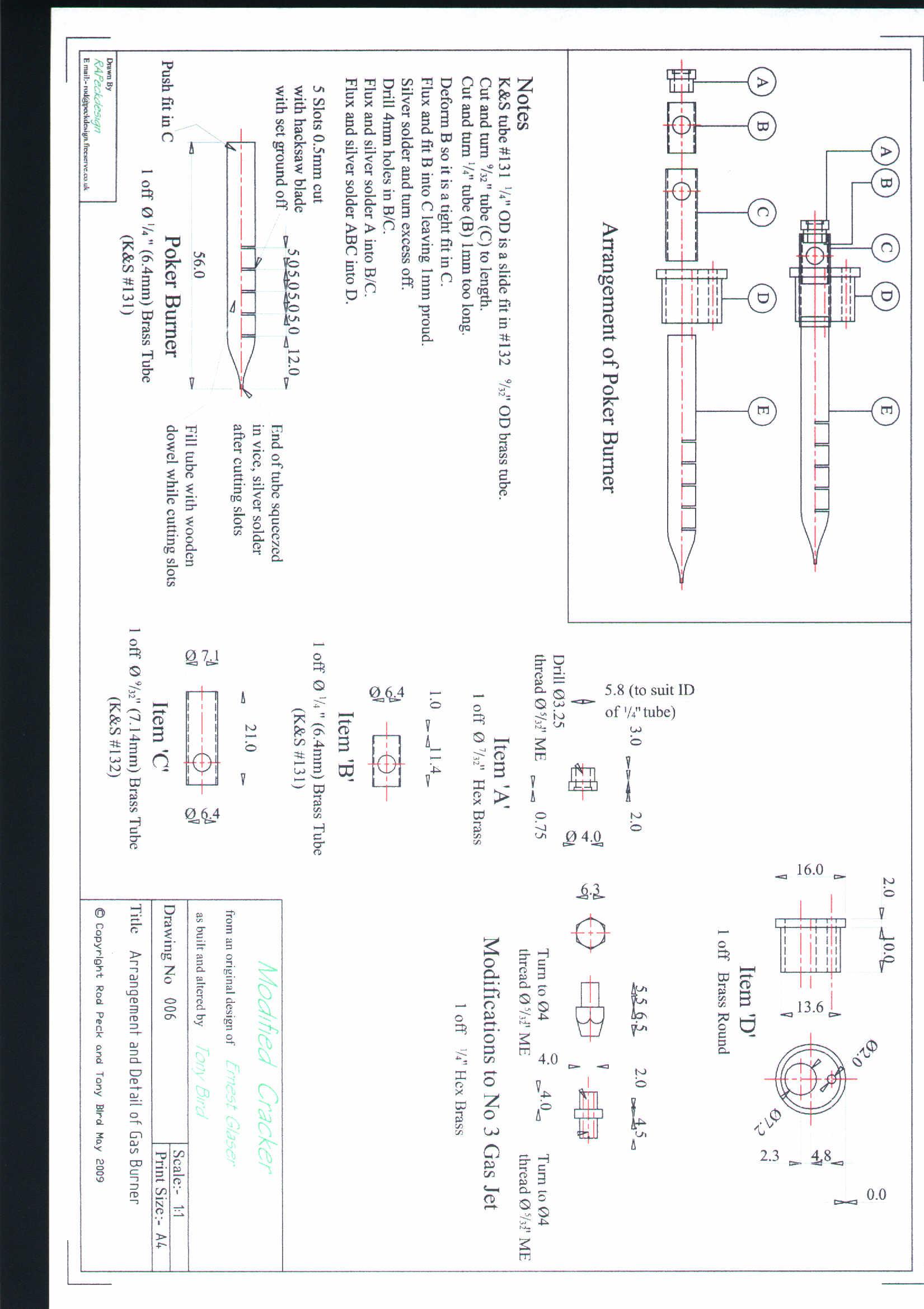

After more than 20 years under the bench (including a house move) my cracker has come to the top of the bench again.
Chassis is complete, Boiler also.
I am now making the cylinder and the components around it.
The only thing I do not want to build according to the plans are burner and tank.
Is there any "off the shelf" solution the other cracker-builders can recommend?
- Tony Bird
- Posts: 601
- Joined: Thu Jul 29, 2010 8:25 am
- Location: Cardiff, South Wales, UK.
Re: Playing with a Cracker.
Hi,
As far as I know there isn't a commercially made burner small enough to fit a Cracker. I hope I have attached PDF is the burner drawing I designed which might help you..
Take care Tony.
Take care Tony.
- Tony Bird
- Posts: 601

Sorry not the drawing that I hoped it would be I will try again. T

Hi tony,
thanks for the drawing.
I a just sorting out mistakes I made back then.
Now I have a well-running chassis. Binding has been dealt with.
I had to make new buffer blocks. The old ones were just filed. I made the new ones on my (tiny) mill and they are square. What a difference.
Made the cylinder yesterday.
I still hope to find some burner as I do not have the experience to make one.
My last attempt to copy the famous Falk burner turned into a pocket sized flamethrower.....
