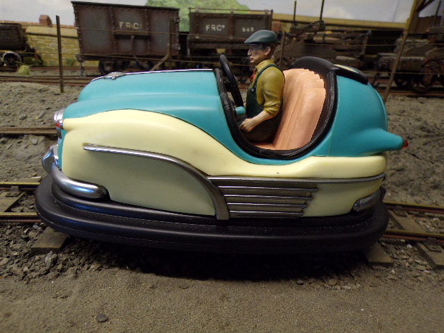

For those who follow the Quarterly Garden Railway Gallery (competition), this was my entry for 'Road vehicles on the railway'. From the one thousand, nine hundred and seventy three registered Forum members it won four votes of the total of seventeen cast! It would be nice to see more members taking part and show encouragement to entrants by joining in the fun. Everyone is eligible to enter.
However, the story behind this model is that was another eBay find listed under 'Novelty Radios' as it was Japanese built in 1970's as a working FM radio, also having working headlights. Mine was advertised as non-working with a faulty tuner pop-up section behind the seat and broken aerial (see picture below). A fully working, boxed and unused identical model is currently offered for £156.00, don't all rush!!!
Access is made by unscrewing the base-plate, which has no wheels attached, then after removal of all the radio gear, the pop-up section can be slid out, showing the damaged spring and clip mechanism. Some surgery is necessary to make room for the motor and gearbox under the bonnet, also for battery space behind the seat. I have managed to fit a 6v motor with PDF 3D printed gearbox driving steel wheels and 5AA batteries with RC trains Rx behind the rear wheels. A switch and recharge point are also fitted.
Driver figure is another from David Clavey...

It looks a lot like a Nash Metropolitan! I saw one of them on the road last week.
(My own crude FDM-printed HO scale model)

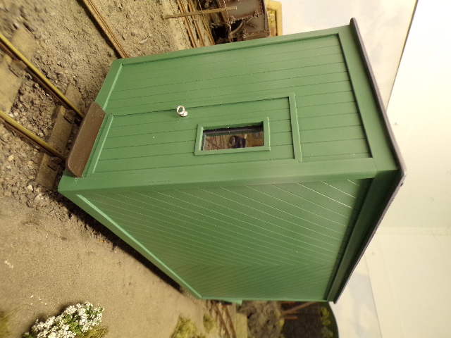

My latest build required some outside-the-box thinking, unusual for me... but worth a try. This time however, the box needed to be somewhat larger than usual to accommodate my proposed load.
Incorporating another novelty radio car chassis and bonnet etc, I set about constructing the vehicle and load compartment in the style of a Galloping Goose. There are so many varieties of these pictured in Google one more will go un-noticed....
By this time I had already constructed the proposed load so knew exactly the dimensions to house it. It needed to be a precise fit to look 'custom built'. The box came together quite quickly and I didn't find time to take pictures in the grey primer, so here is the structure in top coat...
Any guesses?
Any guesses?

Giraffe transporter?

Acoustic profile tester?
*WHAM!*
That bridge is a wee bit on the low side.
Profile measurement device?
Run it round the layout at max speed. The remining front wall of the green box gives you a pattern of the max allowed profile.....

A poultry enclosure big enough for a whole flock of galloping (actual) geese?
