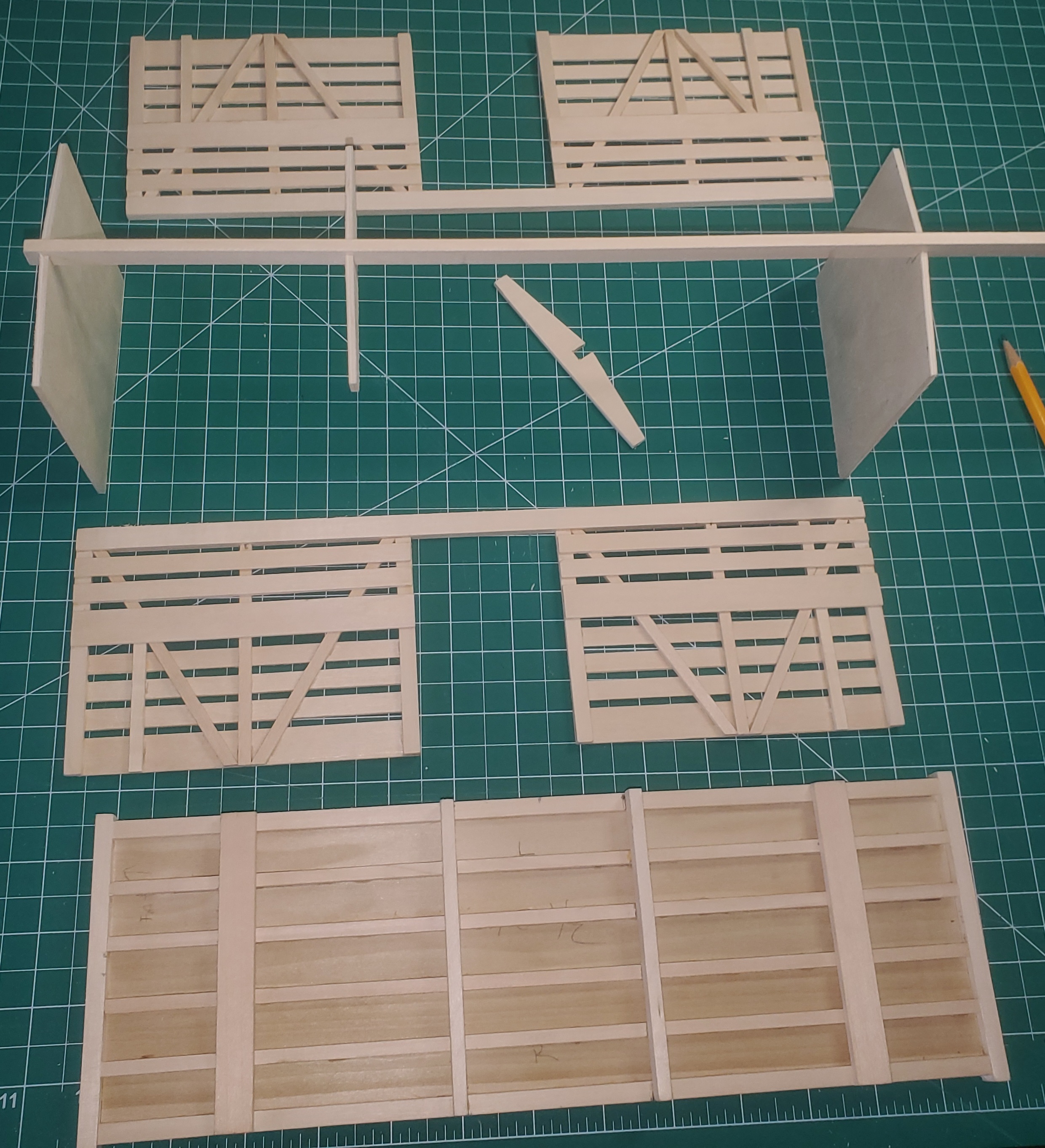

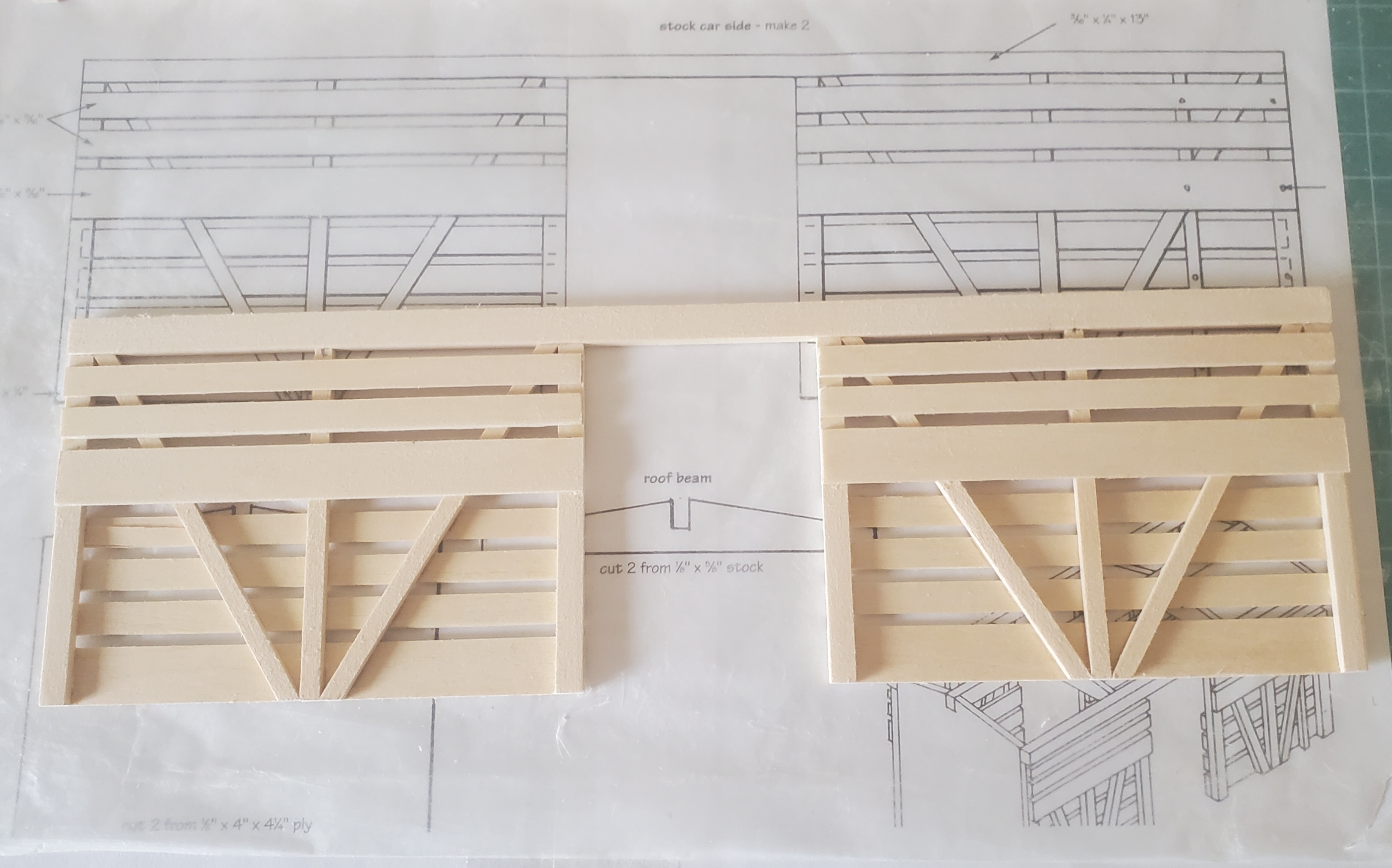

I started on a couple models now that we settled in enough to do something besides Homestead work.
This is a 1:20.32, 45mm gauge "Test Prototype" for my cattle line here in the high desert. It's being built from a Garden Railways Magazine "pull out plan" that Ted Stinson drew up back in the day. I've built several of his models including this one almost 20 years ago. Ted's models were all laid out in a simple fashion, most use a plywood core and the stringers and end beams are built around that. It gives the model weight and durability for the garden, carrying back and forth and all that. I may build the next one w/o the plywood and use full height center stringers and such, but for now I just want to get this one completed, stare at it a while and decide if I want to go this route, then build a jig so I can speed things up a bit, so that over time, I can produce 15 or 20 of these.
I may also build the same thing in 1:19.05 and see how it looks in 2 foot gauge form. But I'm leaning towards 20.3 on 45mm track.
Anyway, this is the basis for the railways' Series 300 stock car. I also have plans for a box car of the same length, which will be series 200. Most series of cars will ride on 3d printed 3' 7" American Steels' archbar trucks.
More to come....
More to come....

Bad Droid
- Posts: 103
- Joined: Sun Dec 17, 2023 4:03 pm
- Location: Loving the Boondocks
Re: Stock Car build for my cattle line.

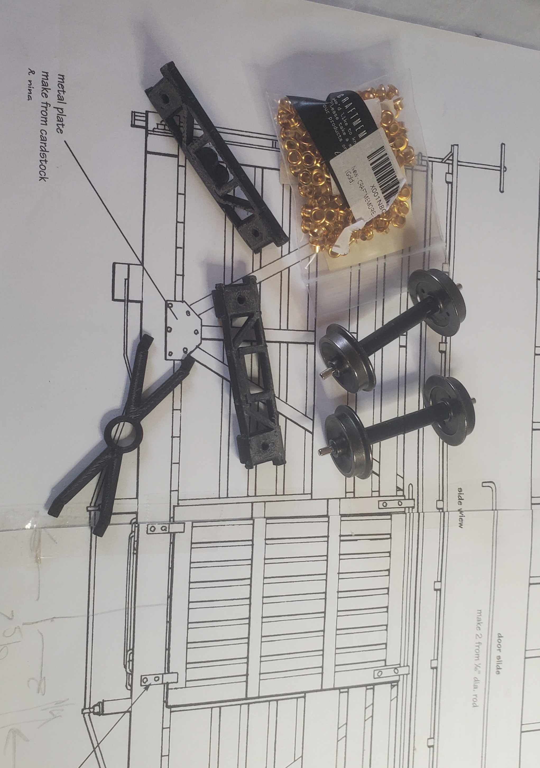

These are the arch bar trucks that I mentioned, I think they'll go great with the series 200 and 300 cars. The bolsters will be wood, the prints just don't come out right, even the designer gave up on that particular part. They'll still be fully sprung. I grabbed some wheel bearings, but at $11 for ten bearings vs 200 brass eyelets for $10, I'm leaning towards the eyelets to keep costs down. The wheelsets are a basic Bachmann "Big Hauler" type and are the most expensive part of the models. Most everything else is fabricated out of wood or 3d printed.
Feel free to critique, make suggestions or just point and laugh.
PS, I apologize about the quality of these pictures, my phones camera lens has a crack and does some strange things with lighting and getting a picture in focus is trying to say the least, time for a new phone.
EDIT: The trucks, these are my first prints using PLA. I have moved onto PETG, being told that the PLA will not hold up to the extreme heat and cold of the desert. I've started some petg trucks, but as a newbie with 3D printing, I learned rather quickly that I need a heat bed. Parts have been ordered and the Railway Shop should have a stand alone set up shortly.

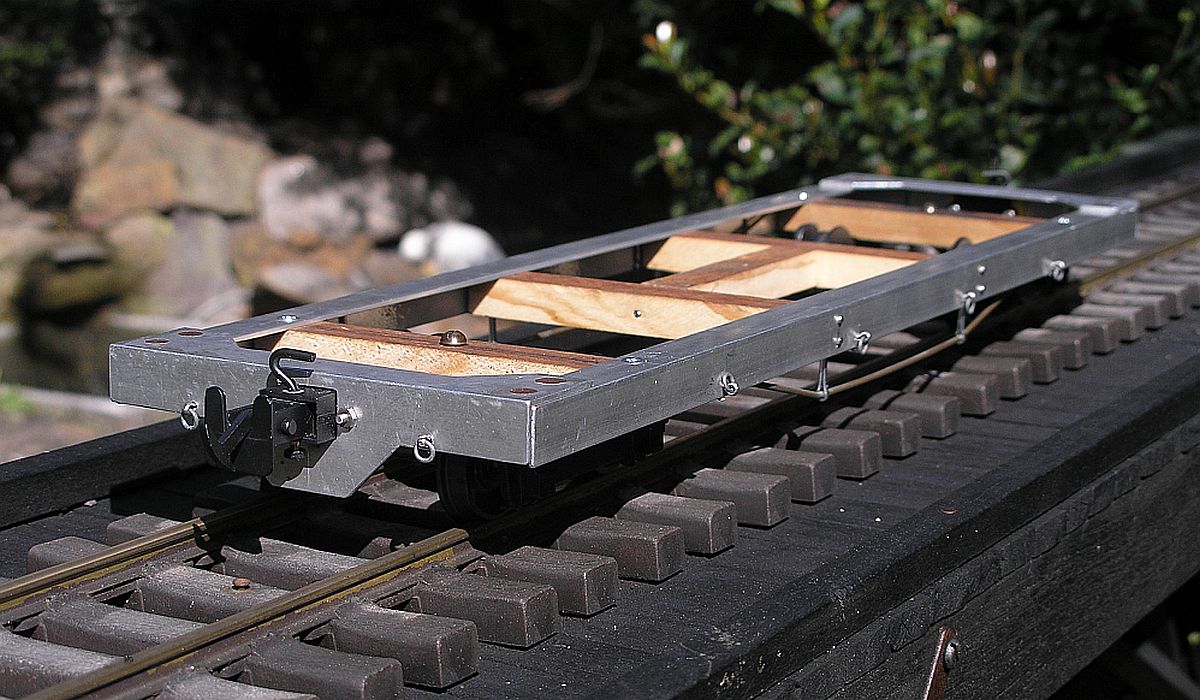

I think that's a wise move, our models suffer a little more hardship than the real thing. I wonder also if a deeper outer stringer would not allow so much of the ends of the bolsters and needles to show, the bolsters even having a chamfer for this. Just a thought.Bad Droid wrote: Thu Aug 22, 2024 10:15 pm so I'm going to make a fixture to router out the stringer profile to both the needles and bolsters.

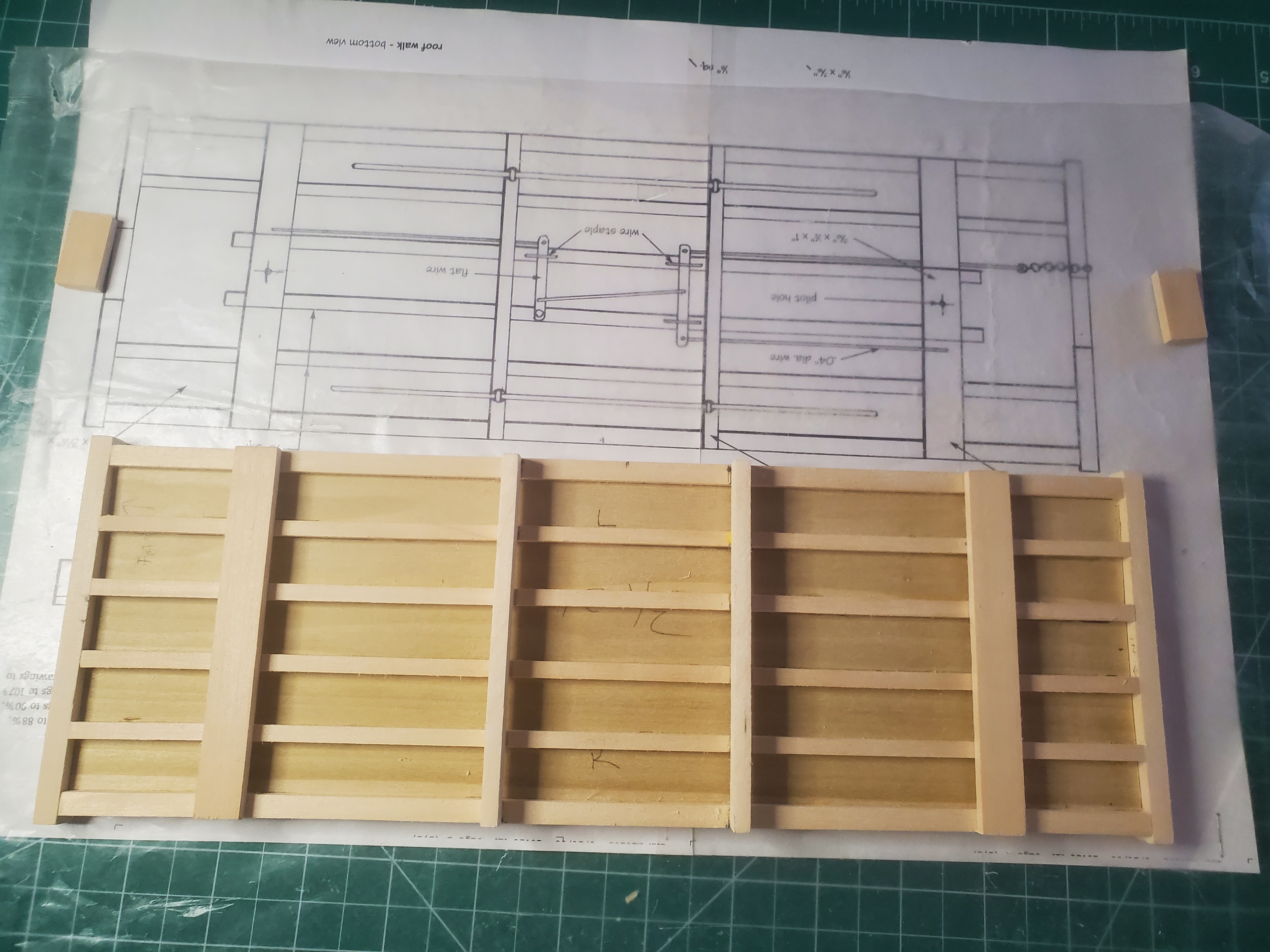

Good ideas. The outer stringers are 1/4" by 7/16". I started out with 1/4 by 1/2 and hand planed them down to correct dimensions. While I was doing that with my micro planes I was thinking; "What would it hurt to leave them @ 1/2"?. But anyway, I think I'll increase the height of the needles and bolsters by a 1/16", router them out along the stringers the same amount and that way they'll sit were they show in the drawings. OR, like you mentioned, taller stringers and less needle beams and bolsters. I'll play around with that. In fact, that would be easier... hmmm...LNR wrote: Fri Aug 23, 2024 12:51 amI think that's a wise move, our models suffer a little more hardship than the real thing. I wonder also if a deeper outer stringer would not allow so much of the ends of the bolsters and needles to show, the bolsters even having a chamfer for this. Just a thought.Bad Droid wrote: Thu Aug 22, 2024 10:15 pm so I'm going to make a fixture to router out the stringer profile to both the needles and bolsters.
After my run into town today I was able to get a few things done before our road trip. Nothing is glued down yet.
Definitly going to build a few jigs and fixtures to keep it all true once I settle on techniques and dimensions. Can't wait for a new camera...

Guess I should have looked at your plan more closely, I see where you are coming from. I'm modelling narrow gauge with separate queen posts for the under frame stays. Your beams are actually forming a queen post. I'm using 1/2" ally angle for my underframes, our bodies were always spaced up off the underframe showing a distinct gap and the rivetted end beams set the body up by 1/16th"
Yours are looking nice, they always do in the bare timber, sometimes it's a shame to paint them.
