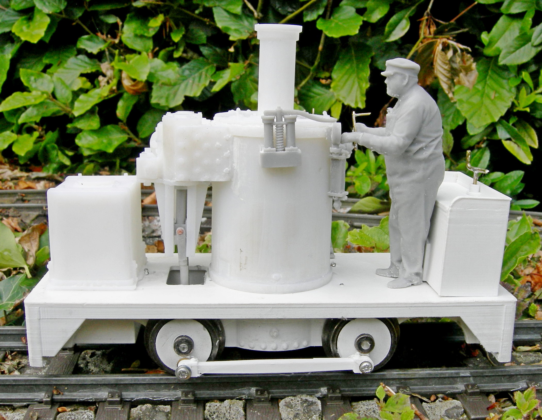

I can't remember if I uploaded some images of a de Winton (ish) loco which I downloaded from Thingiverse.....
I'd converted it from 32mm gauge to 45mm gauge and given it two cylinders v the one in the download, but I still wasn't happy with it. If you recall, I took a trip to Caernarfon to take a few snaps of a 3' gauge de Winton in the station foyer. Well, since then, I've been beavering away trying to replicate it in 15mm scale.
I think I'm on my eighth revision of the motion - what look good on paper doesn't always work in practice. But I kept the design of mechanism I used on the abandoned loco. I've even managed to squeeze in a MyLocoSound sound card (slightly cut-down).
This is very much the prototype and once I've finished wiring it up and test running it, I will start again to build the definitive version.

First test run this morning
It took a great deal of tweaking and tinkering to get it to work and to cram in the batteries (3 x 14500 (AA)), the receiver, the soundcard and the speaker. I had to enlarge the tank slightly to house the batteries and redesigned the 3D files as I went along - so now the much improved version 2 is in the process of being printed.

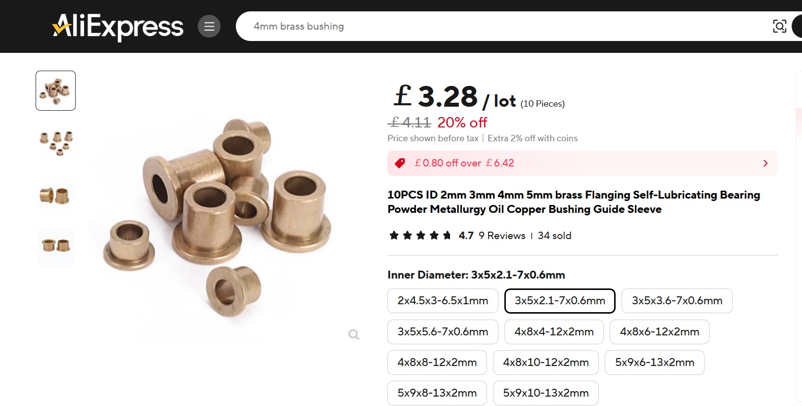

I got both 3mm bore and 4mm bore gears. The motor requires a 4mm bore and the axles were 3mm
AliExpress bearings.jpg (203.29 KiB) Viewed 112800 times
