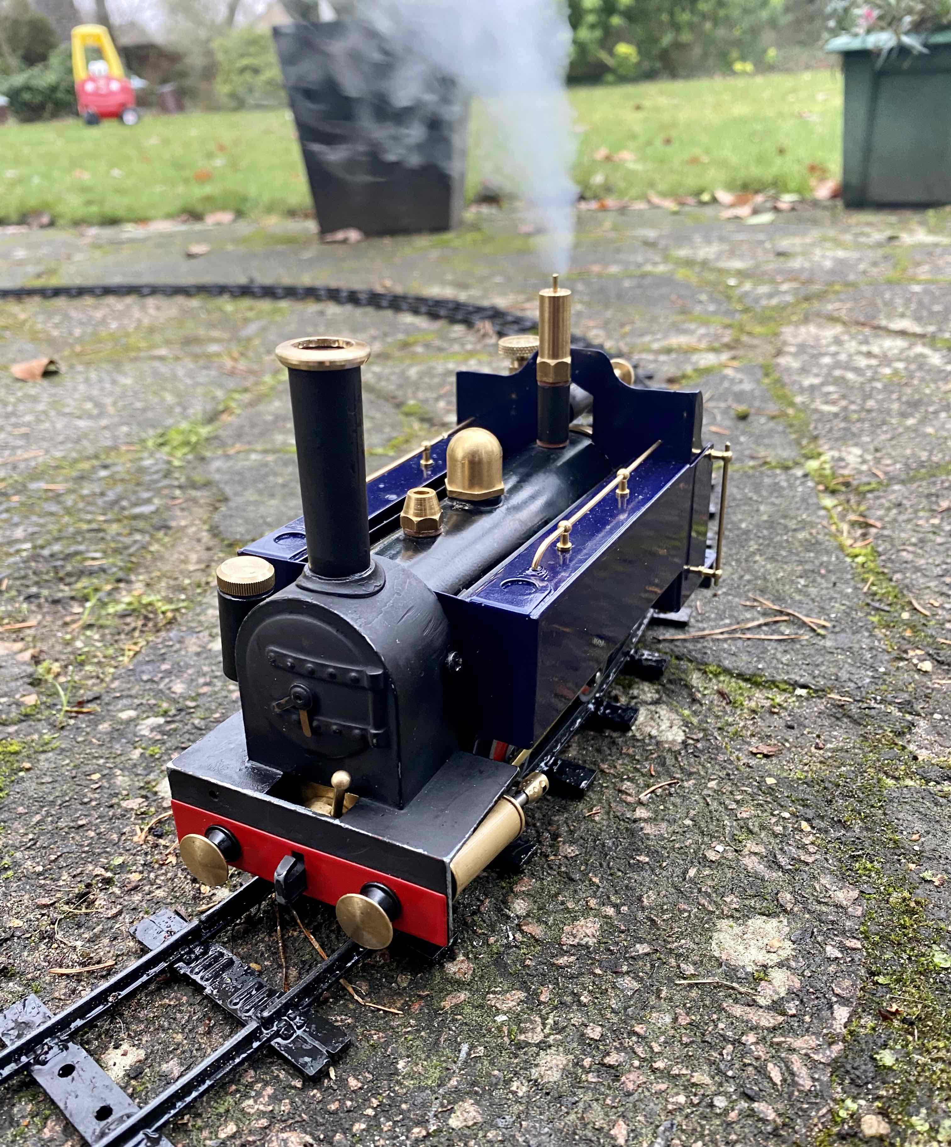

Having reassembled the loco over the last few days I had it out on the track this morning. I ended up swapping out the boiler after some inserts came loose. The current parts list:
* standard wheels and pistons
* RWM reverser
* Dream steam regulator, dead leg lubricator, high pressure safety valve & water top up valve
* Bix gas burner from Forest Classics
* Replacement MSS boiler
The paint job isn't perfect but for my first 'rescue' project I'm pretty happy with out it's turned out.
Here is a video I shot in slow-mo on my iPhone.
* RWM reverser
