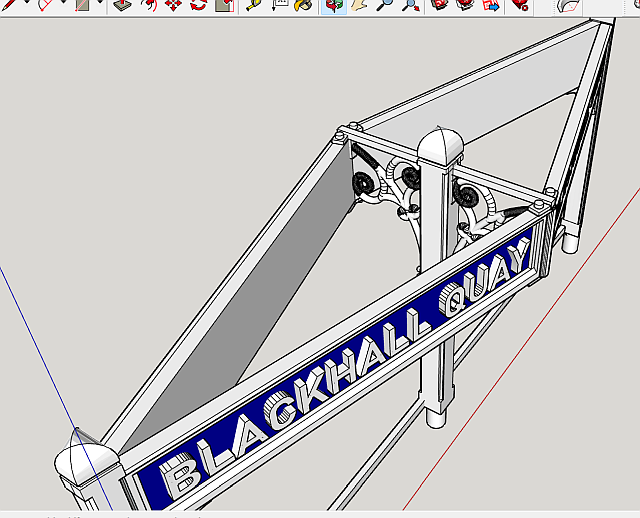

SketchUp drawing

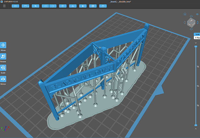

Chitubox image ready to slice

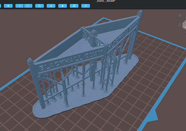

Chitubox sliced file with the bridging which has appeared from nowhere.

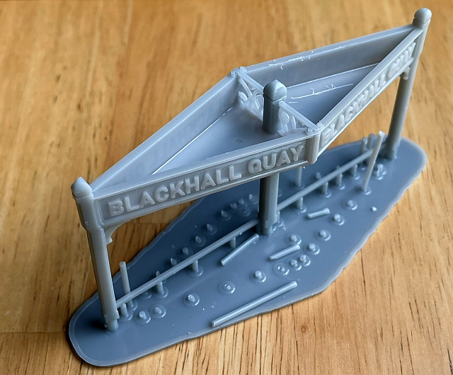

Printed with bridging and deformed end posts.

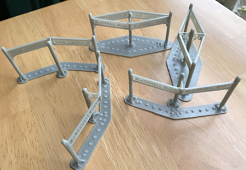

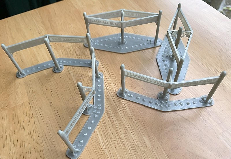

This is a picture of the finished items, which I'm happy with. Given that the signs are only 50mm high o/a, I'm particularly pleased with the way the fancy ironwork scroll brackets have come out.
