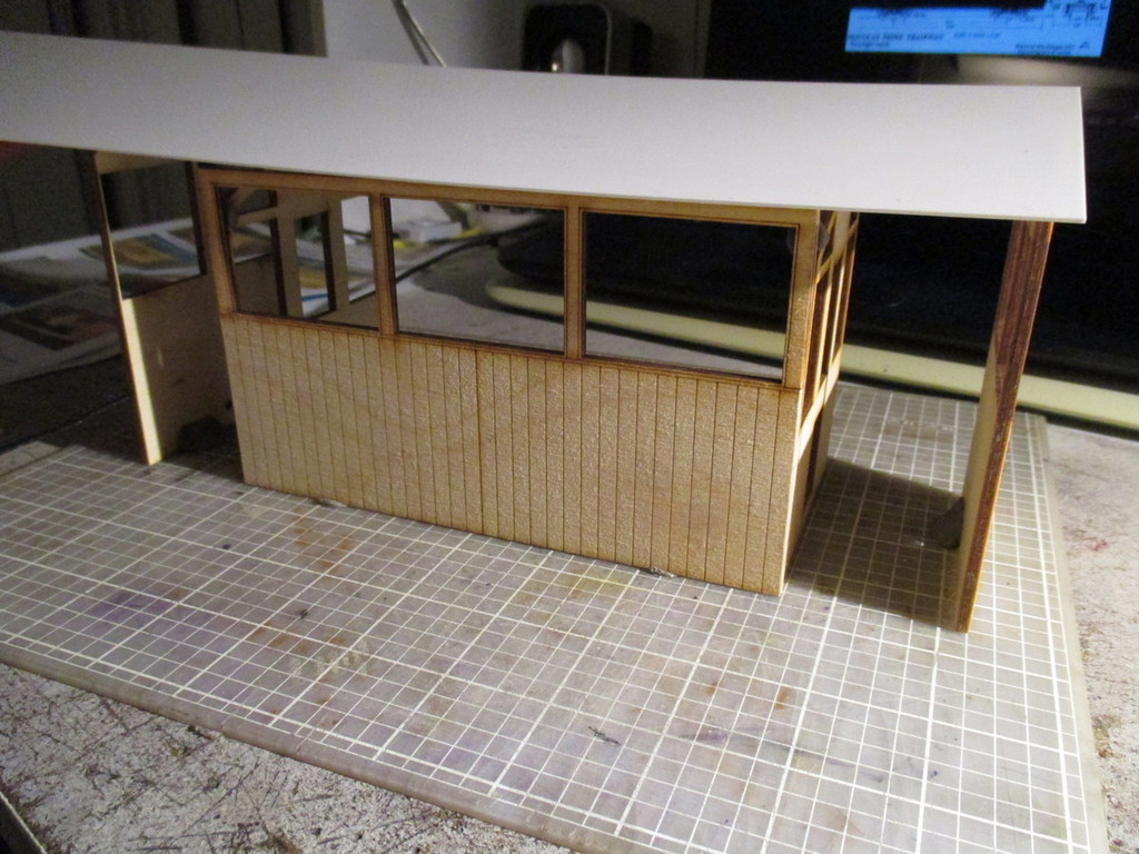

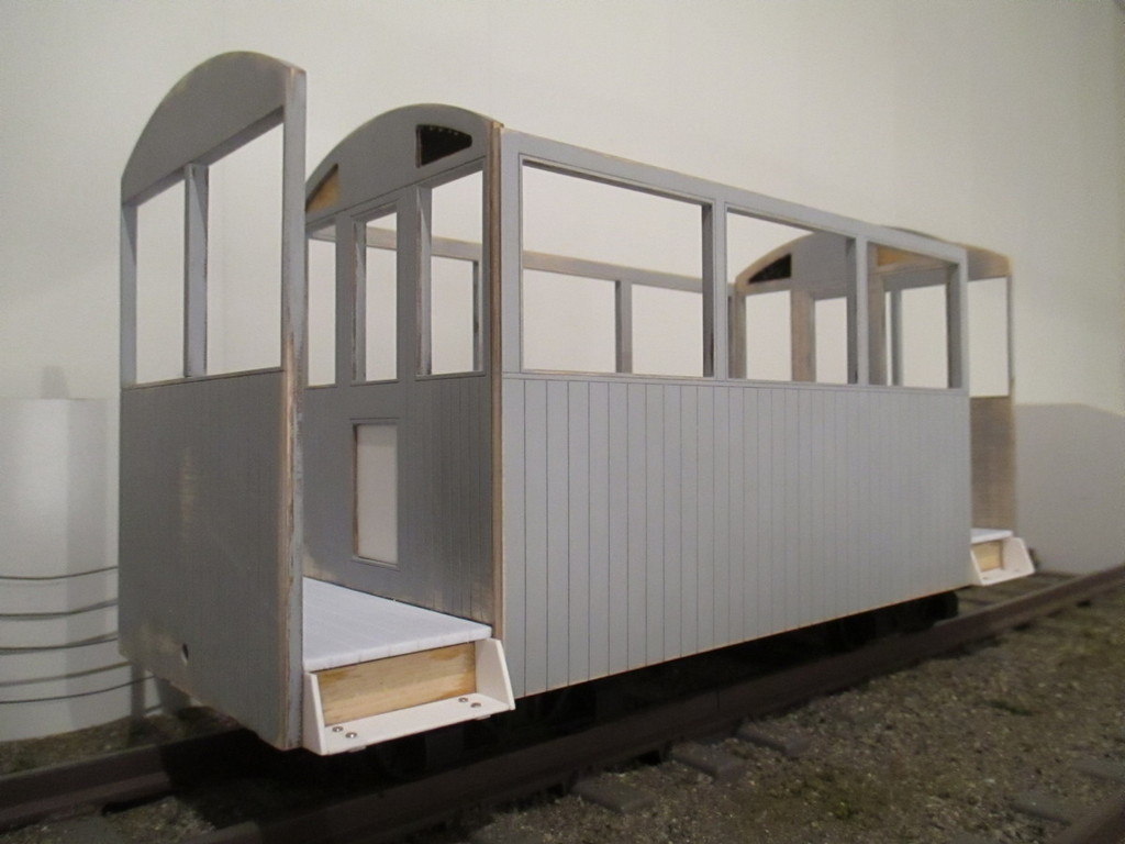

The open-sided ends were cut away, leaving only the glazed saloon.
23/01/19

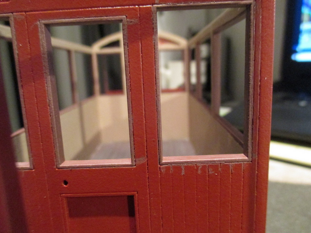

The end walls were scribed on both sides as needed, to match the side walls before filling the plywood's grain.
The grain was filled with spray putty. Each coat was sanded, the dust brushed away, then re-cut the scribed lines with a knife because the filler obscures them.
Very laborious. I prefer MDF over ply - it doesn't have a coarse, often wrong-way grain to fill, and I can't say I've ever had it warp.
For the latter reason, a replacement floor was made from 3mm foamboard.

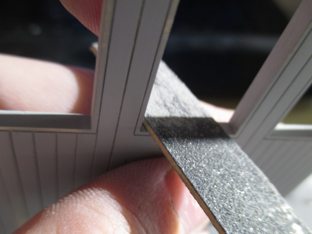

Emery boards (nail files from the cheap shop) are great for smoothing out window openings.

The kit's solebars were cut down to suit the shortened frame. The wagon here is mocked up with blu-tac, and sits on temp. bogeys.

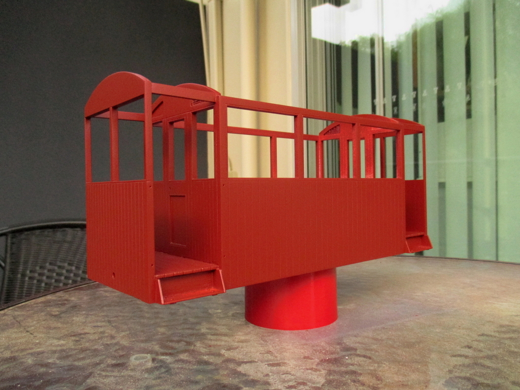

After a light base-coat of white, followed by red oxide primer, I dug out an aerosol can of Tamiya's TS-33 Dull Red.
A satin clearcoat gave the appearance of a more recent addition to the wagon roster, as opposed to the flat finish of the older coaches I had at the time.

Again to match the existing stock, the window frames were painted brown. To save some tedium, Tamiya 3mm wide tape (the repackaged strips of electrical tape for masking curves) was used to mask off. That stuff is too thick to burnish down properly at the corners, and I should've bought the 3mm wide version of their excellent 10mm paper masking tape I had on hand. Much retouching ensued...

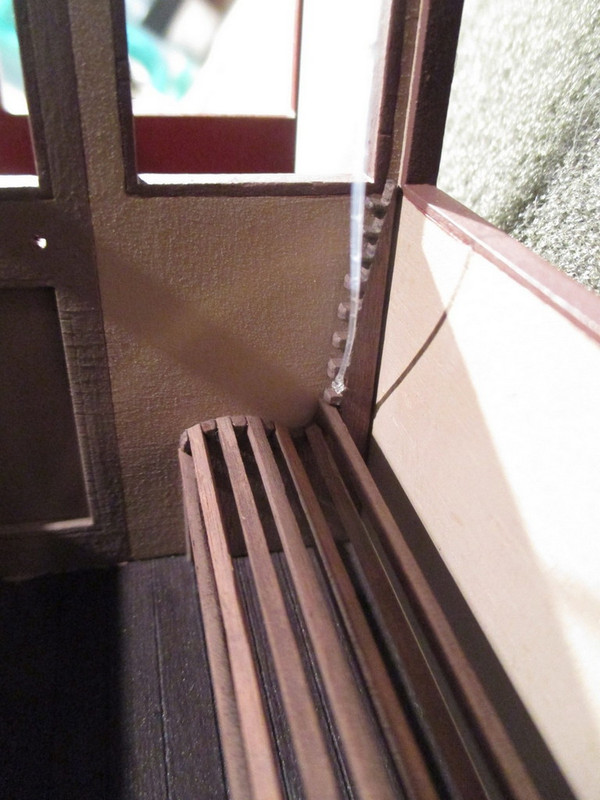

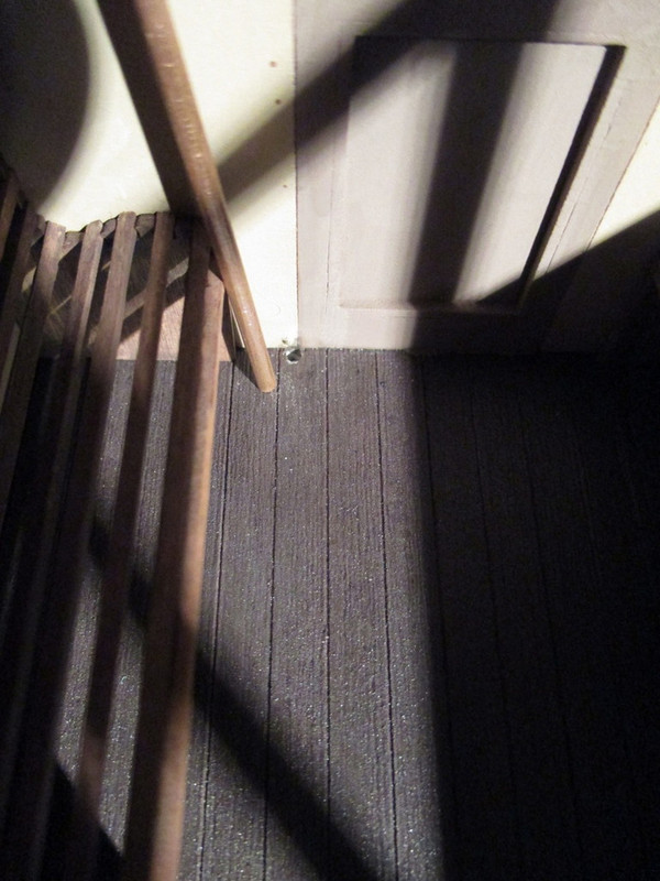

A fine-tip superglue applicator made a nice job of fitting the delicate but beautiful seat slats.

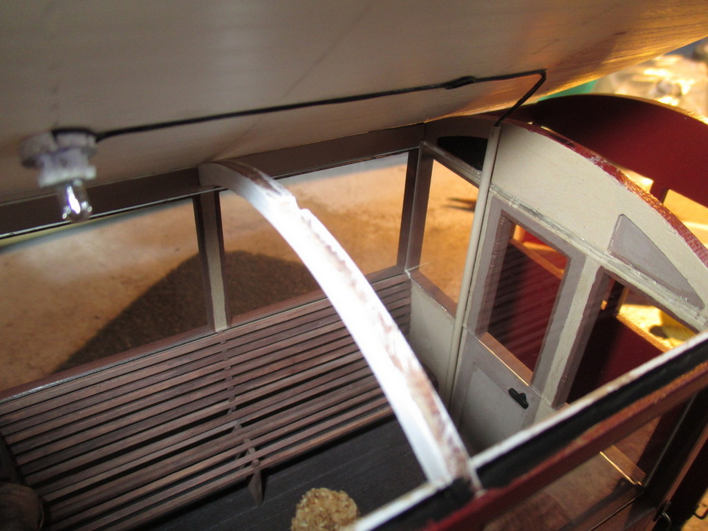

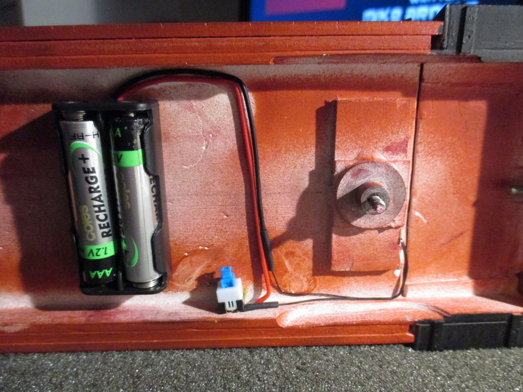

Night excursions became popular in the 1920s, so interior lighting is a must. A pair of AAA cells will go under the floor. Some tube from the scrap box makes an ideal conduit.

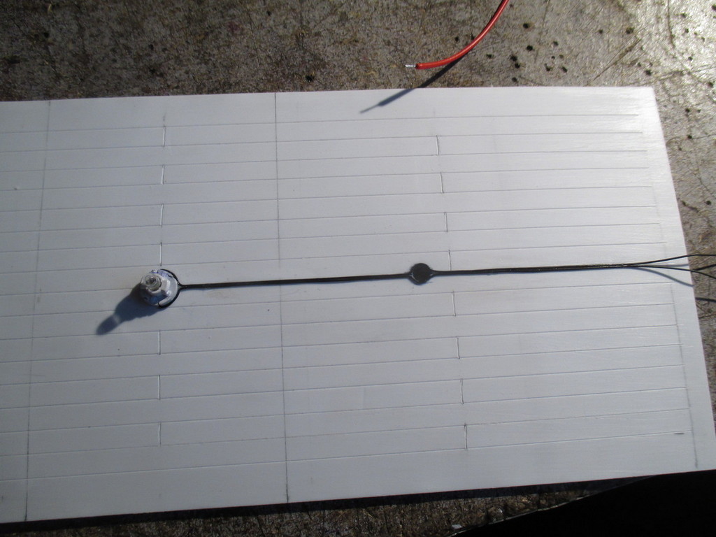

The 1mm styrene sheet from the kit was cut to length, and scribed as needed.
A bulb mount (I believe salvaged from a car instrument panel many yeas ago) was fitted with a 3V bulb.
Superglue and a ruler made for a tidy visible wiring run, though I did get carried away - the wires need only go little further than the vent hole in the roof.
They lifted away cleanly with a razor blade.

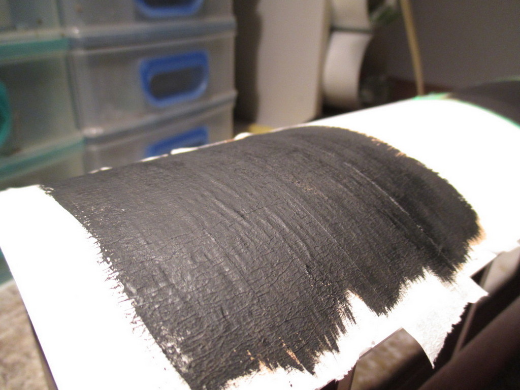

For a finer-scale canvas roof effect, I thought I'd try covering the roof with strips of masking tape. It wrinkled very badly when test painted with acrylics.
This would be perfect for a decrepit wagon, but not a carriage in good nick.
I found the low-tack variety to be much smoother and less wrinkle-happy when painted, so I proceeded with that.

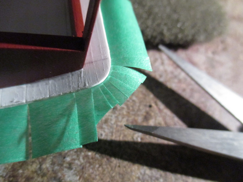

25/01/20
After wiping the rooftop with alcohol, the alignment for the first strip of tape was marked out. As the tape was laid down, a pencil eraser was used to smooth the tape into the roof, and push out any trapped air. Curving the corners made things more complicated, though still doable. A little superglue was needed under here to keep the low-tack tape stuck. After burnishing down, the excess was carefully trimmed away with a fresh razor blade.
Three coats of black (using enamel this time prevented wrinkling) to block the interior light from bleeding through, was followed by a pair of Brandbright ventilators.

My wiring isn't as nice as I'd like, but it'll work. The batteries and their holder were brushed flat black, along with the steel hand-rails. Bogeys refitted and the bearings oiled.

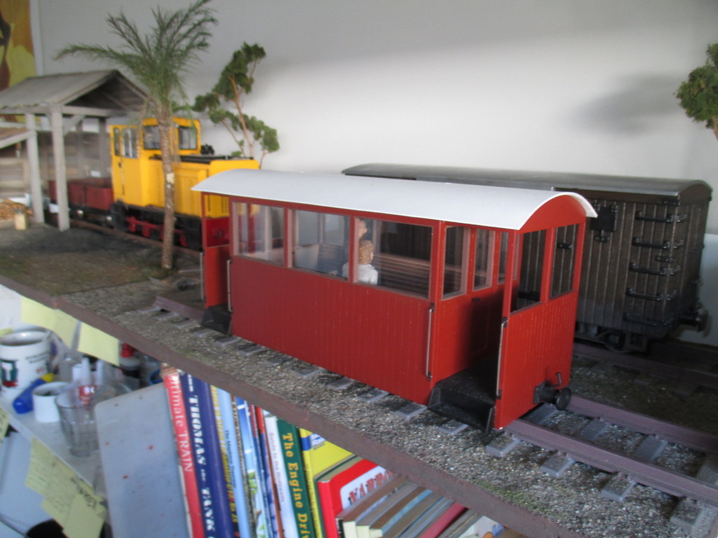

After entering the coach into the loco/wagon records, I can call this one finished.
It's only taken me fifteen months to complete. :lol:
Goes well with the existing pair of IP VOR coaches, though different enough to be interesting.

During its' conversion to 32mm gauge, the ride height was dropped by removing some of the packing above the bogey pivots. I really like how low-slung it looks now.
