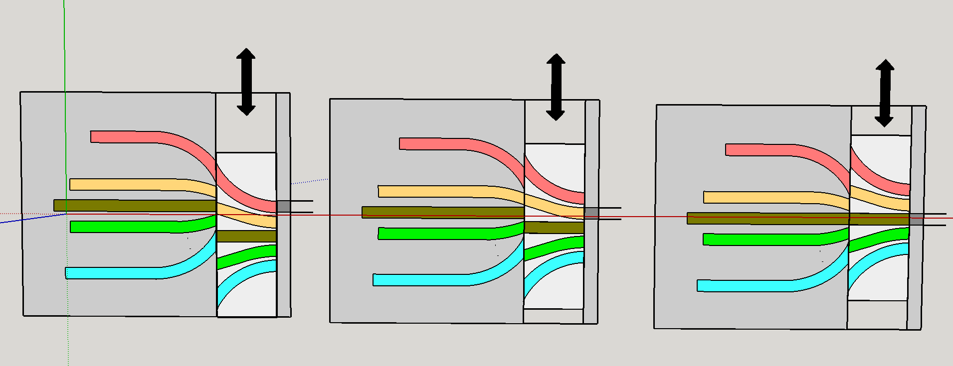

On the subect of pointwork, this is crying out to use a system we had in the fiddle yard of a 00 exhibition layout about 40-odd years ago! The 5 FY sidings themselves were straight and parallel but curved inwards towards the approach and then there was a sliding traverser. The exit was straight but the traverser had 5 pieces of track on it, individually curved to join each siding to the straight exit road. Saves masses of length and a huge amount of cost. All it needs is a couple of lengths of ali angle as runners and a couple of lengths of flexitrack cut as appropriate. If you want any more info, let me know and I'll do a sketch.
I would be interested in a sketch and any other info that you could provide please.
Graeme, Hopefully this sketch will show what I was trying to describe. The white area with the curved tracks is a traverser simply manually sliding on aluminium angle screwed to the faces of the board either side. The geometry would need to be worked out to get curves etc to work without fouling or being too sharp. This concept worked perfectly for years on the exhibition circuit on a 00 layout.
If you ( or anyone) want to continue this topic, I'm happy to do so but I'll split it into a seperate thread to avoid hijacking this one any further. "Video's" isn't exactly the right place! :oops:

Clever idea! :thumbup:
