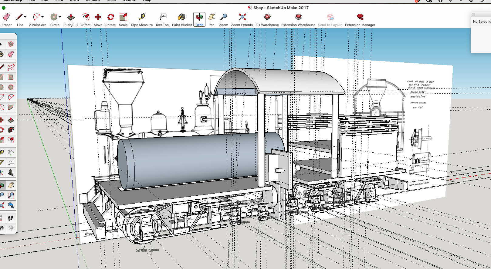

I have also thought about making a Shay.
In fact it was something I thought about making next - to follow on from the three D printed 4420. I was thinking that it would be a appropriate for a 3 D printed live steam model. I have drawn it up in Sketchup - and it is near enough ready to print. It is based on the plan from Colin Binnie's archive. If you are interested you can have the files to play with:
As far as flexible joints are concerned it wouldn't be difficult to make the Harley splicer type couplings, and they might even work if resin printed. I was going to try that. Don't forget that each shaft also needs to change its length, I was planning on rod with a wire passed through it and a tube with a slot to slide over that rod. again I think the tube with slot could be printed. Well that is what I thought to try first.

Hi
I also use the free software. "Sketchup Make 2017" is the version I use and it it still to be found on the internet.
To answer can I seperate the components into separate stl files? Yes. I create the drawings as a single file for the whole model, and create each component separately within that file. Each part is saved in the software as a "Component". That stops them being altered when you alter something else. You can also go back and alter each component - and only see the component you are changing while you edit it. Then all the components can be seen as a whole - just like an assembly drawing. That helps to make sure they fit together properly.
I will prepare the stl files and put them in the files section. Just be aware that it isn't quite ready to print - but I will get it ready to share. It might take a couple of days!
PS It took me a while to get used to sketchup - but it is really powerful - and it does everything I want it to do. You can move the sidebar, and there is another sidebar which has more functions which you can turn on and off.
Last edited by Trevor Thompson on Thu Nov 16, 2023 10:27 am, edited 1 time in total.
