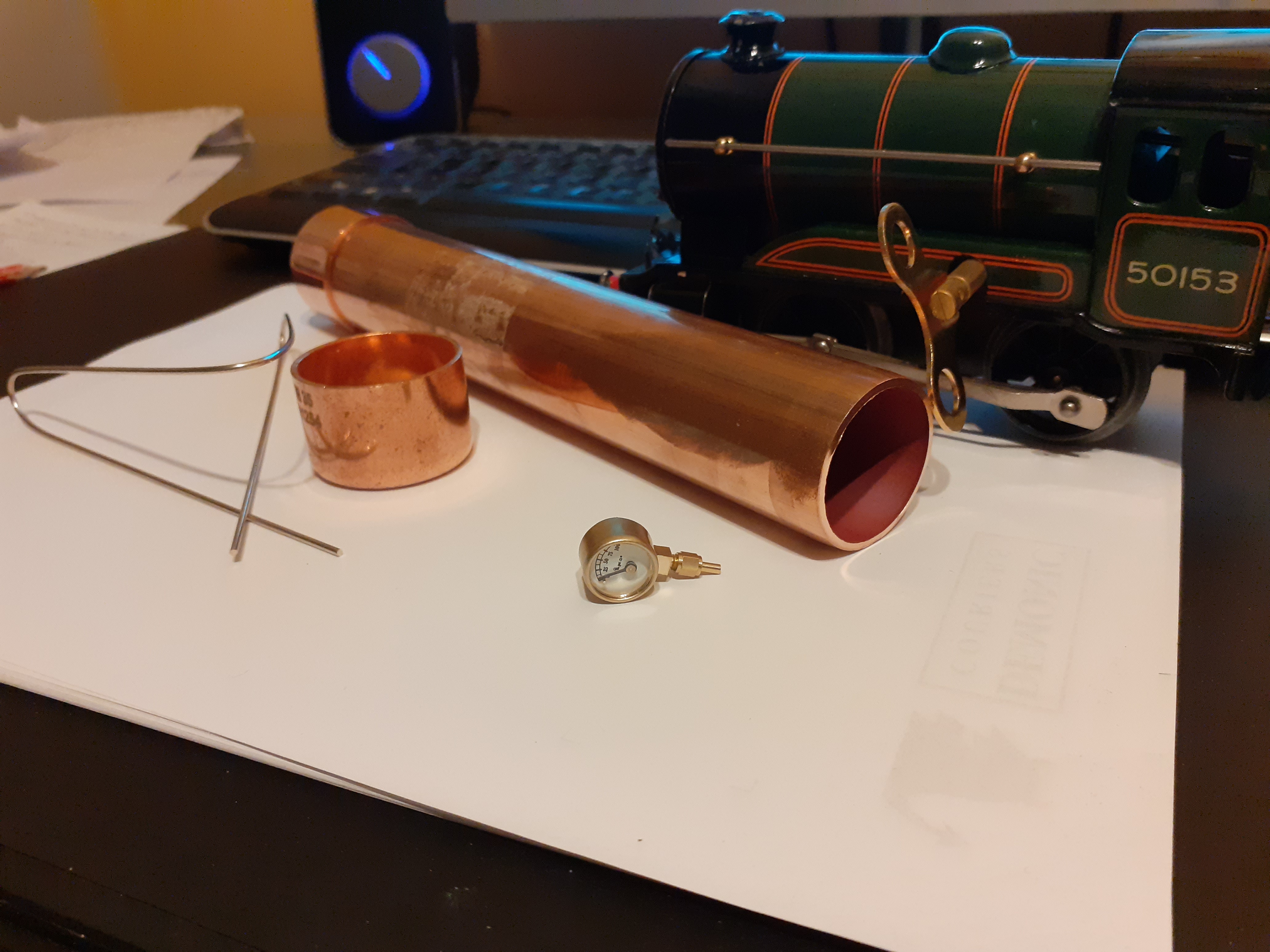

I'm starting to gather the parts and materials I'll need for this project - enough 35mm copper pipe for two boilers, the end caps and a dear little 1/2" steam pressure gauge from Maccmodels (dear on two levels!)
Now that I have a key I can confirm that the clockwork motor doesn't work - feels as though the spring has broken from the winding rod - I'll take it apart and fix it in case I can't get steam to work with it and want to revert to standard.
If someone could advise me on a suitable gauge of brass plate for the chassis I'd appreciate it?
