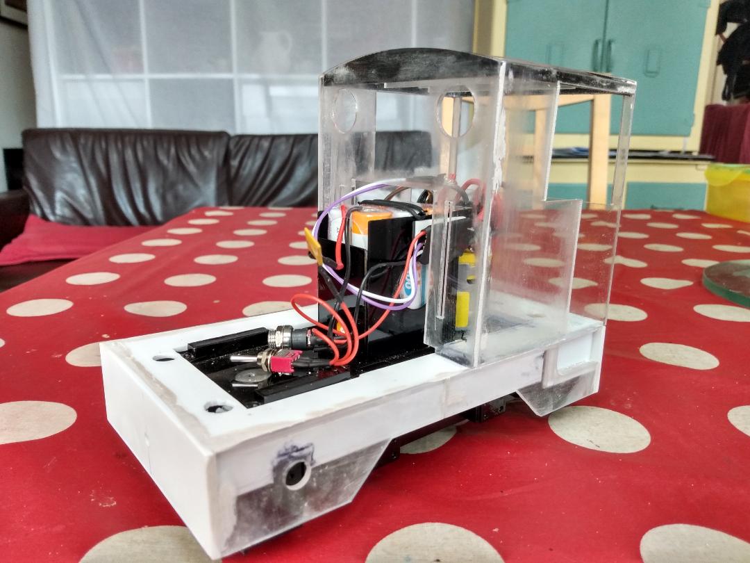

The cab's now on too, still some filling and sanding to do though. The Plastic Weld recommended over on Phil's railway thread is great stuff, the whole thing seems really strong and rigid. I ought to have said too that the kit is great, really well designed and all the parts seem to fit together nicely, I'd definitely recommend. It's only because I'm messing around with it (essentially shortening it by around 6cm and modifying to fit a RH chassis) that I'm running into problems!

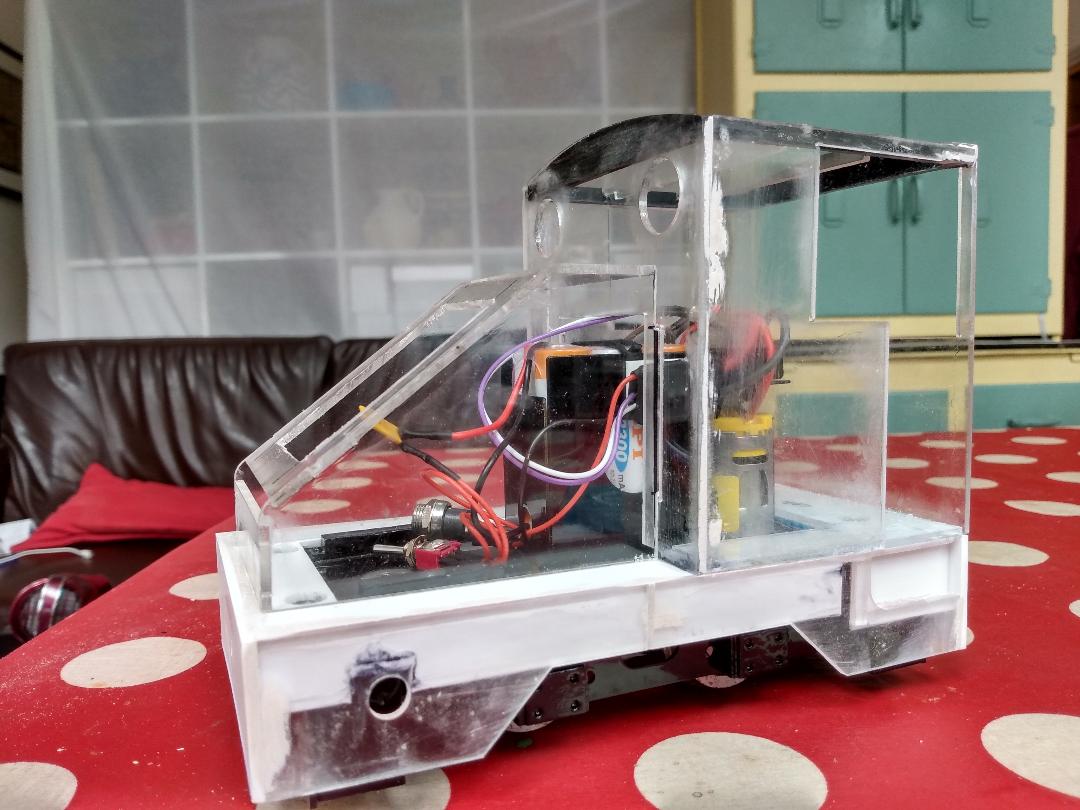

Here's the cab in place...
The roof trusses are only resting there temporarily for now while I work out what to do inside the cab. The radiator will have to be further back than the original (and central too, rather than offset), so it'll be harder to hide the fact that there's not a great big engine behind it. Or in front of it, I suppose, given that the radiator's at the back. Modelling the louvred shutters in the closed position should help...

Afternoon!
Just a little more progress to report, with the construction of the bonnet this morning. A sheet of plasticard will actually cover the whole front/top, but I liked it that you could still see inside, so I took the photo before it was finished:
Once the bonnet's complete I'll attach it to the rest of the body, fill and sand as necessary and then pause for a think. I want to get a coat of primer on so I can see where further work's required, but first I need to consider how the cab detail's going to work...
Still a long way to go, but I like the shape that's emerging...

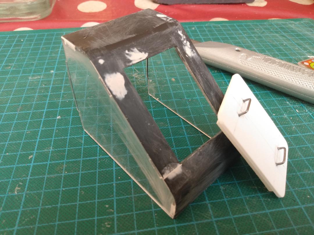

It took some doing, but I think I've got the front of the bonnet sorted. I won't really know until I prime it, but I hope it's going to look OK...
On the original, the hatch seems to have given access to the gearbox (replaced by an additional door in the side on the Sudanese version?), but on the model it will allow me to get to the on/off switch and charging socket.
Radiator and engine cover next, I think, but only when I'm back from a holiday...
